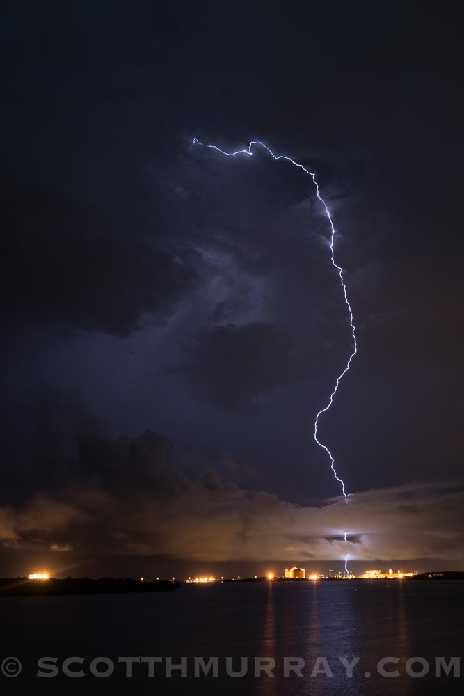

I have pics with light pollution that works ;)
For example this single lightning bolt works great with the city lights. ( Using lightning trigger)

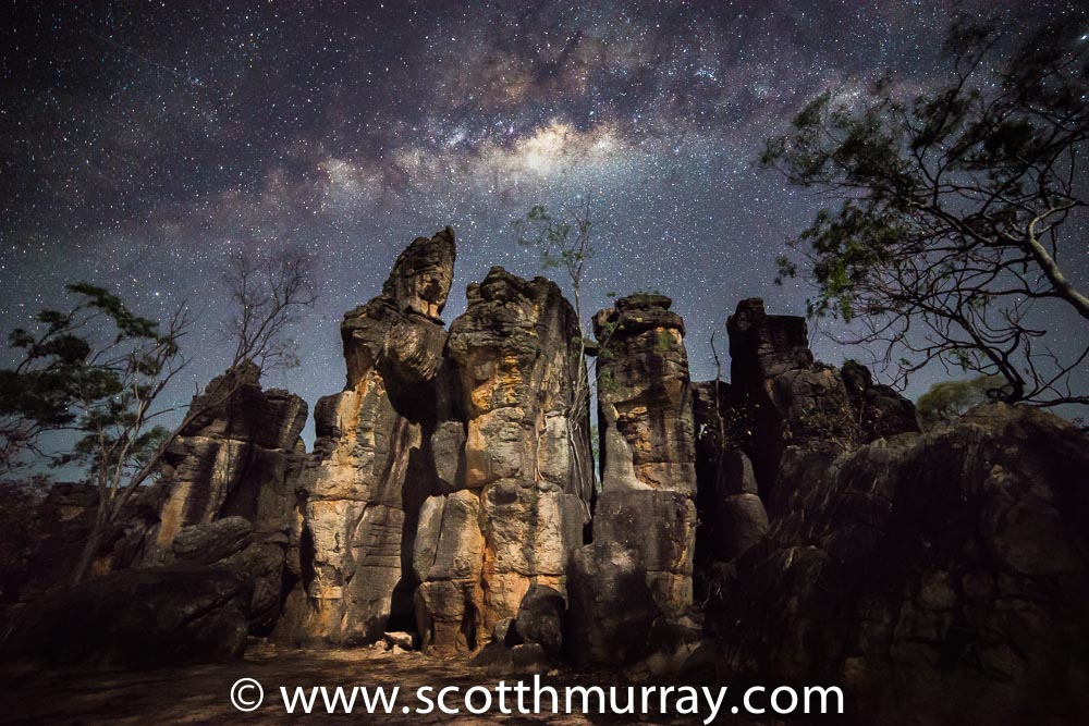

[MENTION=9753]Scott Murray[/MENTION] what setting suggestions and focal length suggestions do you have for milky way shots/low light? I haven't tried any and don't know where to start. My main lenses are listed in my signature. Thanks for any advice. :)
Scott Murray
@Scott Murray what setting suggestions and focal length suggestions do you have for milky way shots/low light? I haven't tried any and don't know where to start. My main lenses are listed in my signature. Thanks for any advice. :)

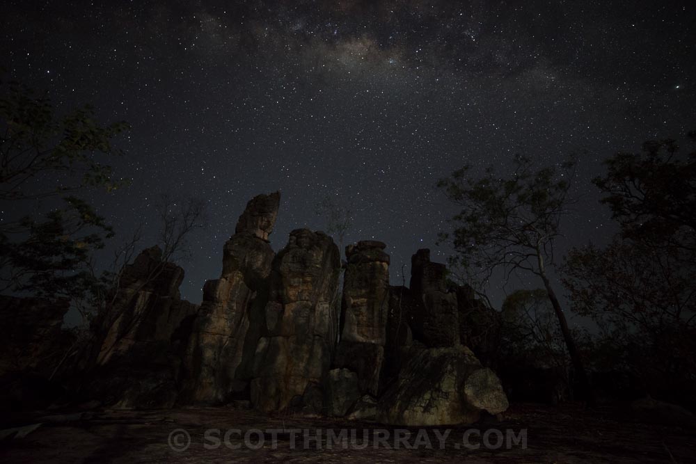

I would suggest.
D610, ISO 3200 (30% moon, no light polution), F2.8, 20 sec (any longer and you get noticeable star movement with FX)
Un-edited file. ISO 4000
ISO 3200 un-edited
Edited 3200 ISO
I hope that helps :)

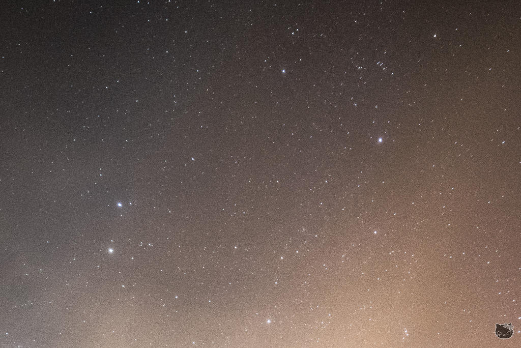

Here; two shots ISO 100 and 6400, the 100 overexposed 3 stops and the 6400 underexposed 3 in post to bring them both to the same exposure. The 6400 should make the sensor much more sensitive if that would be true which logically should result into a better shot showing a lot more stars than the ISO 100. And it is ETTR as prescribed to get the better quality.
If ISO only affect the read-out, 100 should be the better shot and contain as many stars as the 6400.

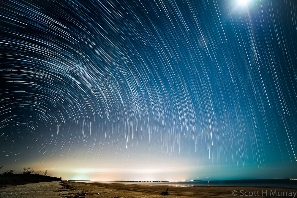

Speaking of which, the best time to do star trails is during a full moon as normally you cannot photograph the milkyway. As you can see the moon was coming into frame at the last shot.

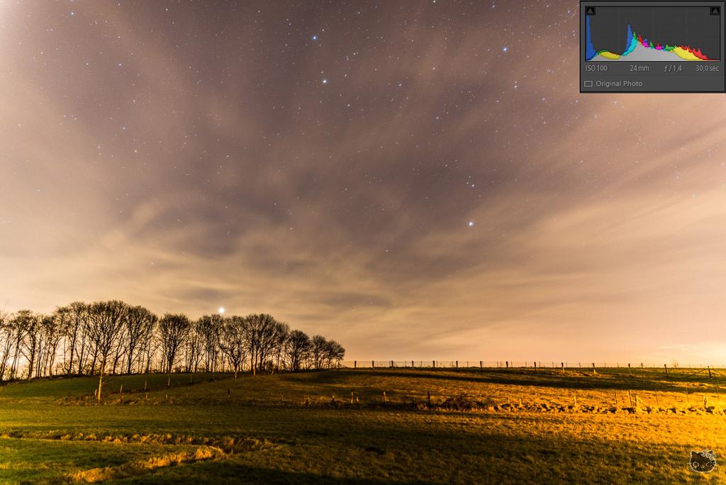

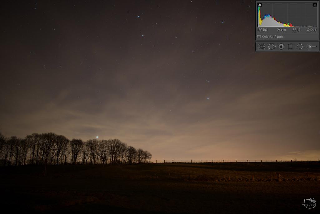

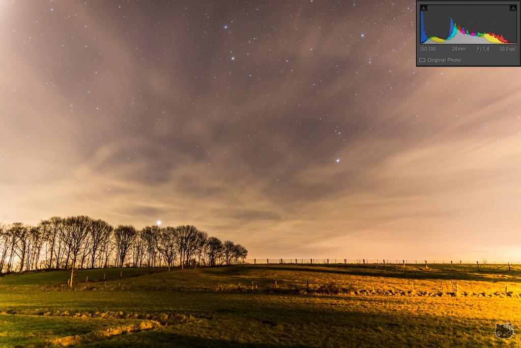

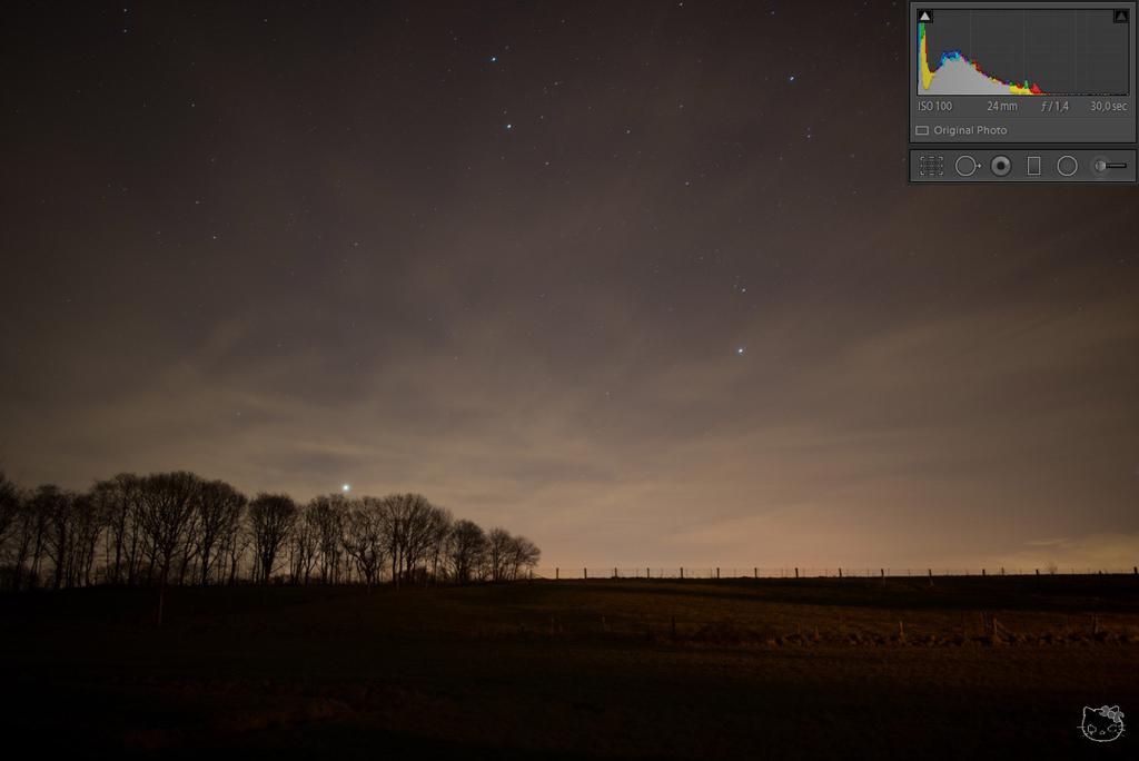

Here's another I shot some days ago using different ISO to blend but it can serve as an example.
I shot one at ISO 100 for 30 seconds fully open to get as much light in as possible ignoring the star blur that caused. With those settings it is underexposed.
The other I shot at a faster shutter to avoid star trails, I closed down 2/3th of a stop but increased ISO to 3200. It is as much exposed to the right as was possible without clipping more than needed.
Here are both after processing them to a rather similar version. The one increasing exposure while the decreasing the other.
In terms of quality that's the worst and best approach in regards to noise and other imperfections.
Now let's look at a 100% detail of both shots. They both still have noise; when light is low photon shot noise is very visible. ISO 100 does not magically make that disappear.
While the 3200 shot has a lot of stops more exposure than the 100 in the RAW it captured, when it comes to true sensor exposure, it is the 100 ISO that had more exposure to the light. That's why even when both are fairly similar when processed, it is the better of both shots in regards to noise. 3200 only made its sensor exposure disadvantage worse.
And then there's a severe loss in DR too.

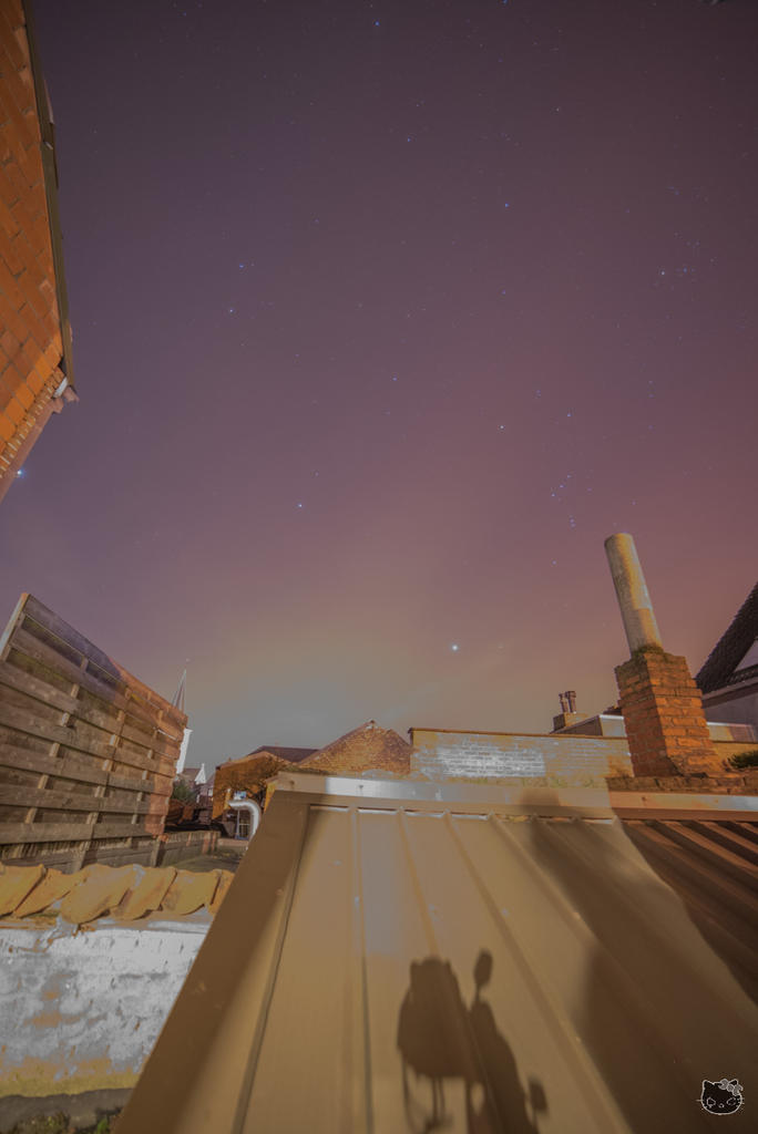

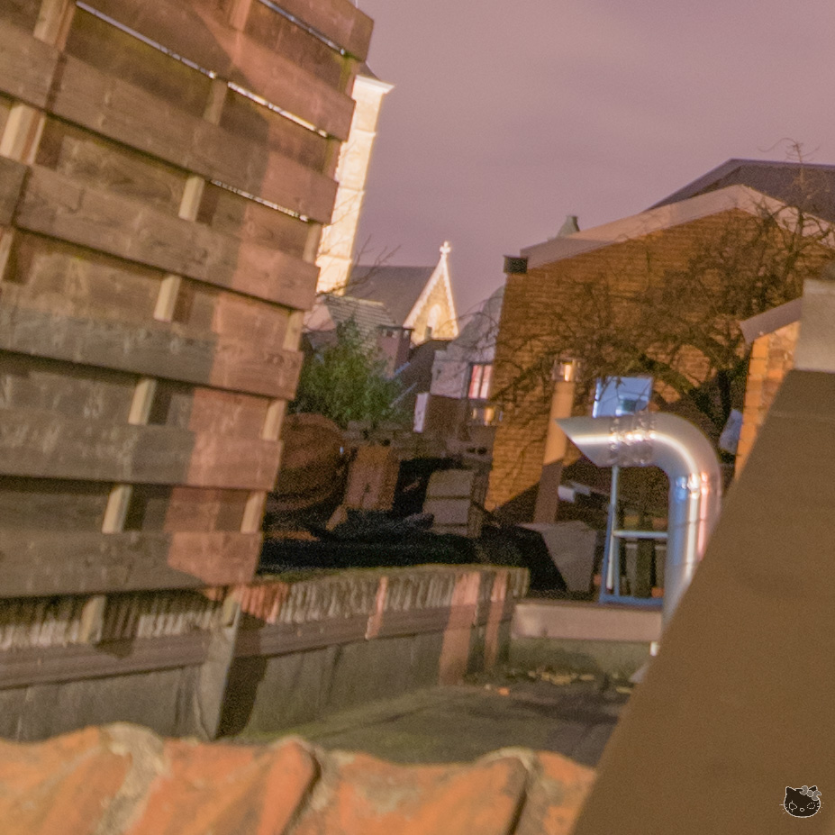

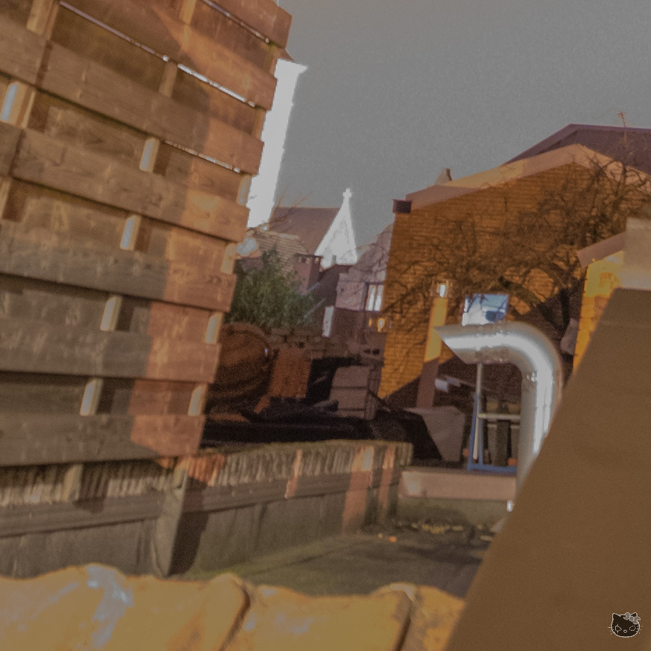

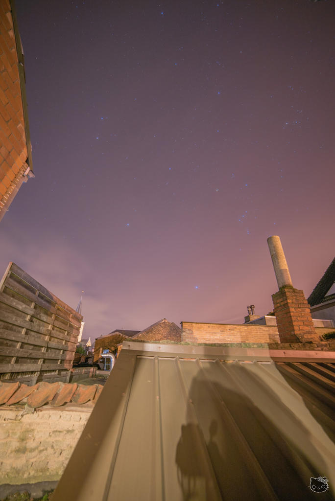

Here are two identical shots when it comes to sensor exposure. They only differ in shot exposure because of ISO.
In post I increased the exposure by 3 stops for the 100 while lowering by 3 for the 6400. After that, they're exposed equally in terms of shot exposure and sensor exposure. Then I killed the shadows (+100) and highlights (-100) and set the black and white at the lowest opposite. (+100 black, -100 white).
Look at the 100%.
Of course I can process them in such a manner the differences will be less noticeable but never until they're identical.
Here is another area which shows the exact gain and loss between low and high ISO. This is almost black in the normal shot but I killed black/white shadows and darkness to show what is not there compared to the others.
As you can see, low ISO I pay a price in the darker regions while with high ISO I pay a price in the light one. For these shots the loss in the brighter parts is much worse than the shadows.
