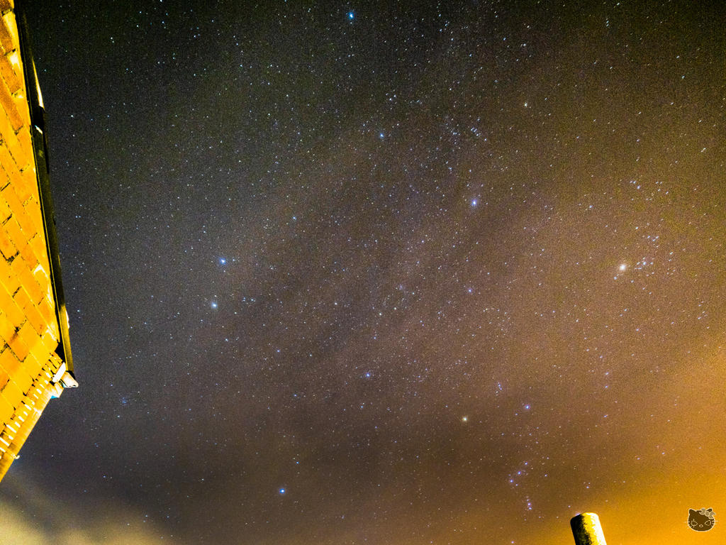

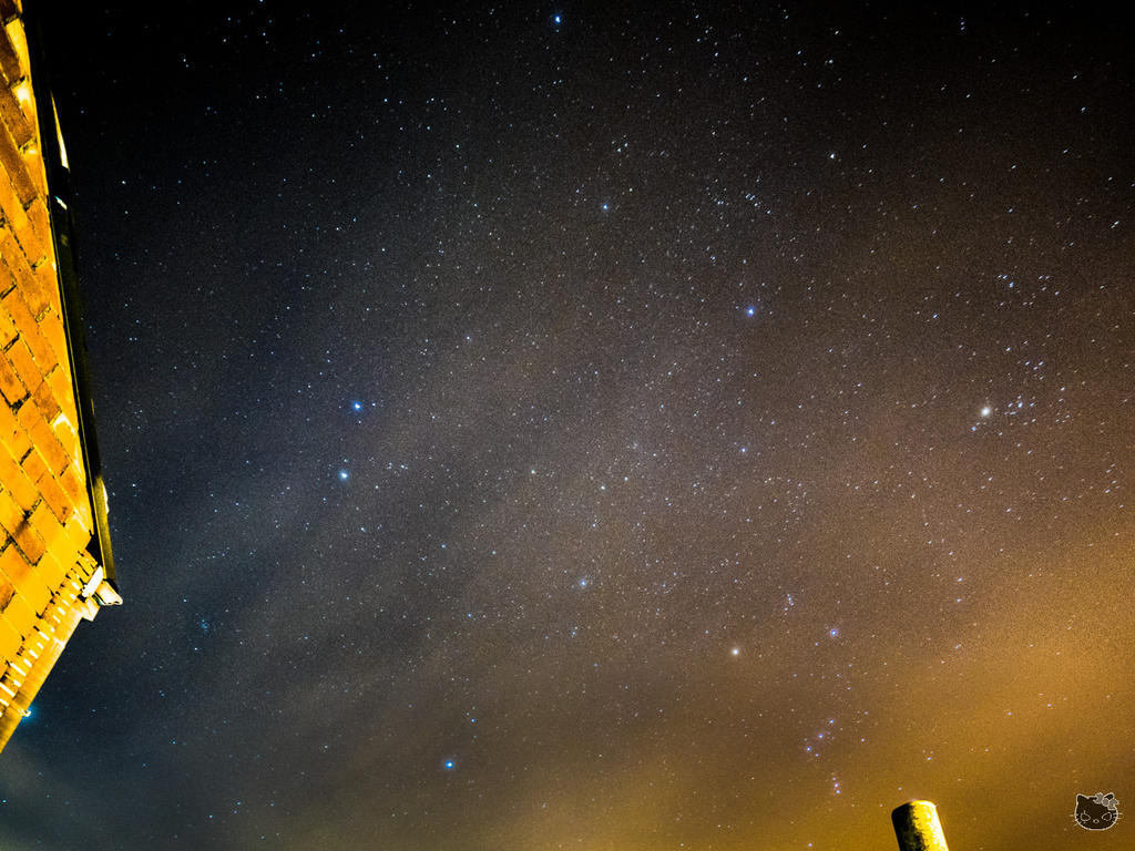

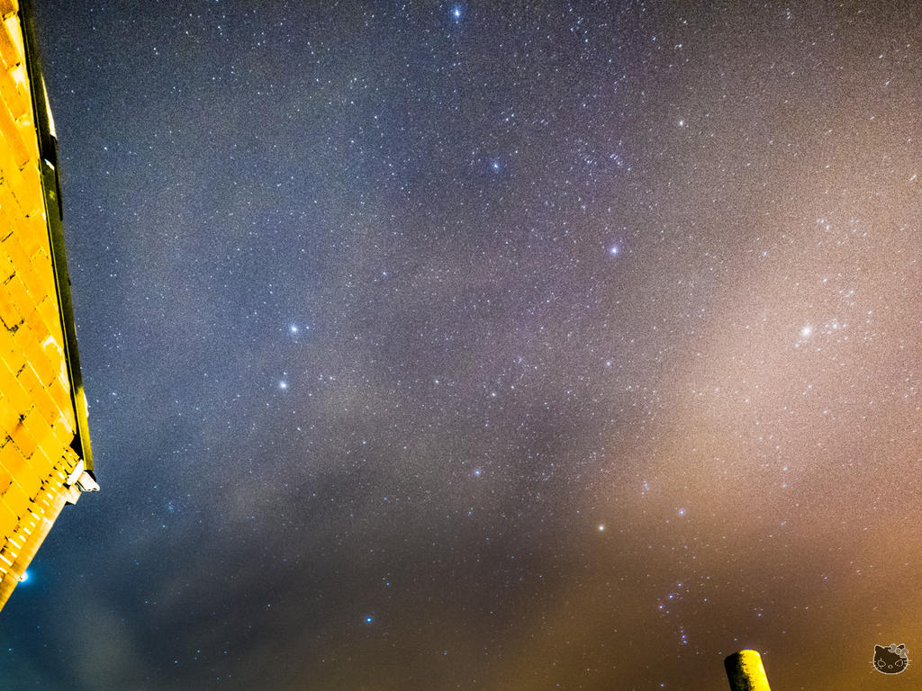

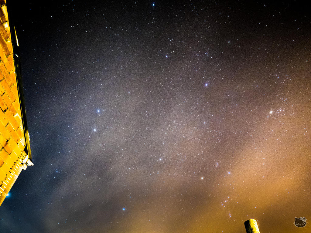

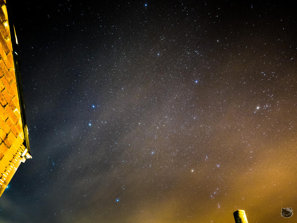

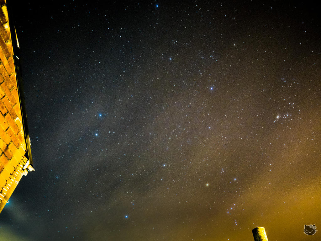

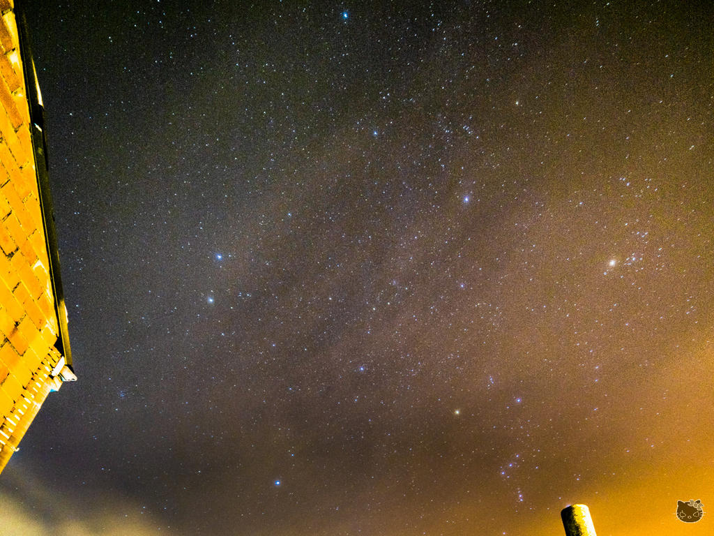

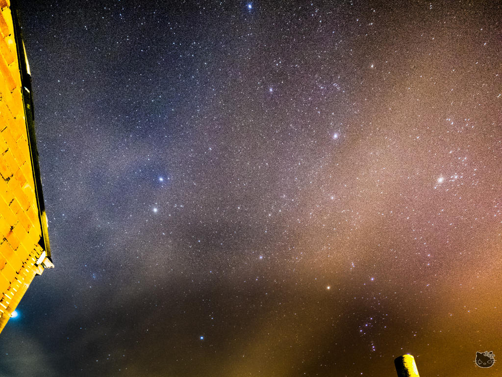

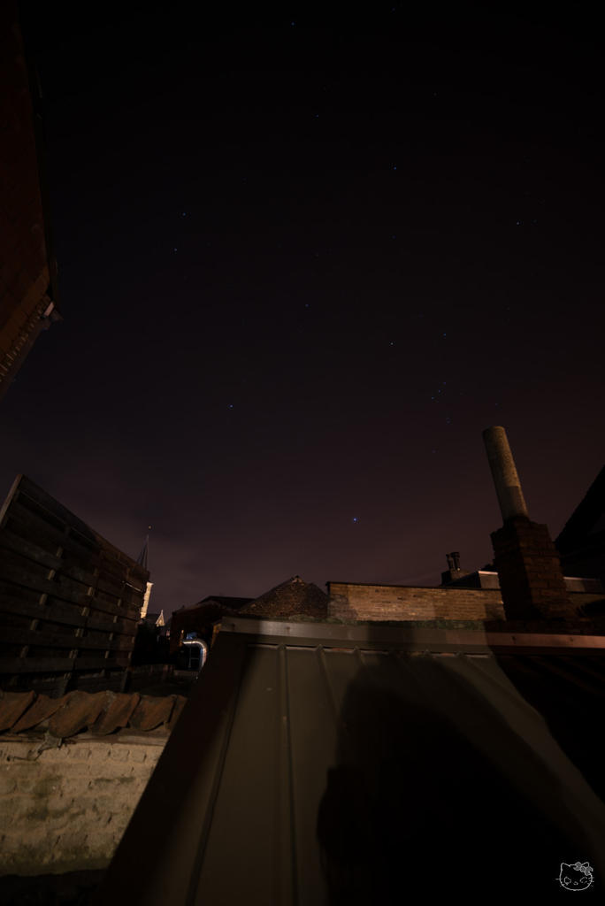

I tested the information I read about ISO being a post-sensor process. It implies that no matter what the ISO setting, the sensor does not count more or less photons. That means that unless there is clipping, I should be able to grab as many stars using ISO 100 as I do at ISO 6400. All that ISO does is increase noise and saturated pixels.
I shot the 100 through 6400 range at 20 min and then processed those solely to check the differences in the sky. The higher the ISO, the more issues I had with the present pollution.
Here's the series:
Even when some stars are brighter at higher ISO, that as easily can be accomplished by blending the same shot. All that ISO seems to add (for my cam) is noise and haze.
The best for my cam is to open up as wide as possible and shoot the longest shutter possible at ISO 100. The rest is best done in post since there the noise is not multiplied.

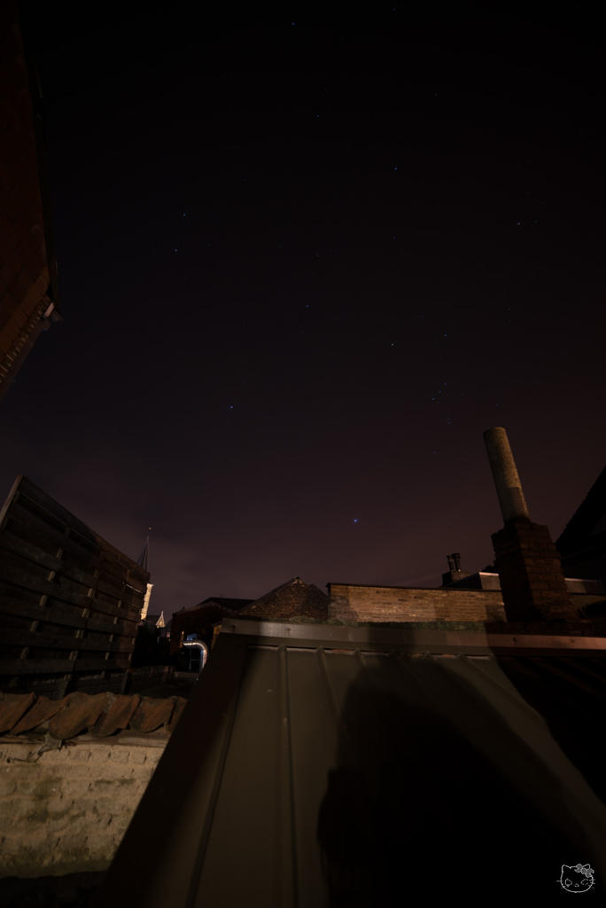

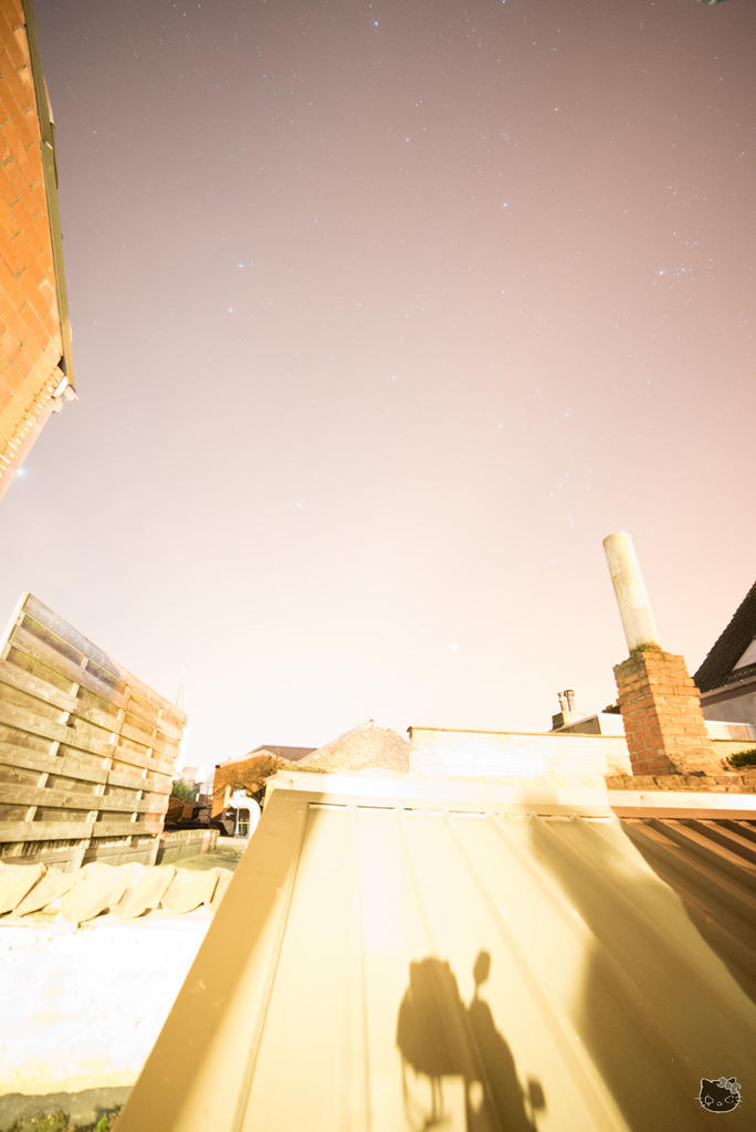

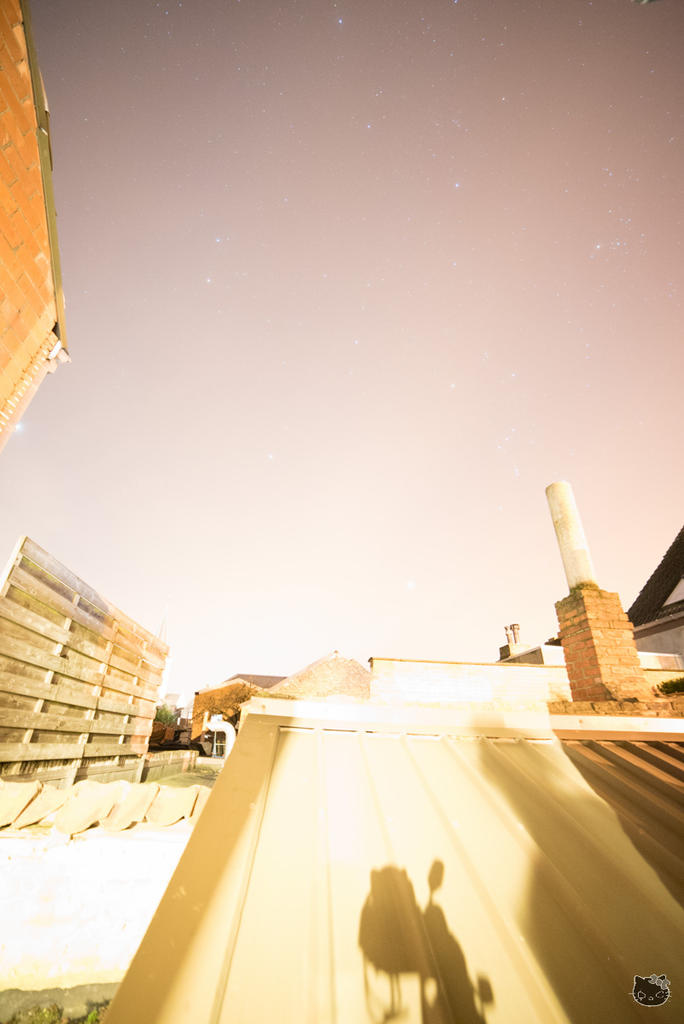

This seems strange. How come the fence on the left is not getting any brighter as the ISO is increasing ? Is that because it was so dark that even at iso6400 there was still no clipping ?
So the six shots you posted have all been adjusted in post to give the same effective exposure - that now makes more sense. The two you show above are very different as I would have expected.

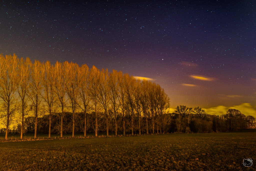

@J-see I am guessing you have not tried 'dark sky' photography? As if you did it would require more ISO. But I admit that for places where you get a lot of light pollution the lower ISO is better.
Really? Well you better start telling the camera companies as they seem to think it does effect the light input. But what do they know?I'm living in the Christmas tree of Europe when it comes to night lights so it is very hard for me to find an area where there is truly a dark sky. I know of one area that is less polluted but I need to have the time to get there and the right conditions which isn't that often.
But if I get the chance, I'll go there and give it a try but in theory I don't see how it would make much of a difference. ISO doesn't affect the light that hits the sensor nor how the sensor "counts" it so whatever ISO increases post sensor, should be in my shot no matter what ISO I used.
