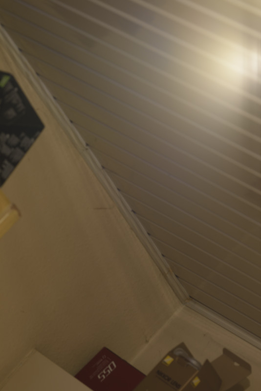

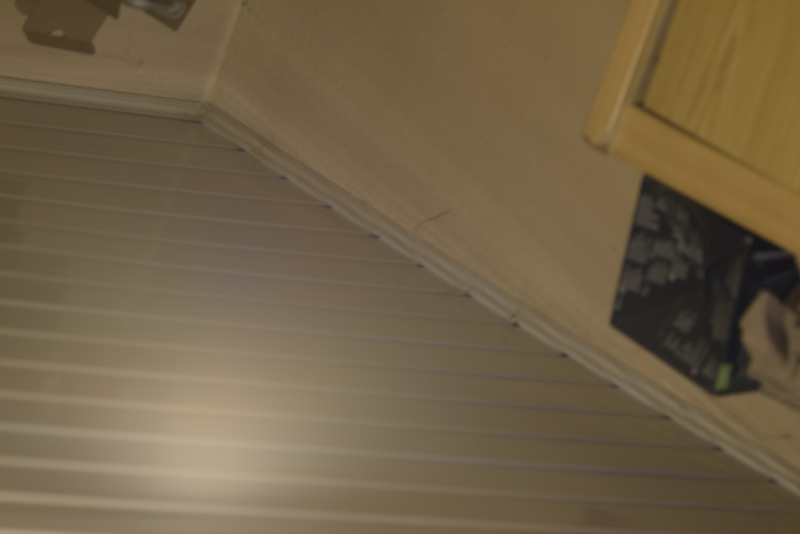

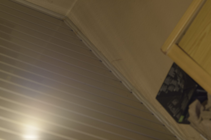

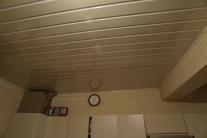

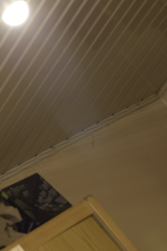

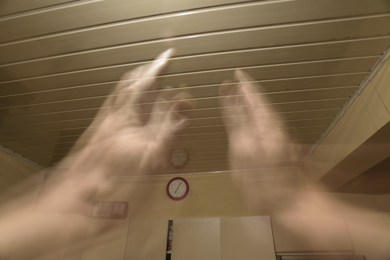

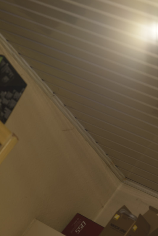

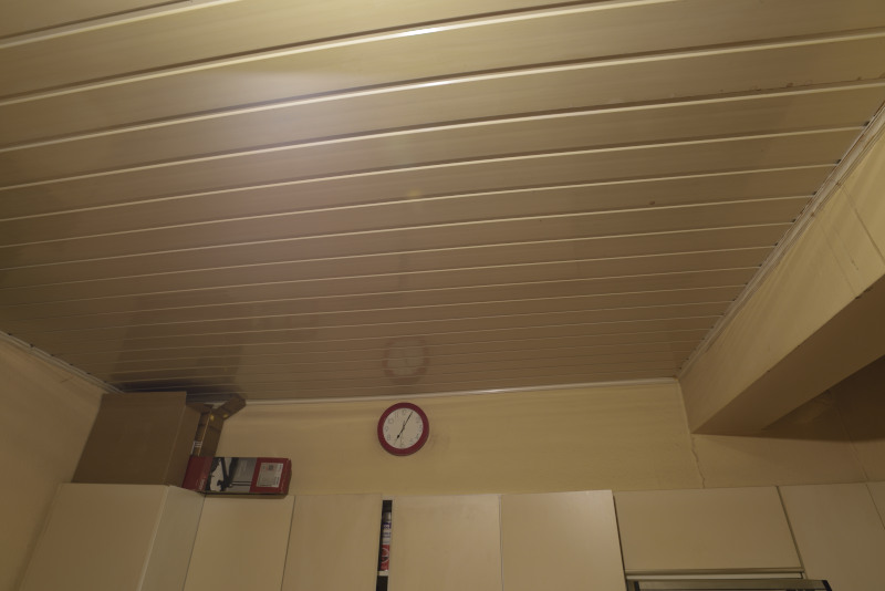

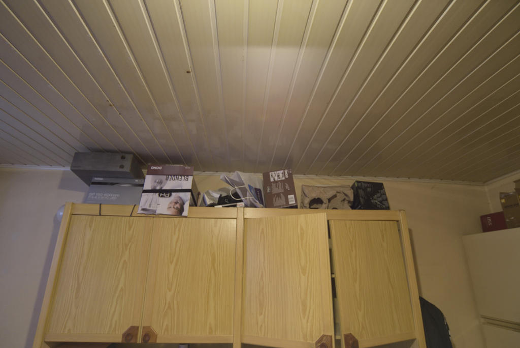

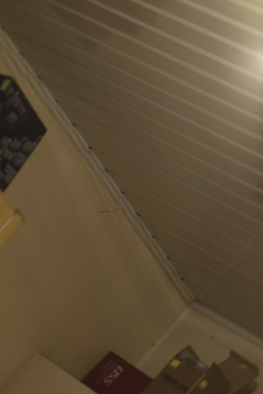

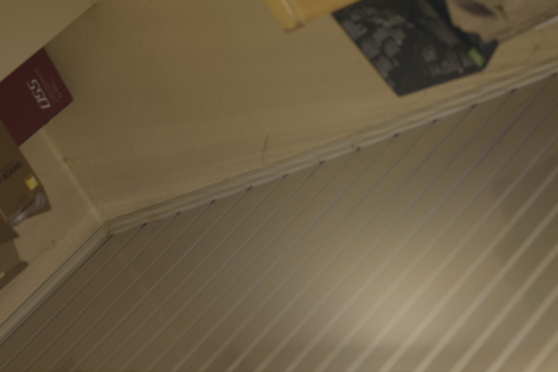

I'm going to try and show the confusion of the problem.

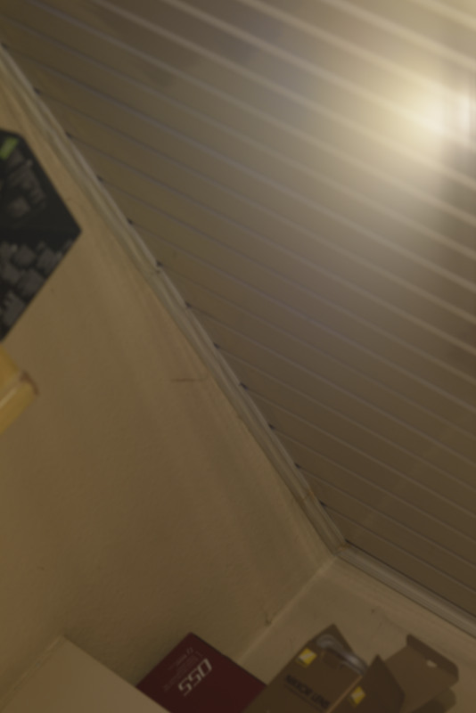

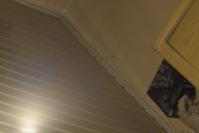

Here's the light leak.
Now I tilt it upward a bit more to make the leak disappear. In reality I just wash the upper part out.
Now I remove the distraction from the light leak shot by cutting the upper area that isn't affected. That's all I do here.

Using a Nikon 50mm f/1.8G I can cause this effect when using Live View but no matter how hard I try I can't get it happen in the viewfinder. I set my camera on a tripod and switched back and forth between the two modes: Live View clearly shows the dark band... Switch to the viewfinder and the band is gone... Back to Live View and the band re-appears.
No matter what I do, I can't get the banding to appear when using the viewfinder, not even a little. I don't know if this is the case with anyone else, but I've tried this both indoors and out and my results consistent.
I tried some more and checked the view-finder until my eyes hurt. Then I tilted the lens up and checked again.
What is interesting is that I also don't see the normal wash-out. The viewfinder is much darker but it also isn't the exact same view that reaches the sensor. Whatever we see, indirect light seems to be able to surpass that on its path to the sensor.

I can't see that in the viewfinder. There is no shadow line, that's the shot as it should be when no indirect light had hit the lens.
When the light is blocked (as it should), it is obvious that what appears to be shadow is the shot as it should be. The lighter part is the problem since in reality, it isn't there.

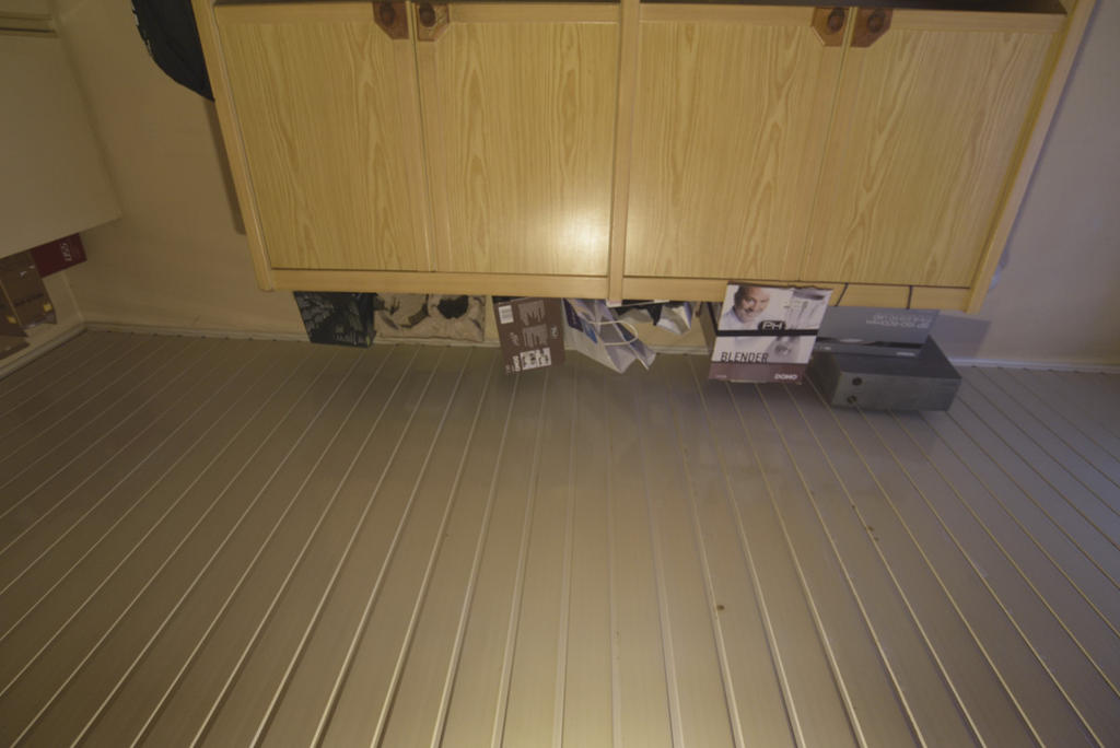

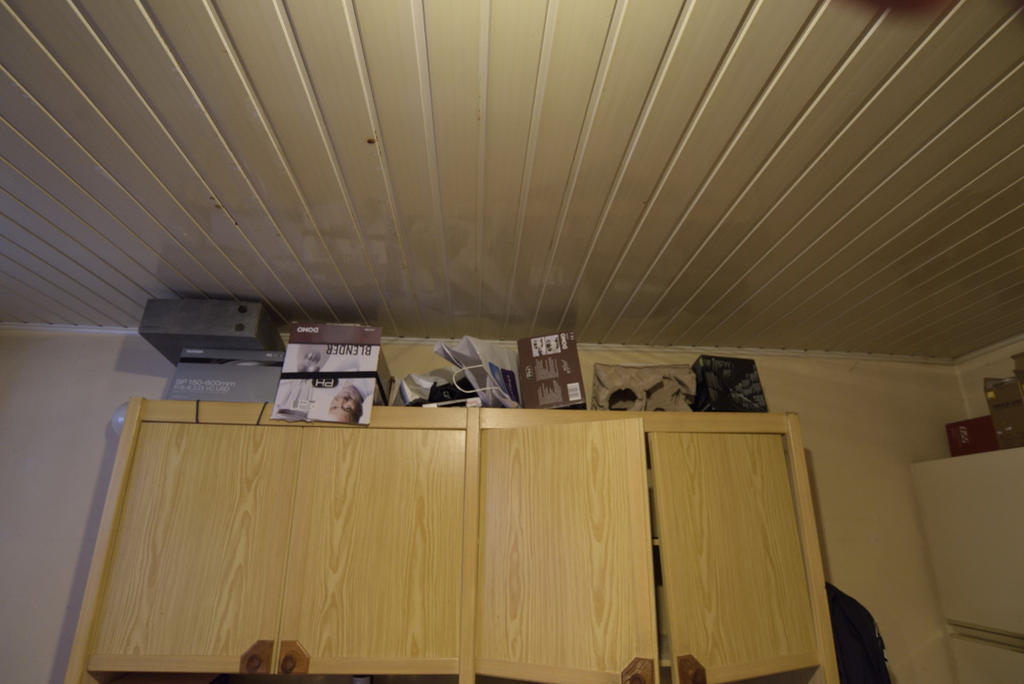

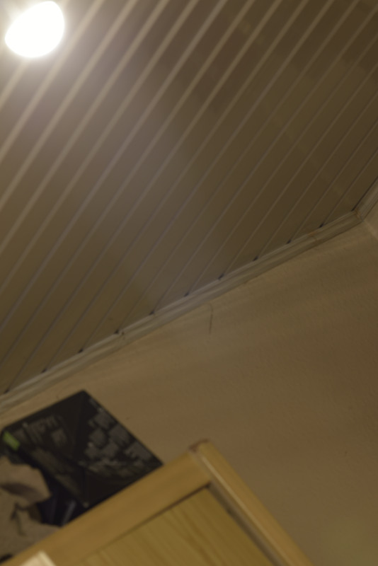

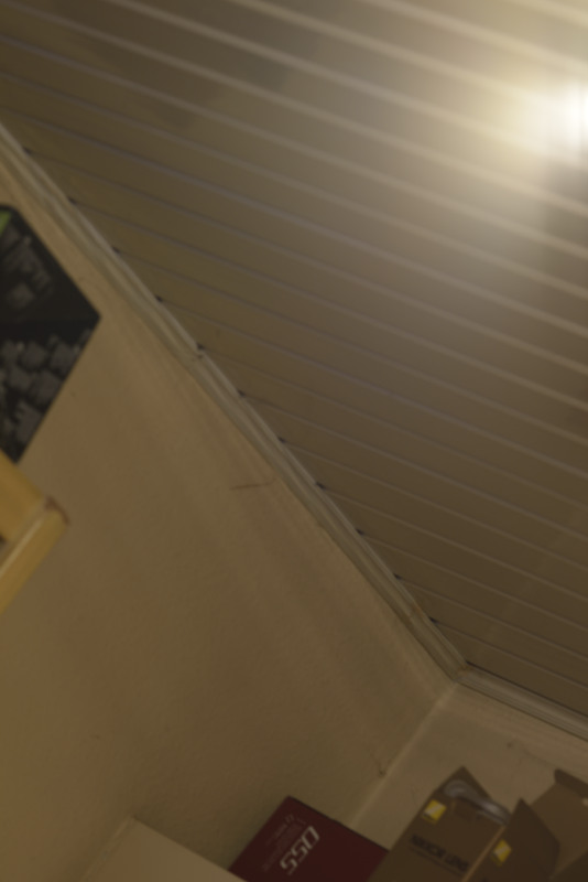

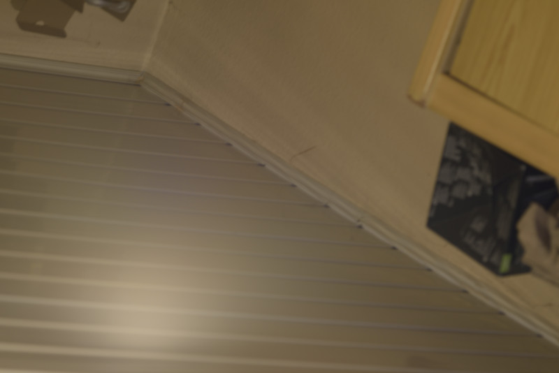

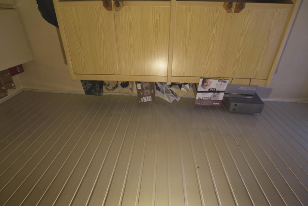

Btw, I forgot to do the most obvious thing. Turn the D750 upside down.
As you can see, the problem isn't the light but not enough wash out because of the block when using normal position. People are complaining that the D750 doesn't let them fully ruin their shots.

I see it in live-view but not in the viewfinder. The viewfinder is much smaller and darker compared but I suspect it not even showing the stray light for some reason. This light doesn't follow the normal path through the lens which may have something to do with it.
It could have something to do with the position of the mirror but regardless what view-method used, it always shows in the shot taken.

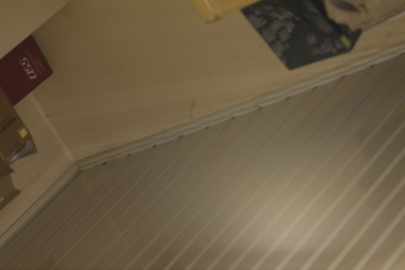

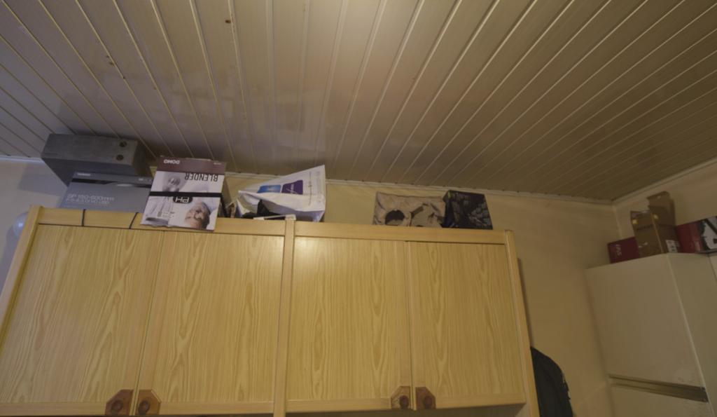

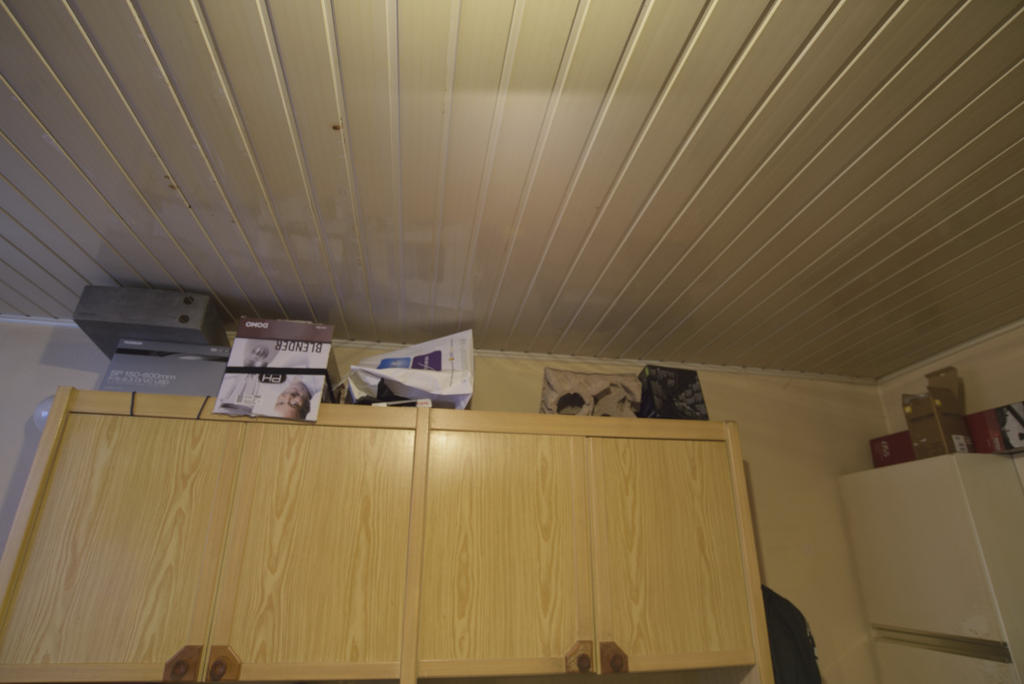

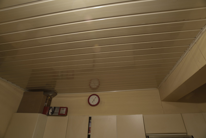

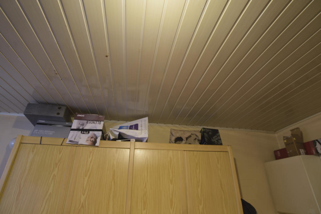

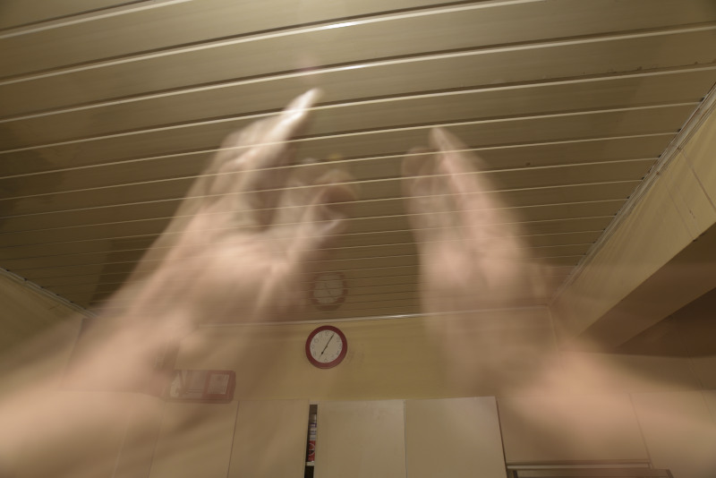

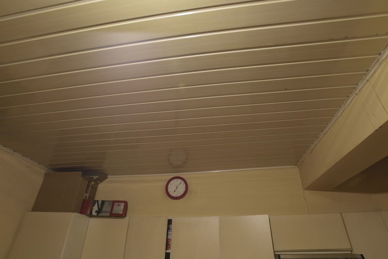

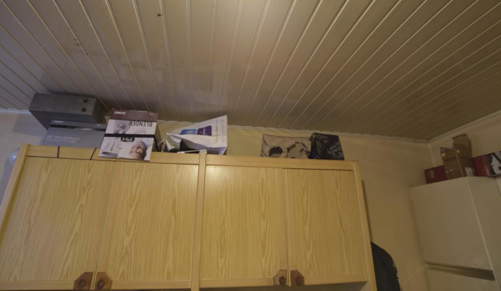

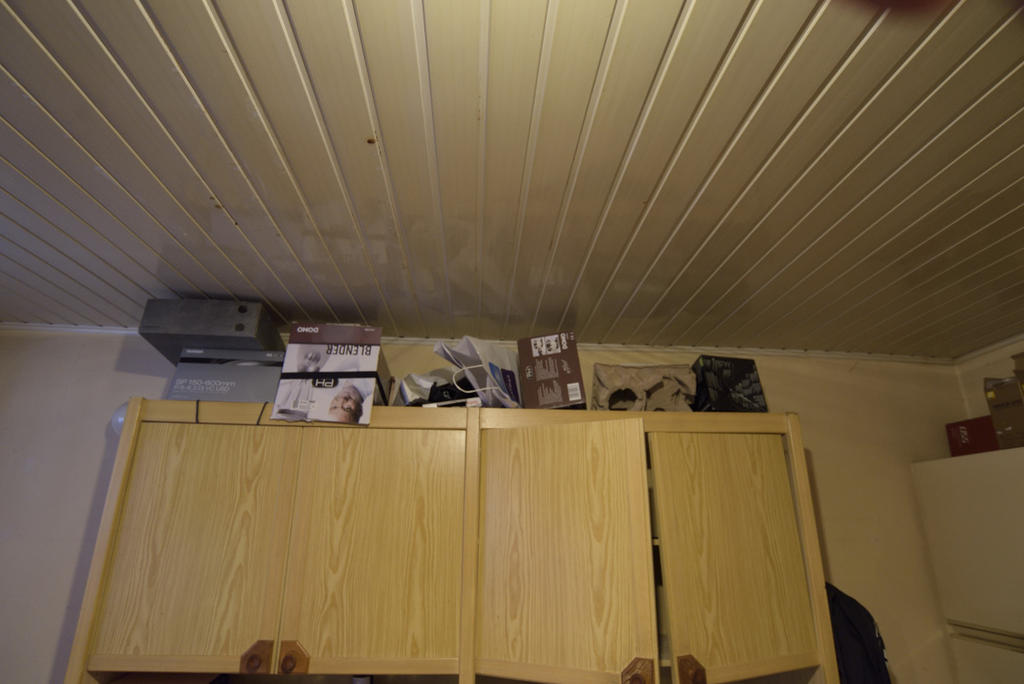

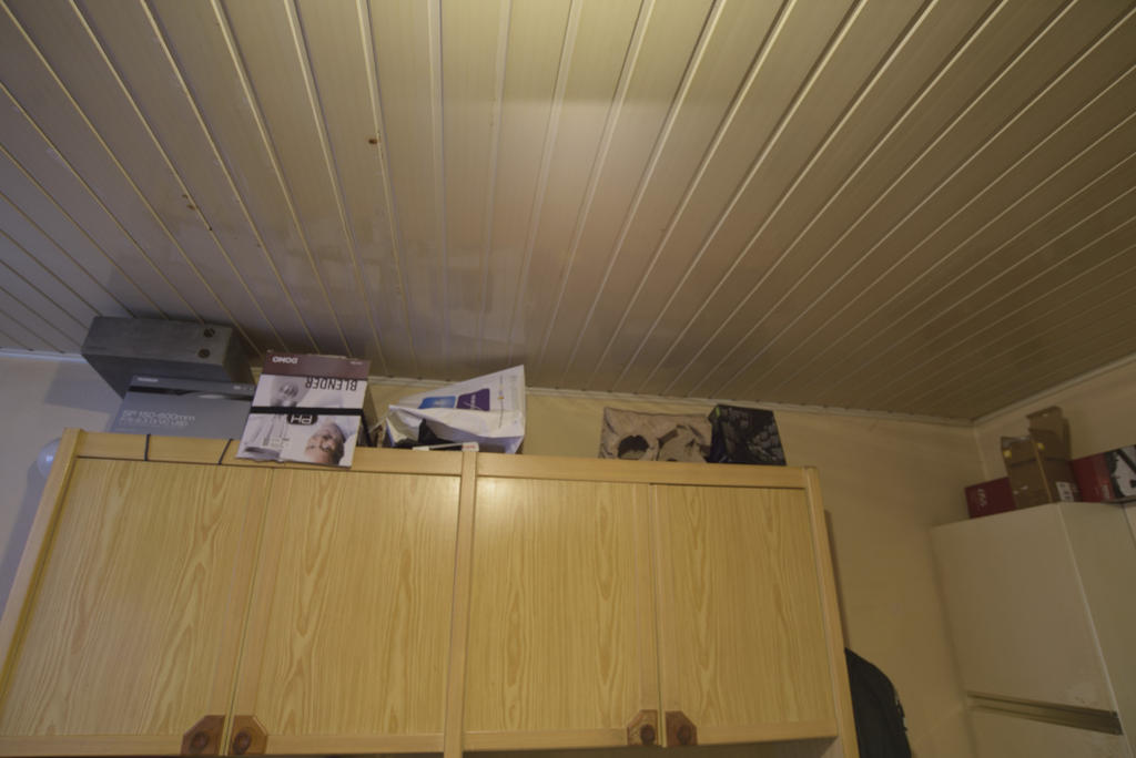

The previous showed my hand in the shot so to avoid people thinking I blocked the light, I reshot them. Lens at 90 degrees to make the CP most effective. First without, with, with, without.

[MENTION=31330]J-see[/MENTION] what is the position of the light that causes the effect in relation to the front of the lens and also the angle. Is it almost directly overhead and almost 90 degree?
J-see
@J-see what is the position of the light that causes the effect in relation to the front of the lens and also the angle. Is it almost directly overhead and almost 90 degree?
With the CP filter the front of the lens is at the center-line below but next to it at around 90 degrees. If that doesn't make sense, it's not too different from the set-up I showed in those shots posted in a previous reply. I made sure here I had the most effect using the CP.
