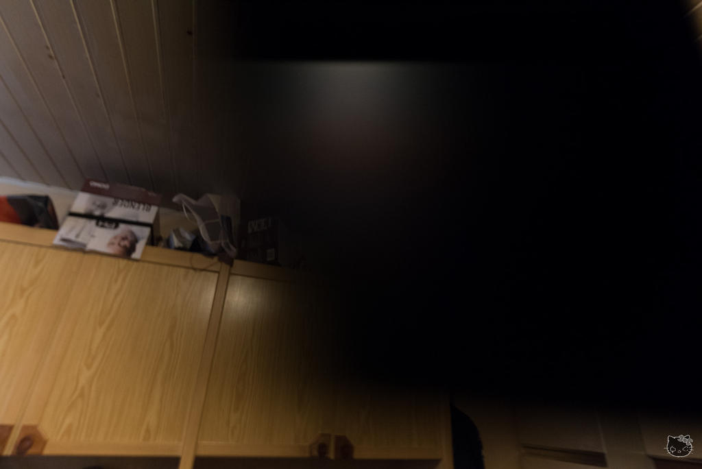

I don't know what cam you are using but I bet good money you can reproduce it even with that one. Put on a short lens and try. Maybe you have to turn it in another direction.
Test that first and if you can, you might understand how severe this issue is.
Btw, guess what I did when taking this shot? That's black material alright and it's not in front of the lens.

I tried it with black material as you see in that shot but because I had communication with the lens, the mirror jumped and I have no idea what actually happens inside. But you see that half the sensor is blocked but the flare still reaches it. The second try it worked but when I removed the lens to get the paper out and put it back on, there was no flare on my live which indicates that without me realizing, attaching the lens was enough to move all just that fraction to not show the leak. The margin to produce it is not that wide.
