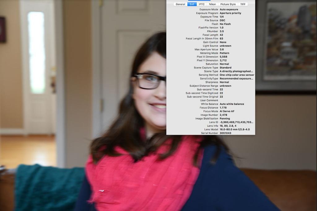

I wasn't sure the best way to share pics with EXIF, so I took a snapshot of the screen with the EXIF data showing. Yes, I am a newbie skill-wise, but this means a lot to me.
First off, I did a lot of research on the camera before buying. I know it's a very well respected camera and capable of extraordinary shots, much moreso than my previous camera. I am not in any way trying to disparage the camera. I know the issue is with my expertise, although the aperture priority issue is confusing to me (see below).
I have 4 examples with their EXIF data showing. I think the first three all show similar things. Actually, I think they represent about the best I can get with just straight aperature priority. Maybe 1% actually come out crisp. Anyway, they are representative of all the shots I get with factory settings reset and switched to aperature priority (arguably a little better than average of what I'm consistently getting). The light doesn't seem to matter too much (although performs poorer in lower light situations), the lenses (one of which is tried and true) don't seem to matter much, nor does the subject, not the background (although a less busy background does some better).

I know a lot of suggestions will come in to lower shutter speed or whatnot, and I respect those comments and will explore them. But I feel like I should be able to put it in aperture priority mode and not get a 99% blurry issue under a lot of different conditions. This is what I've always done, and for the type of nature photography I like, where I hike 6 miles and might get 10 - 50 good opportunities for shots and I have an instant to make the capture.
The last one is all black and that's the first time I've seen that. I think I was toggling back and forth between continuous low and continuous high. I've used Ch in the past without issue, but I believe the black photo resulted from switching to Ch in the indoors.

Capture Date2013:05:10 12:26:07
Capture Date2013:05:10 12:27:06
Capture Date2013:05:10 12:28:08

Well your shutter speeds for the blurry shots are all *extremely* slow; I'm seeing 1/6, 1/2 second shutter speeds for those shots.
Your all-black shot, on the other hand, shows a shutter speed of 1/8000, which is waaay faster than necessary.
The question now is why are the shutter speeds so unnecessarily extreme?

I missed the link the OP posted on a different page. Raise your ISO so your shutter speed can go higher. What mode did you use on your previous body? Was it some type of Program or Auto mode? As Chris mentioned, you should learn the relationship between the aperture, shutter speed, and ISO because they work hand-in-hand. You'll get it eventually! :encouragement:

Sorry but the errors in these samples are user error, i hope you can take this in the spirit it is meant,
Hand held at 1/4 of a second is a none starter that is why at the moment as its been suggested you perhaps need a better understanding of the exposure triangle, its not complicated.
Your shutter speed is very important when hand holding and the slow shutter speed is what killed this image.

what iso where you on because i cat see it on the Exif, i can assure you the camera will give you that instant correct exposure if you just hang on in with us and understand we are trying to help.

There is no reason to believe your camera is NOT working correctly.
In any of the semi-automatic modes, such as Aperture Priority, YOU control certain aspects of shooting and it appears clear to me you simply do not understand some of these crucial aspects. For instance, shooting handheld at 1/2 second will give any mortal photographer motion blur. Shooting at 1/8000 second at ISO 100 at the apertures you used will give any photographer a near all-black exposure unless there is an enormous amount light entering the camera; this is just the physics of photography.
As has already been stated, you simply need a better understanding of exposure and what each part of the exposure equation controls (shutter speed vs motion blur, for example) as it applies to photography and yes... This DOES address the issue. It is, in fact "The Issue".
