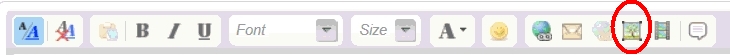

If you could upload the photos instead of attaching them, that would be far better.
Use the "Insert Image" button on the toolbar (third icon from the right):
