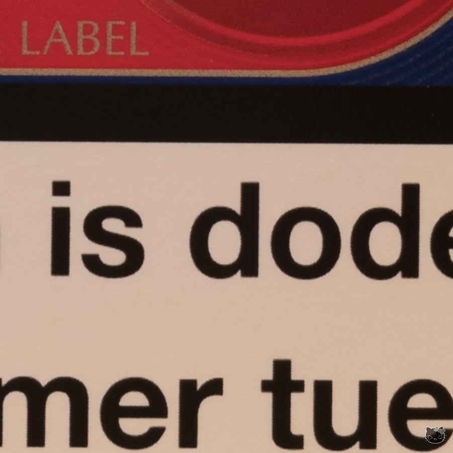

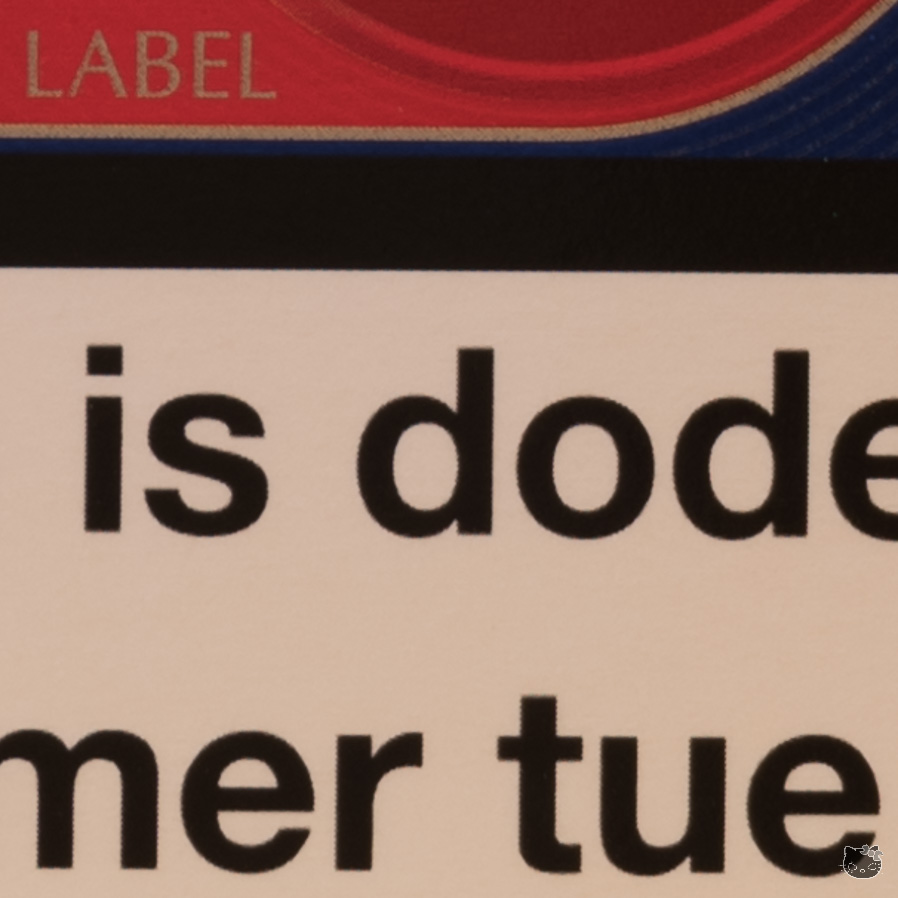

Tamron at 600mm:
Strange; manual mode same shutter speed but both different data in the EXIF.

[MENTION=31330]J-see[/MENTION] are you taking these as jpgs? If yes, what are you picture controls set at as this will affect what the images look like. Yours do not seem like anything I've ever seen before.Whenever I do this kind of thing I tend to use raw and expose them identically so that any sharpening can be applied to both in the same way. If you could post the raw files somewhere I could download them that would be really interesting.
If I get time I might have a look for something meaningful (I often use furry toys due to the texture being a good reference) to shoot, because as you zoom in more and more the lower pixel image will pixelate before the other.

No I always shoot RAW and didn't use any post besides the standard lens adjustment and minor sharpening LR does.
The shots are a crop in LR smaller than 1k*1k so I can show the 100% here. Higher and it gets scaled again. To equal the FX to the DX, I go to PS, copy the DX shot into the FX layers, duplicate the FX, scale it to 150% and with a lower opacity match it with the DX.

Interesting stuff [MENTION=31330]J-see[/MENTION]
Couple suggestions that may be useful.
The exposure does affect the sharpness of an image, especially when making these type comparisons and when we are pushing the envelope of sharpness. Our eyes are still in this process, and colors and highlights and shadows affect what we can and cannot see. So, I would aim for near identical exposures.
Instead of the PS matching/cropping method, crop the DX and then crop the FX to an equivalence size. Does not need to be identical cropped image as long as we see the same detail in the middle. Example: Crop the DX to 600 pixels wide (6000 * 0.1) and crop the FX to 394 pixels wide (6016 * 0.1 * 0.655). I'd use LRs cropping tool and change the crop until the size is where you want it. You can check the selected crop width by hovering over the thumbnail in the bin before clicking Done in the cropping tool.

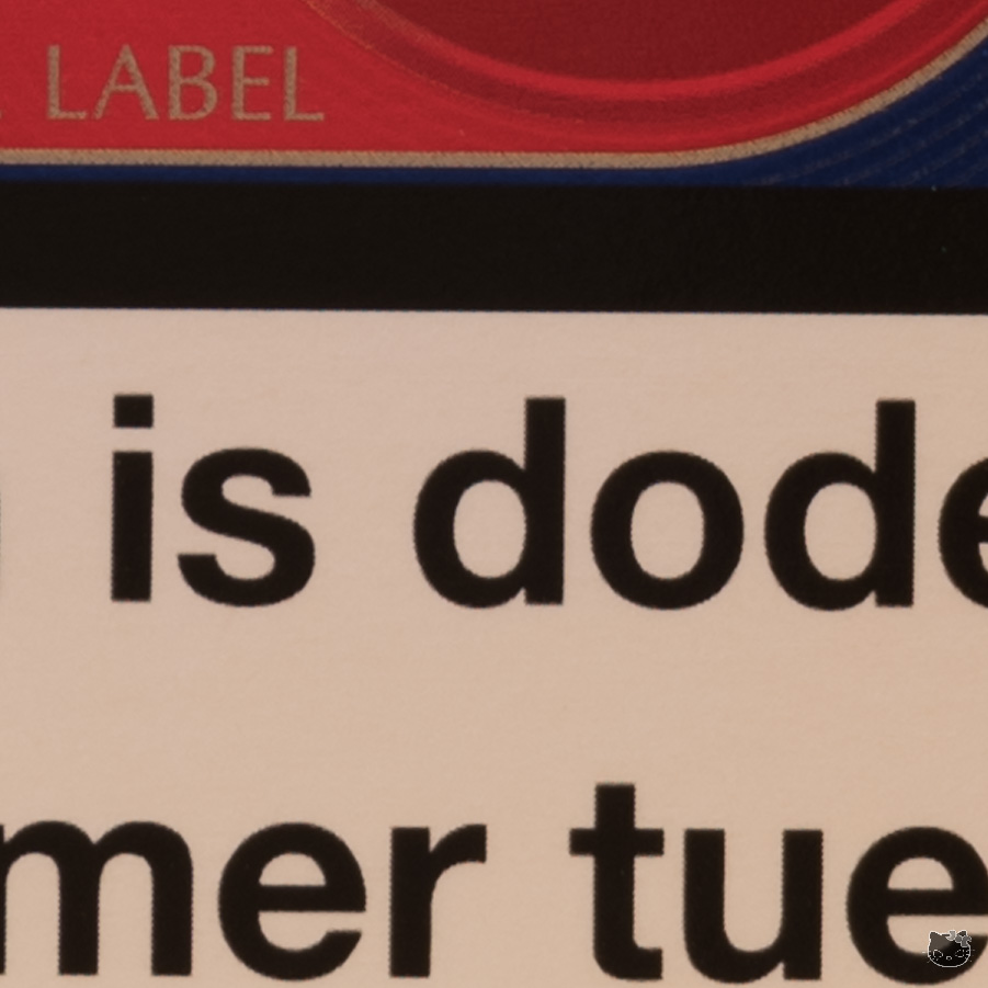

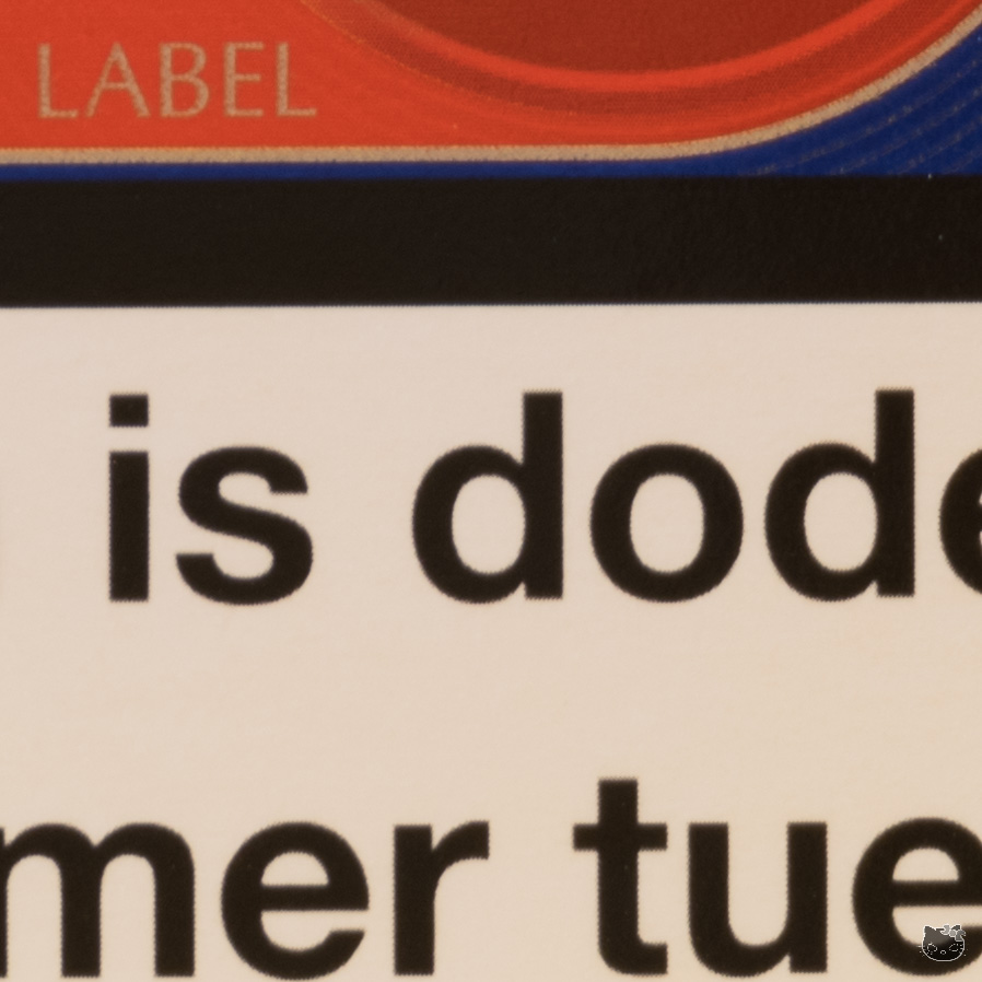

I agree the exposure can have a minor effect but the previous shots had the same exposure and the quality difference showed too. It's about 1/3th of a stop which is minimal.
I can scale them in LR. I just used PS because I wanted to be as close to the same size as possible. It's annoying I can't define a crop size in LR. That should have been a standard option.

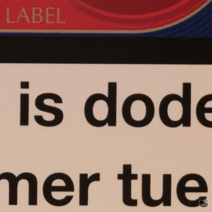

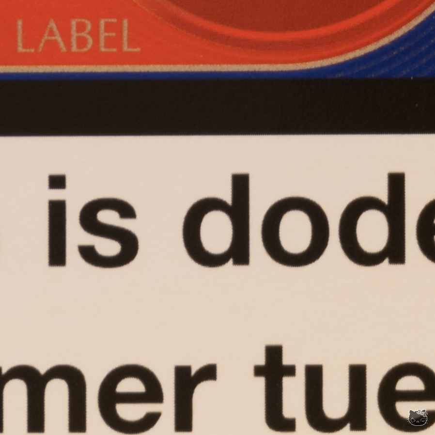

I cropped it in LR to about the same size but then had to save that again in a bigger format to match the DX shot. I never get that as good as simply matching in PS. In some way it shouldn't matter. If we'd blow up something, we'd do it as good as possible and would use PS anyways.
Anyways, here it is but it isn't as correctly sized as the other.
I'll shoot the other lengths of the Tam tonight to see if it is the same for all. It's some work since I have to use the self-timer function on the D3300 to avoid trigger-shake.

Are the images shown above done using "Mup"? If not, then you should have especially with a 1 second shutter speed.
The other factor when comparing DX vs FX when pixel peeping, you need to use a lens that is mounted on the tripod so that nothing is changed except the camera to compare the image quality. Just my two cents.
J-see
Yeah, the D750 is all shot with Mup and the last of the D3300 is shot with the self-timer. I doesn't have Mup and I have no remote. It took me a while to realize the self-timer works too.
Lens was mounted on the tripod all the time, I just replaced the cams. Except the 35mm which cant be attached.

Thought about this earlier, but slipped from the mind. Since the D3300 has no MUP, would be a more fair battle at a faster speed. Yes??
J-see
I used the self-timer since the mirror of the D3300 isn't really causing quakes. It's not like the D750 that comes with 2 little guys inside that slam it up and down. It's hard to shoot high shutter inside since I lack the light and when upping the ISO, the D3300 would suffer more noise than the D750. Outside it is not the good time a year and even the wind might mess up.
I'll see what I can do later on. Any vibrations picked up would count for both. I took multiple shots with the D3300 to get the best. It's not as if I can accidentally shoot sharper.
