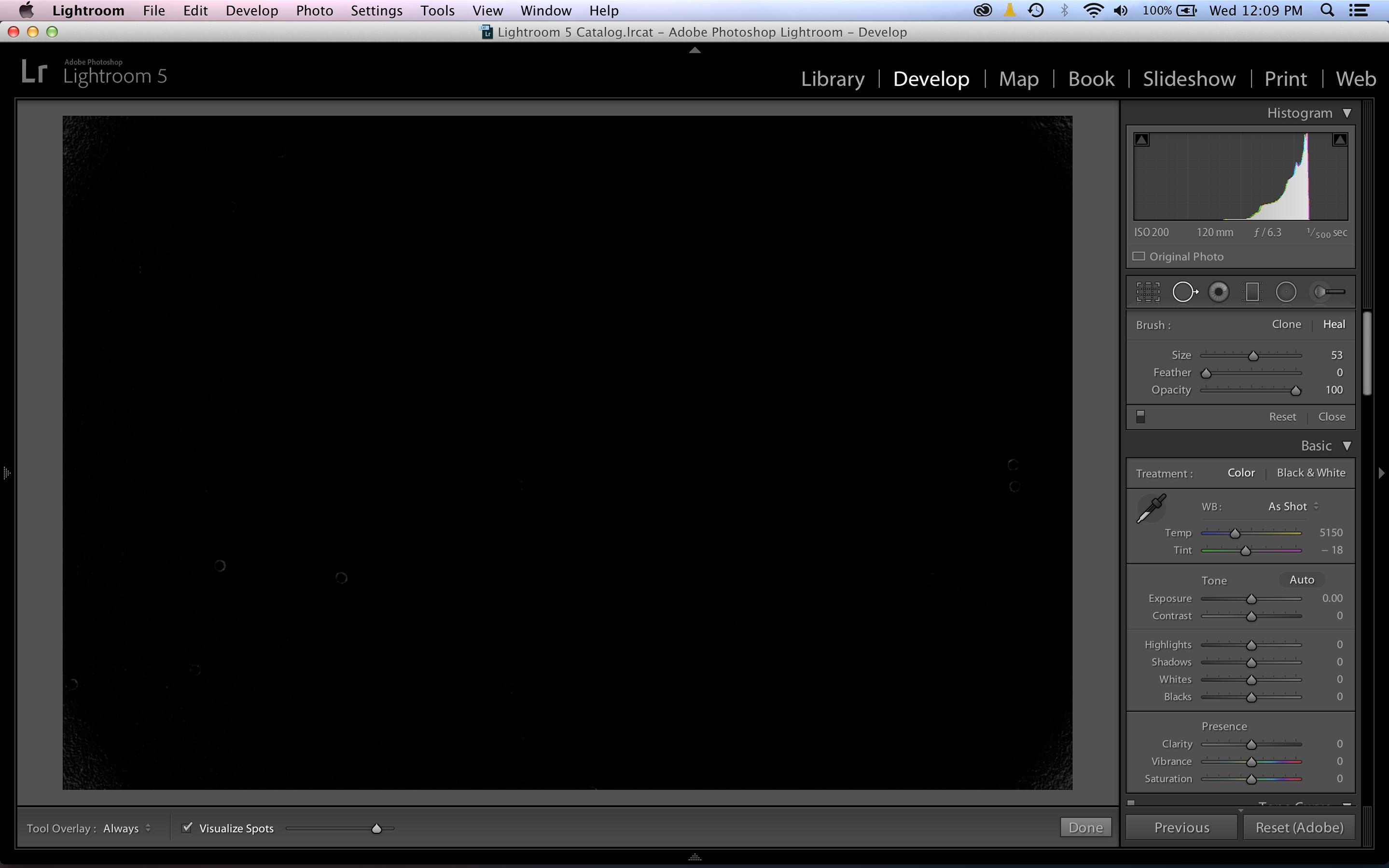

Thankfully this is the current dust reference pic - shot at f/22 of a white piece of paper with manual focus at the minimum and run into LR's Spot Removal Tool with "Visualize Spots" turned on (fastest tool to check - white specs are dust). Even spread of dust says it's just that, and it's been a good 8 weeks and a 7000 shots since the last cleaning.

And just so I'm clear with the dust photo above, that's over 7000 shots and probably 30-40 lens changes in all sorts of cold, dry and static-filled conditions. Yes, the sensor is dirty - with normal dirt that I get on every camera I have. I've only had to treat about 5 spots in post in the last month, and they were all on high structure HDR shots. I don't notice these on any of my normal shots. For what it's worth, here's the same dust reference shot taken at f/6.3. Not a spec visible. Like I said, dust is normal.

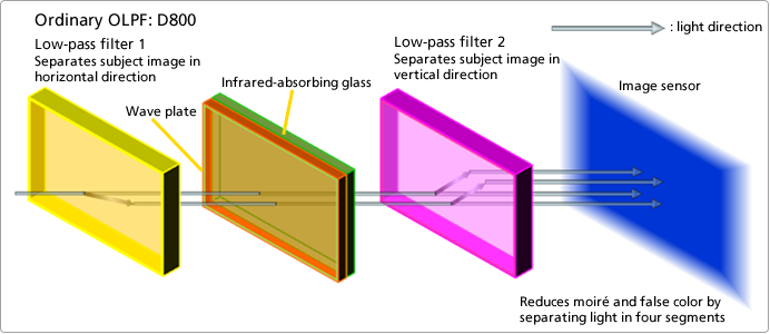

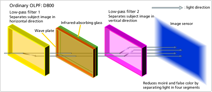

I am including a JPEG drawing of the filter arrangement that lay on top of the sensor. The text shows this filter stack is for the D800, but was reading this same stack is used for the D600. I cannot substantiate this claim. The first yellow low-pass filter is the one where dust, and or oil, accumulates. I am not sure which filter was removed from the D800E stack.

As for the filter stack, the D800e has the second low pass filter (pink) removed and replaced with what is essentially the reverse of the first low pass filter (yellow). This reverses the diffraction caused by the first (like shooting light through a pair of prisms: white -> full spectrum -> white). In the D7100 I believe they've fully removed all low pass filters from the stack.
