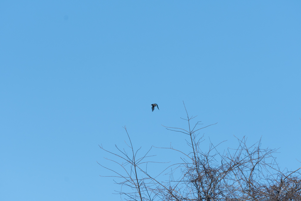

I have reached no end of frustration with the Nikon Repair Rep. Supposedly they can't see any softness in the images I submitted although I sent close up images which show the lens focuses normallyyet images taken from a distance are soft (it's always been the distance ones that don't focus well). But more importantly, he is ignoring my repeated question as to why he isn't address the VR issue. It was included when I sent in the lens the first time, and as soon as I realized it was omitted from the service order, I called a second and third time trying to get it added to the repair. I even wound up with more than one repair order number due to my calls. It shouldn't take the Normal VR an extra second or two to settle down before the shutter is pressed when the Sport VR works properly. Images taken with the Normal VR have a tendency to jump around inside the viewfinder and aren't always in focus unless I hold down the button and wait longer than usual for the image to settle.
He wanted me to turn off the AF Tuning. I did that and submitted images yet received another request for the same thing. I've never had any luck with getting a repair done correctly the first time. In the past, the repairs that weren't successful the first time were my D600 (3 failed repairs), 20mm f/2.8 lens, SB-910, and now this lens. :grief:

Yes, it would be nice if they'd do that. He wants another image with the AF Fine Tuning turned off. I told him I never had any value set for the 300mm lens alone - only for the 300mm lens coupled with the 1.7x TC. But I went out yesterday trying to find a suitable subject. One that needs to be in the far distance since that where the AF suffers. I settled on some signs, but it was so immensely hot here - and of course the signs are near asphalt - that heat refraction showed up. So I need to go out again today since the temps will be a little better.

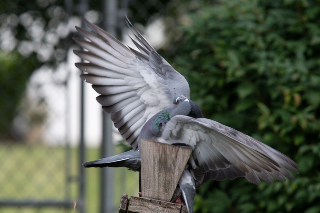

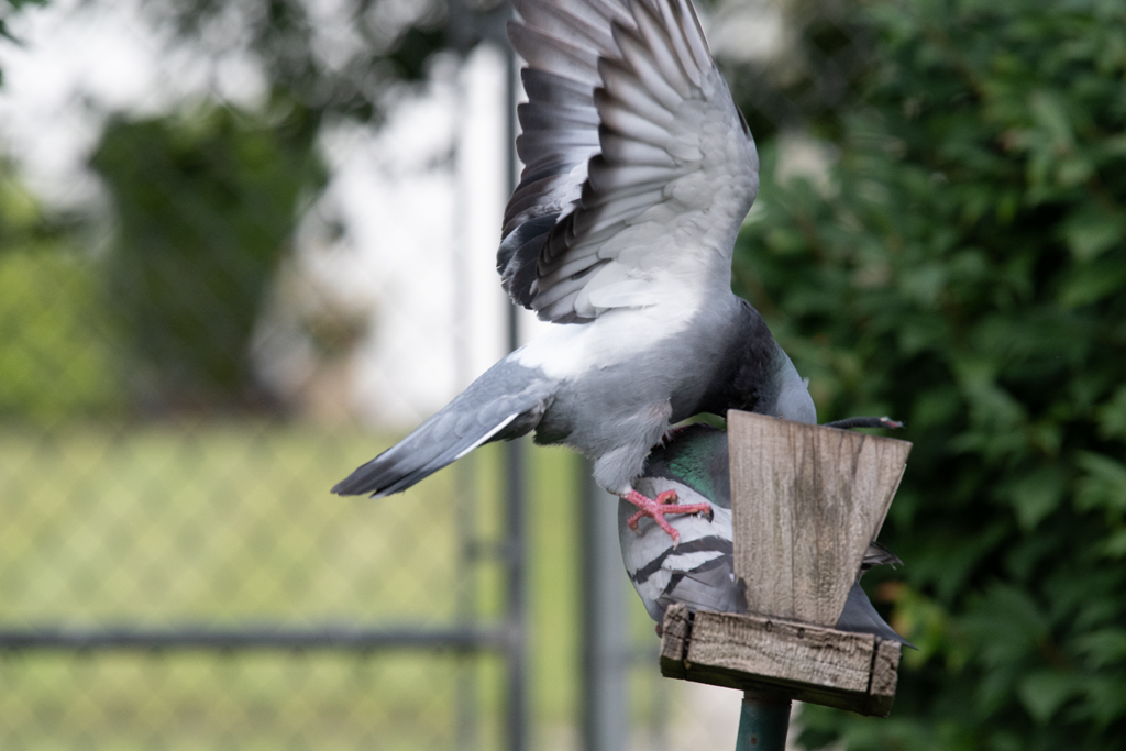

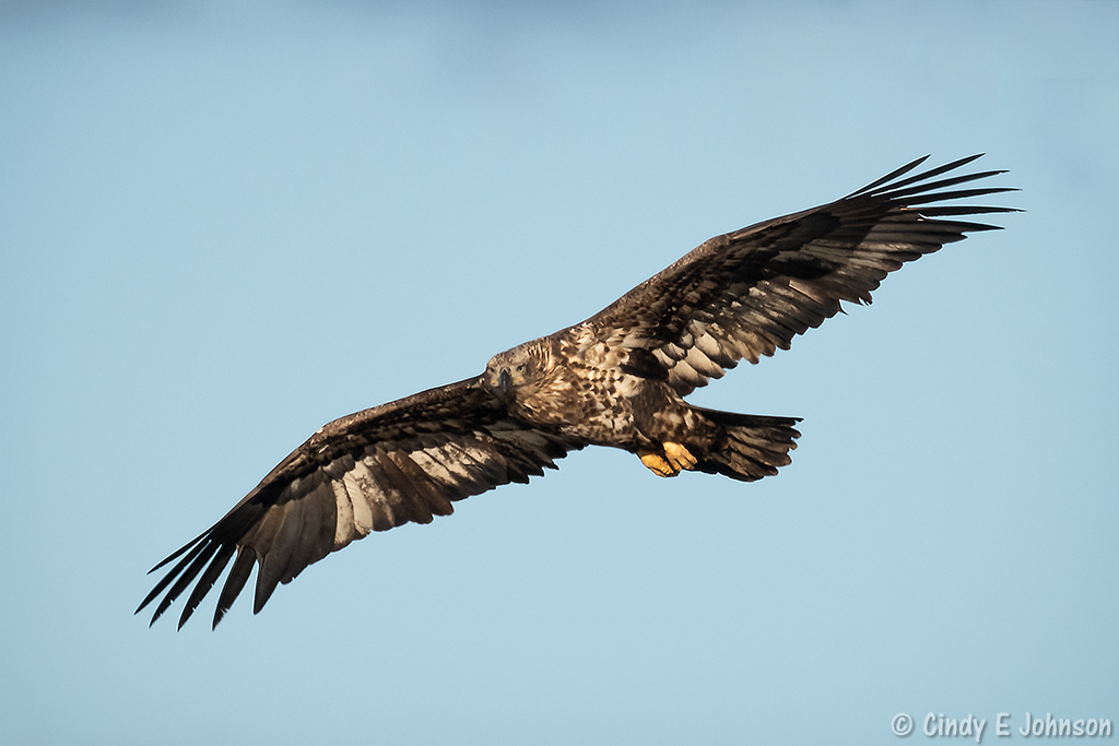

Lol - would love to see this Nikon guy's reaction to these images I just submitted. :beguiled:

I was really surprised to hear Nikon considers the pigeon photos to be sharp enough. :hurt: BUT I have to turn off the AF Fine Tune which I thought I already did and submit something new.

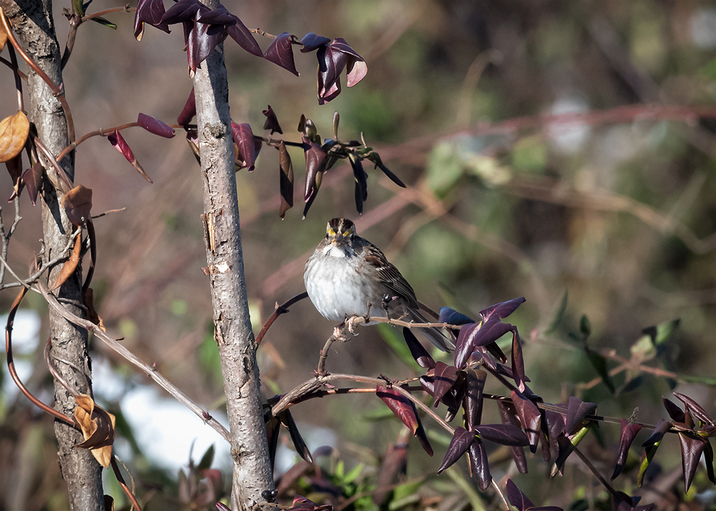

Here are a couple from yesterday's outing. Considering both are cropped quite a bit, and the focus point moved partially off of them, the sharpness isn't too bad. I focused on the face which is slightly soft. It's having to wait the extra time for the VR to settle that is a big pain. But if the focus point had focused way behind, then neither would have been acceptable.

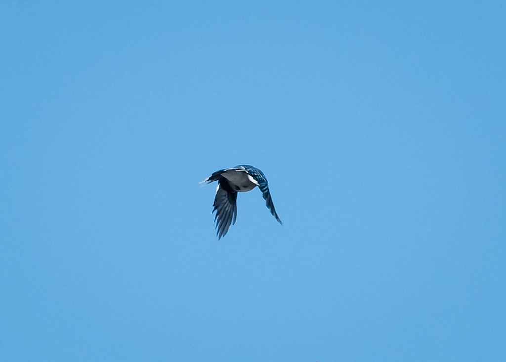

I took a handful of test images. Almost everything was in really good focus especially considering how far away they were. Here are a couple of examples.
This one is an uncropped image edited with my normal workflow.
Here is a cropped version - which is a rather extensive crop - also using my normal workflow.
And here is another image already cropped quite a bit and edited. The AF might have caught a branch, but it's still FAR superior in sharpness considering the results I've been dealing with for a long time.

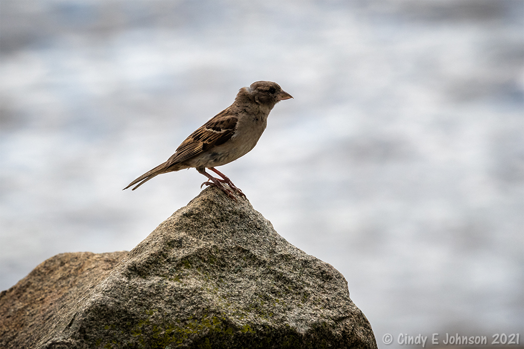

Since I tested out the 300mm lens on my D500 Saturday - small birds at a distance and was impressed - I went out on Monday with this lens and the 1.7x TC. Nope. Everything was soft. This one I managed to sharpen enough although it is excessively sharpened. It was the best of the images I took.
But just to be sure, yesterday I went out with just the lens, and it performed very well. :) So cleaning off grime from the lens' contacts as well as the contacts inside the D500 body seemed to resolve the issue with the lens. Obviously the refurbished 1.7x TC just isn't going to cut it.

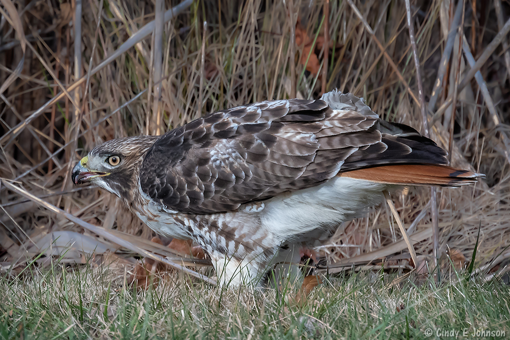

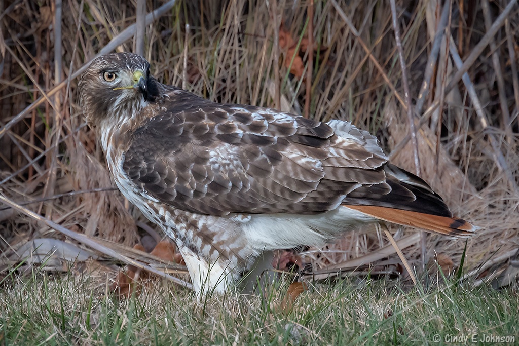

So today I went out with the 300mm and the 1.4x TX on my D500 and came across this Red-Tailed Hawk. The lens does very well with this 1.4x TC which hadn't been the case ever since I began having issues with the lens.
So question for anyone - and there is no wrong answer here - the background and the hawk are pretty much the same color and brightness. I darkened the background as well as lightened it yet didn't like either. Both of these are 'as is' so to speak since none of the changes to the background were pleasing. Curious what others think they'd prefer ... a darker or lighter background Or would it be best just to leave it as is?
