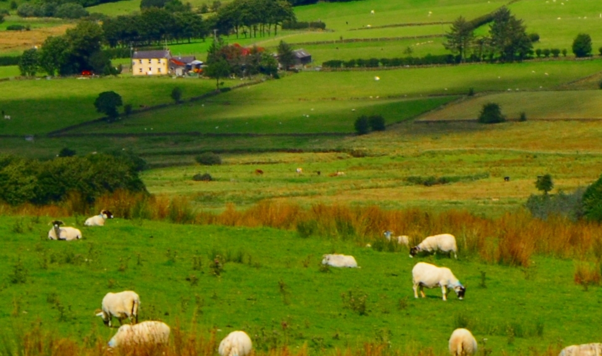

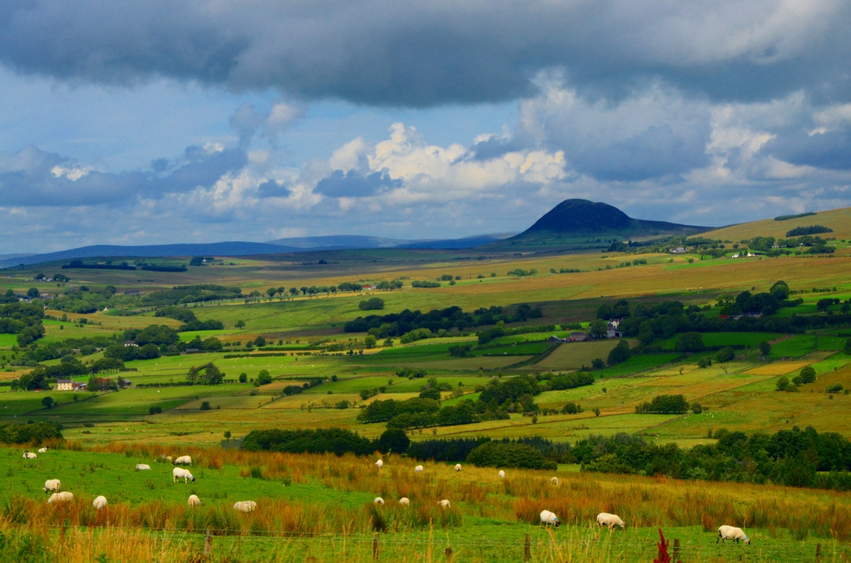

Since getting my camera I haven't really had the opportunity to get out and about much to take many photos, so on Tuesday, although I was at various meetings, I took my camera along just in case. On my way home, I came across a scene, and decided to photograph it. As can be seen it is a landscape shot.

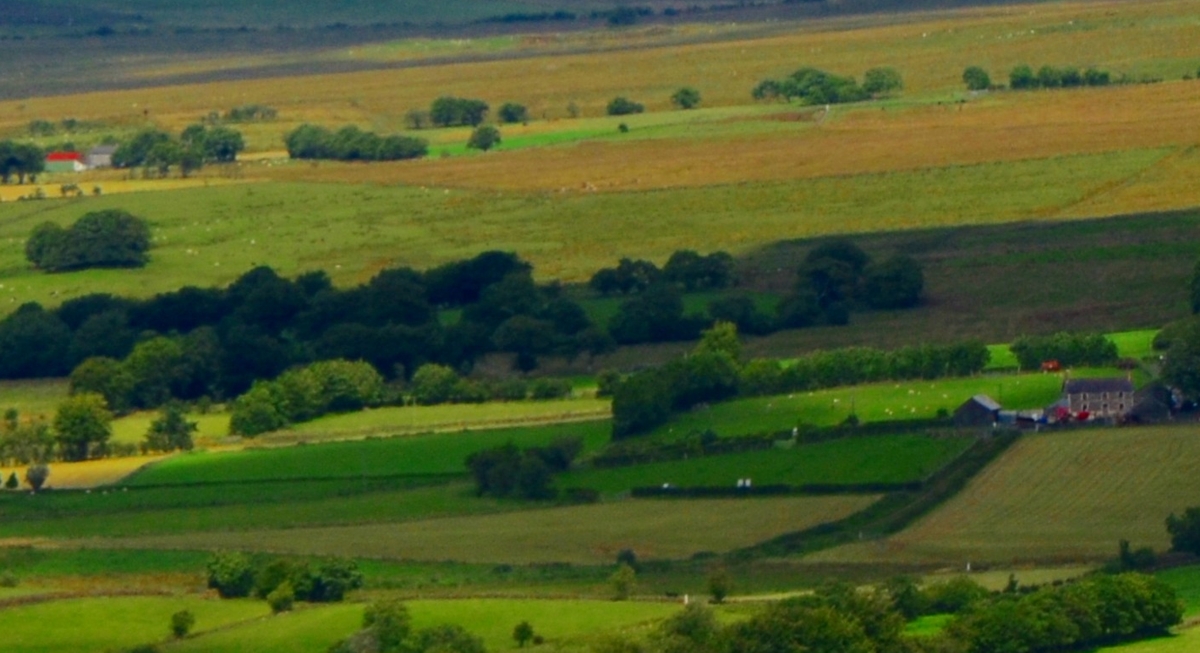

Initially I thought, just by looking at it in the live view it looked a little soft focused. When I took it home and put it on my pc, I was a little taken aback by what I found. Maybe I'm just too fussy, but below is a crop from the photograph, when viewed at actual size (100%). Is it me, or does it look a little fuzzy, I must say I expected better.:numbness:
Please let me know what you think. The image was recorded at 1/400 sec @ f8 ISO 400 using my D7K with 18-105, at 18mm.

Well I can see ISO 400 on aperture priority....the snap is definitely soft and like I have heard you say before AH Ireleand sure is handsome I can see why you stopped for the snap.
So my guess wide open aperture (on the 18 end too!) ISO really should have been 200. The first image is OK but damn that black cloud across the top! Like Rick said too Darn AF! To me landscape scenes like this are shot just as easily at ISO 200 shutter speed 200 F16 with manual focus on the nearest limit of DOF or maybe the farthest limit of DOF depending on what you want to do with the snap.
Pierro
Agree with Rick, but also the 18-105 is a consumer lens, and it just may not be resolving the IQ at its widest setting. Its asking a lot of a big consumer zoom to give you the detail that a pro W/A prime might do.
If you think you can get down to a camera shop that has a pro wide prime you can test ( it means going outside the shop ) then you can satisfy yourself that its the lens, and not you thats the problem.

Your crop is about 1/16 of the actual image and taken from the edge and corners, which I believe are probably the softest part of the lens...Have you tried any other shots like a portrait or such...The softness could be a few things...Try the camera on Auto Focus Constant [AF-C] in case you moved between focusing and taking the shot..

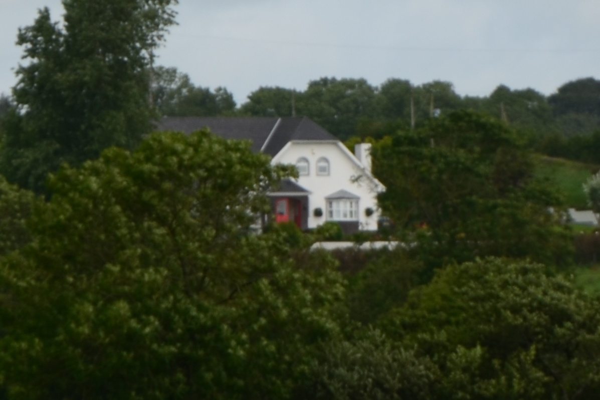

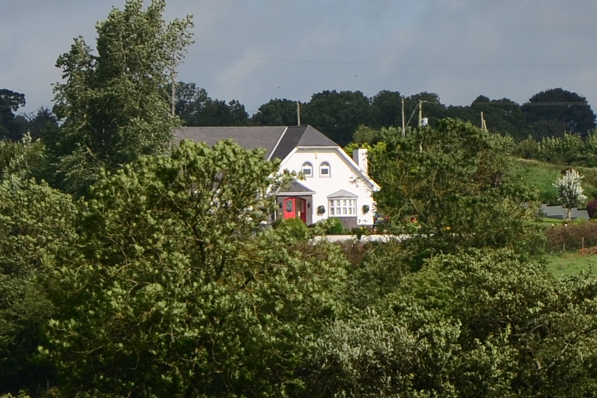

Right - here's the update. I took some fresh photos today, with AF and cropped the centre of the image at 100%, and the same thing had happened - nothing unusual there. Then, however, I switched to manual focus, zoomed to 105mm, focused on my subject, took the zoom back to 18mm, and took the photo, and guess what - the image was pin sharp, like it should always have been. What's more I discovered that when I was focusing on the subject which was approx 800 yards away, I could focus BEYOND that, i.e. BEYOND INFINITY. According to the supplier this definitely should not happen. They are hazarding a guess that it is 80% lens fault, and 20% camera fault, but have admitted, based on the images I supplied, that it is not good enough. I'm totally not happy, and will visiting the store with the camera on Saturday with a view to total replacement of the product. A camera one month old, having only been used twice should not be doing this. I will let you know the outcome.
test_image crop.jpg This is the crop from the AF shot
manualfocus_test_crop.jpg This is the crop from the manual focus shot
