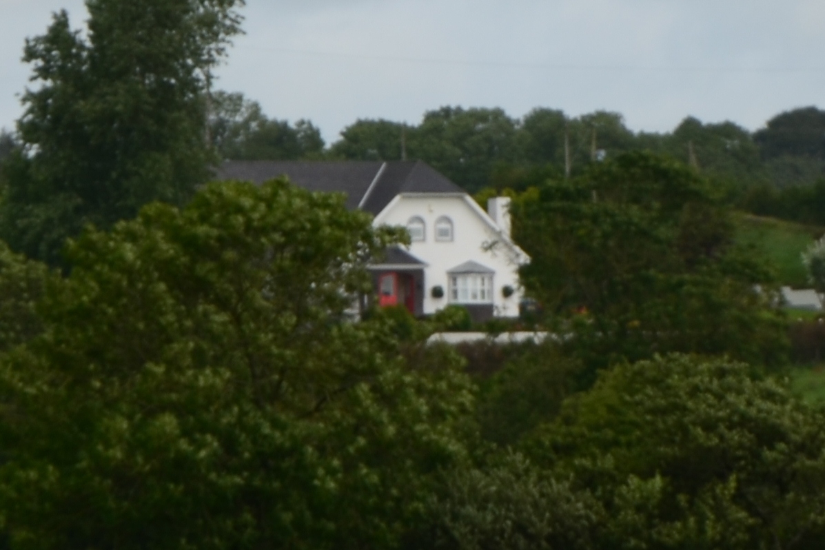

Not being familiar with 'the ugly focus problem' I Google'd D7K focus issues, and ...where do I start...wow...I'm not alone then...
My problem seems to be that if I use AF for a landscape, irrespective of what zoom its at, it focuses short; not by much - switch to manual focus and the slightest little adjustment puts it in focus. But my big beef is that today I took a landscape, set up the tripod, and set the camera to 1/30 @ f22, and focused on a wooden post about 16 feet away. Now everything beyond 16 feet should be in focus, right?
Not on this camera, the background was anything but in focus. As with the other landscapes, even I forgot about aperture and focused on the horizon, the scene isn't in focus (as was the case with the images of the white house above). That is really worrying...

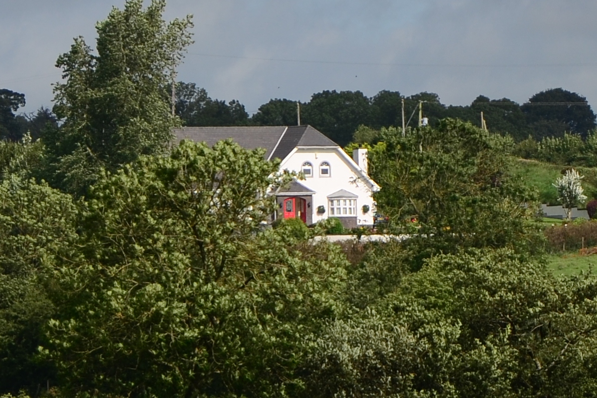

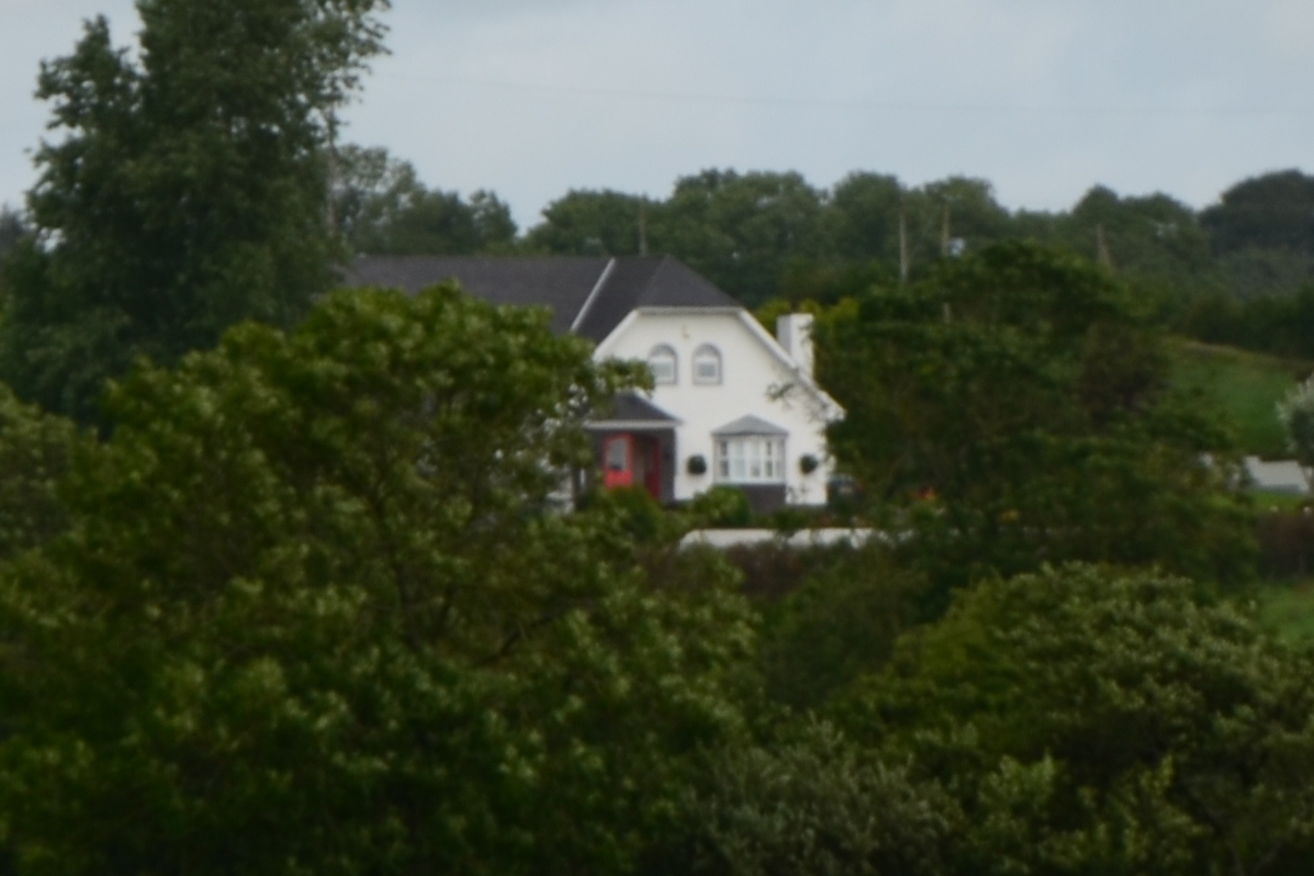

Right - here's the update. I took some fresh photos today, with AF and cropped the centre of the image at 100%, and the same thing had happened - nothing unusual there. Then, however, I switched to manual focus, zoomed to 105mm, focused on my subject, took the zoom back to 18mm, and took the photo, and guess what - the image was pin sharp, like it should always have been. What's more I discovered that when I was focusing on the subject which was approx 800 yards away, I could focus BEYOND that, i.e. BEYOND INFINITY. According to the supplier this definitely should not happen. They are hazarding a guess that it is 80% lens fault, and 20% camera fault, but have admitted, based on the images I supplied, that it is not good enough. I'm totally not happy, and will visiting the store with the camera on Saturday with a view to total replacement of the product. A camera one month old, having only been used twice should not be doing this. I will let you know the outcome.
View attachment 14842 This is the crop from the AF shot
View attachment 14843 This is the crop from the manual focus shot
Just a few things here. I don't know if you were using a tripod for these shots, but I noticed that the shutter speed on the "unsharp" shot is 1/125 where it's 1/250 on the other, plus the fact that the lens is not at the same focal lenght (the "unsharp" shot is longer focal length where the faster shutter speed should have been used).
I also notice that your shutter actuation is only around 200 shots so I'd suggest you practice your skills a little more before accusing the camera of malfunction.
I don't mean to sound harsh and I know your feeling cause I have that camera and remember my feelings until I started to use faster shutter speed and/or quiet mode (seems to produce sharper shots).
Your camera's warranty is still good for a year or two, so give yourself time to improve and do not look at your shots at 100-200% on the screen just to find unsharpness… Take pictures and look at the pictures, not the single pixels.

Marcel, I wasn't using a tripod. The unsharp one was taken at 1/125 f5.6 @105 mm on Program mode. The sharp photo was taken at 1/250 f5.6 @ 92mm on Program mode. I imagine the slightly higher shutter speed was a combination of the fact that the sun was shining in the sharp photo, plus a slightly lower focal length (which was purely unintentional, I must have adjusted it by mistake). Since nothing in the photo is in focus I can only deduce that AF has focused beyond infinity, which as I now understand, is a safety feature built into lenses to protect the AF motor. If the foreground was in focus, I would understand that it was picking up something in the foreground that I didnt notice, but that isn't the case.
And the other wee thing. If it was only happening in one or two images, I'd understand it was maybe operator error, but to have 2 sharp images out of 140 is not a good average. I might be wrong some of the time, heck I might be wrong most of the time, but I'm not wrong all of the time, and especially not when I set the camera to SCENE LANDSCAPE, where I'd expect it to get things perfectly right (and it's still not focusing properly.)
