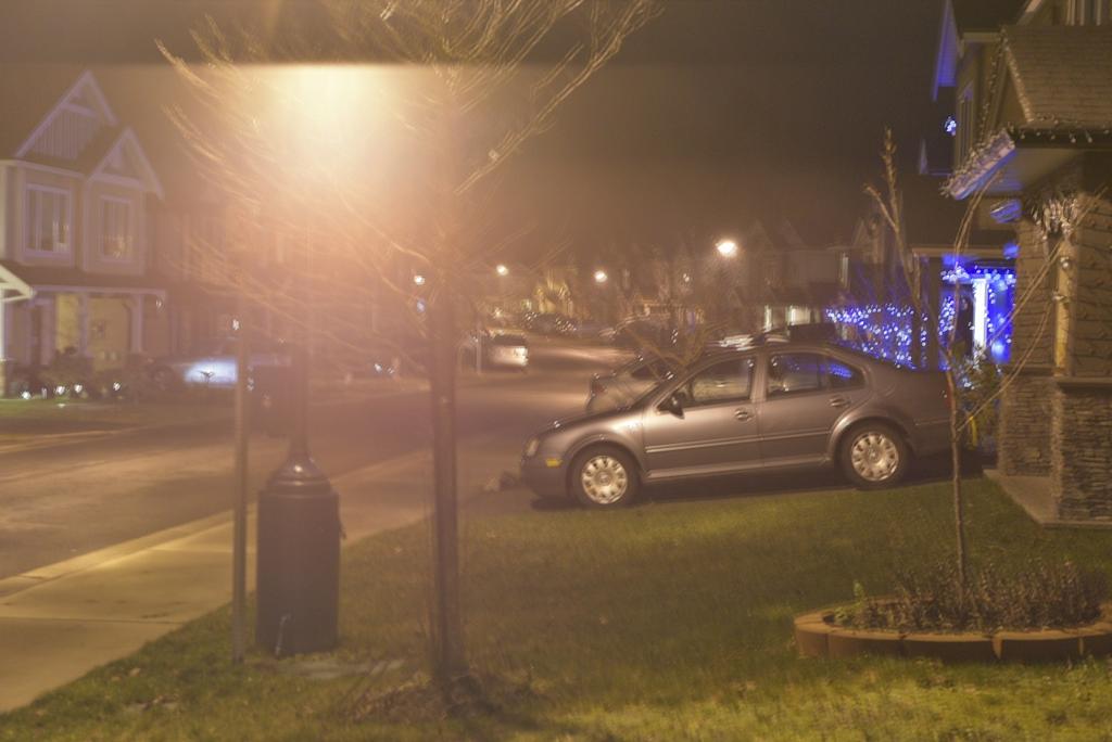

I bought my D750 last week and today is the first time I encounter the "shadow band" problem (photo attached). I'm sure that this is a minor issue and I can work around it, but I hope that Nikon will have a solution soon.

It only shows at a very specific angle when a too bright light source is just out of the FoV. A lens hood or hand just above the lens to block the stray light solves it.

If thats taken with a nikon lens on a nikon camera that i had just payed for i would be well pee"d off,its not like having a bit of flare due to a light source in the frame,to me that is so wrong.

The flare is not caused by the "problem". That would be there with any cam. It only looks like a problem because of the upper band that appears because something internal blocks the stray light that should have polluted that part too.

Looking at your answer ime not sure you understood my post,its the upper band that i would send it straight back for.

I then have misread your reply since I assumed you were talking about the flare.
I fear the upper band is another issue and one many a cam suffers. And not only Nikon. It's almost something that could be considered normal under circumstances.

I was an early adopter of the D750 and have tried countless times to reproduce this issue with mine and cannot. There seems to be a variation in the height of a metering component (IIRC) that causes this and I suspect as soon as Nikon sorts out the extent of the issue and the solution they will make recalls available.
