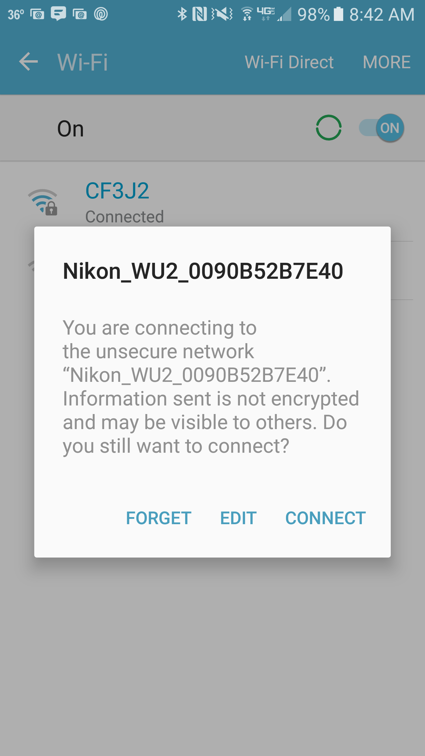

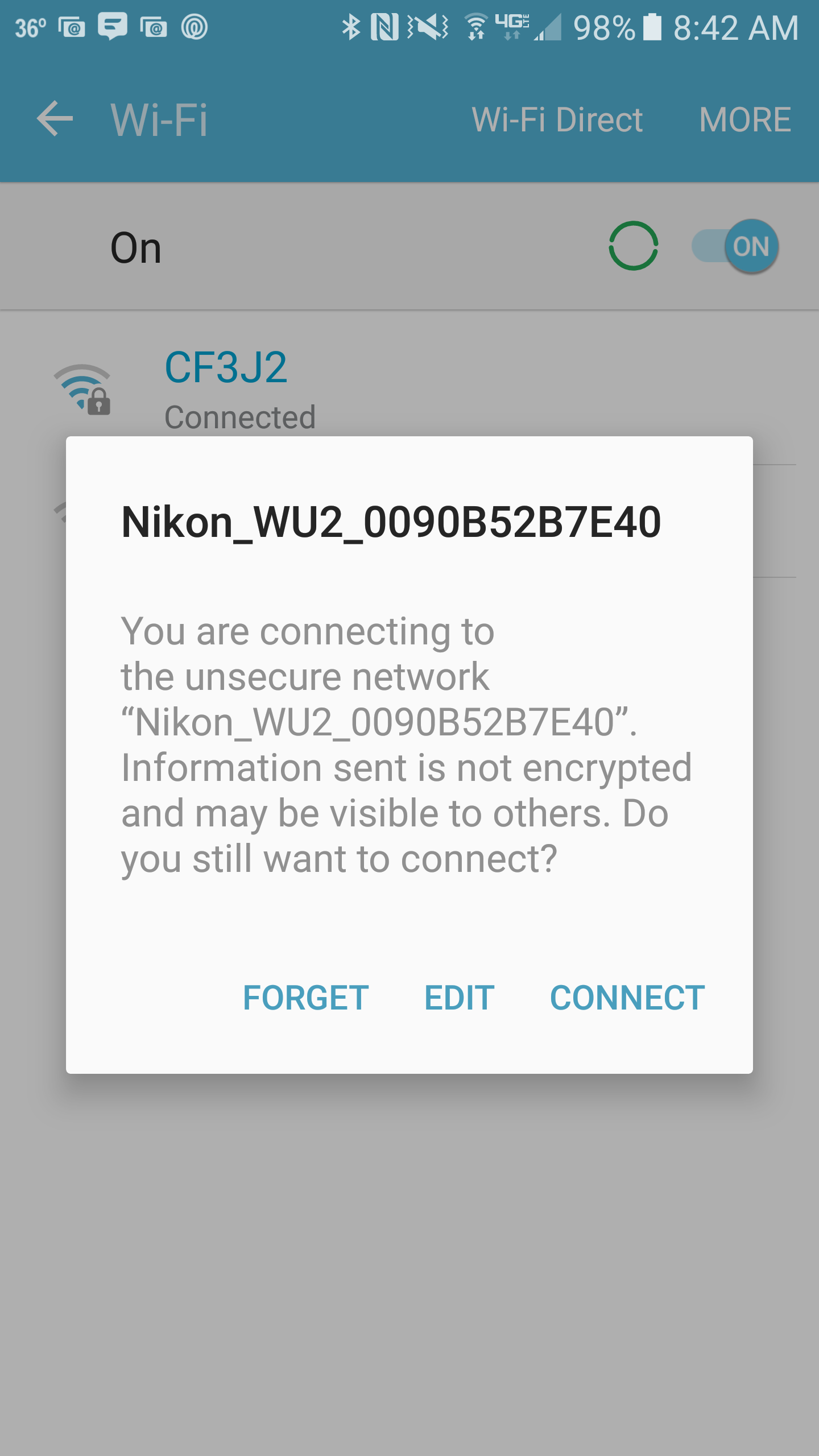

edit: a press gives me another screen, then I hit edit and network is listed as security 'none'. The name is Nikon_WU2xxxxxxx
nickt
Your camera network is probably a slightly different name, but it should look like this when you tap on the nikon network that appears on your wifi screen. If not, the network settings need to be reset in camera. If that doesn't work, resetting the whole camera might work. If not, it might be time to ask Nikon.
