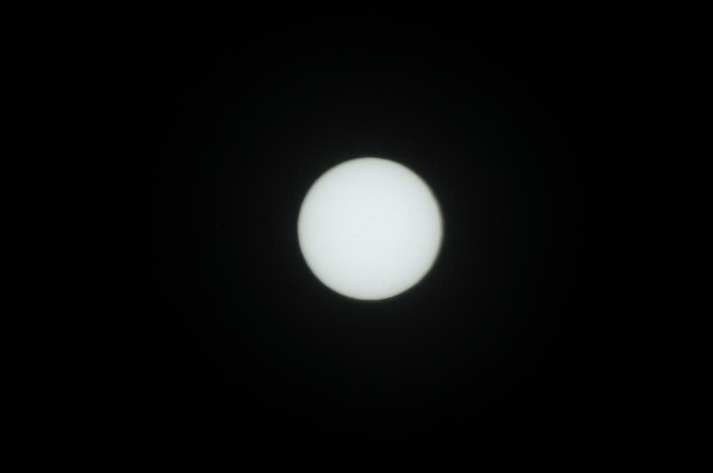

I used a 28-300mm Nikon lens... it's a 77mm filter size. I use Cokin P filters... and have 3 ND filters... I think they're an ND2, ND4 and an ND6... I tried all three stacked, and it wasn't enough. I ordered a 77mm Ice ND1000 off Amazon for $15ish... so I screwed on the ND1000, and then added the Cokins to the front of that...that, theoretically is 22 stops... but they're all cheap knockoffs so I can't attest to their accuracy... I want to hand hold because this lens has VR, and I'm extremely hesitant to lock the camera down to a locked focus position aiming my sensor at the sun... so I wanted fast shutter... I started at /14000... turned my ISO down to lo.1 (iso 50) and started working back from f28... This is on the D600 full frame... This configuration seems to be my sweet spot... I did have to adjust the temp in the white balance in LR to get from a white sun to an orange one... The fast shutter also produces the black background... when I was shooting slower, I was getting some cloud wisps in the image and the sun was blowing out...

Yes... Like I said, I'd been stacking everything, and still getting blown out images... and turning down the white/highlights wasn't doing it... THAT direct sun is bright... I wasn't getting anywhere until I cranked the speed down... which also greatly improved the image quality... Remember 2X the focal length... if hand holding, and your 300mm on a crop sensor is lookin' at 450mm so you want to be at least 1/1000... if my math is correct...

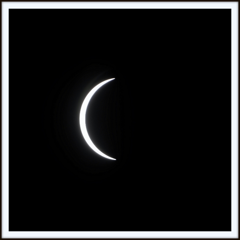

Hand held this shot yesterday. Live view Nikon 300s. 75-300mm/5.6. I also did a test with just the lens. I used it like a magnifying glass. At 300mm f22 the direct sun did put a spot on a leaf and warm to hot on my hand without my filters. With filters on The sun was barely visible through the lens. _NJT3788.jpg

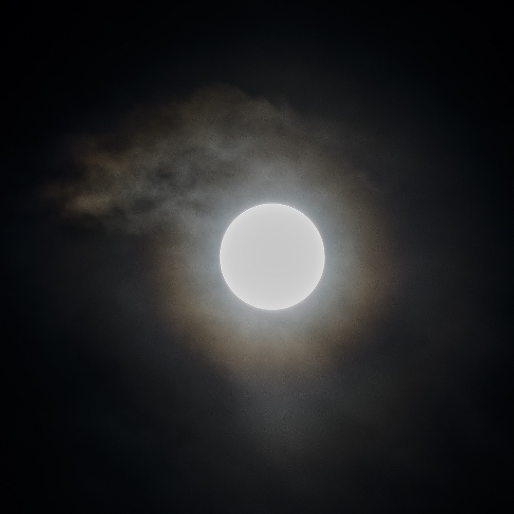

looks like i got a moon shot :-( my landscape time lapse should suck, i did see a change in light but very small (thought it would be much darker @ 90%_1-DSC_2967.jpg
