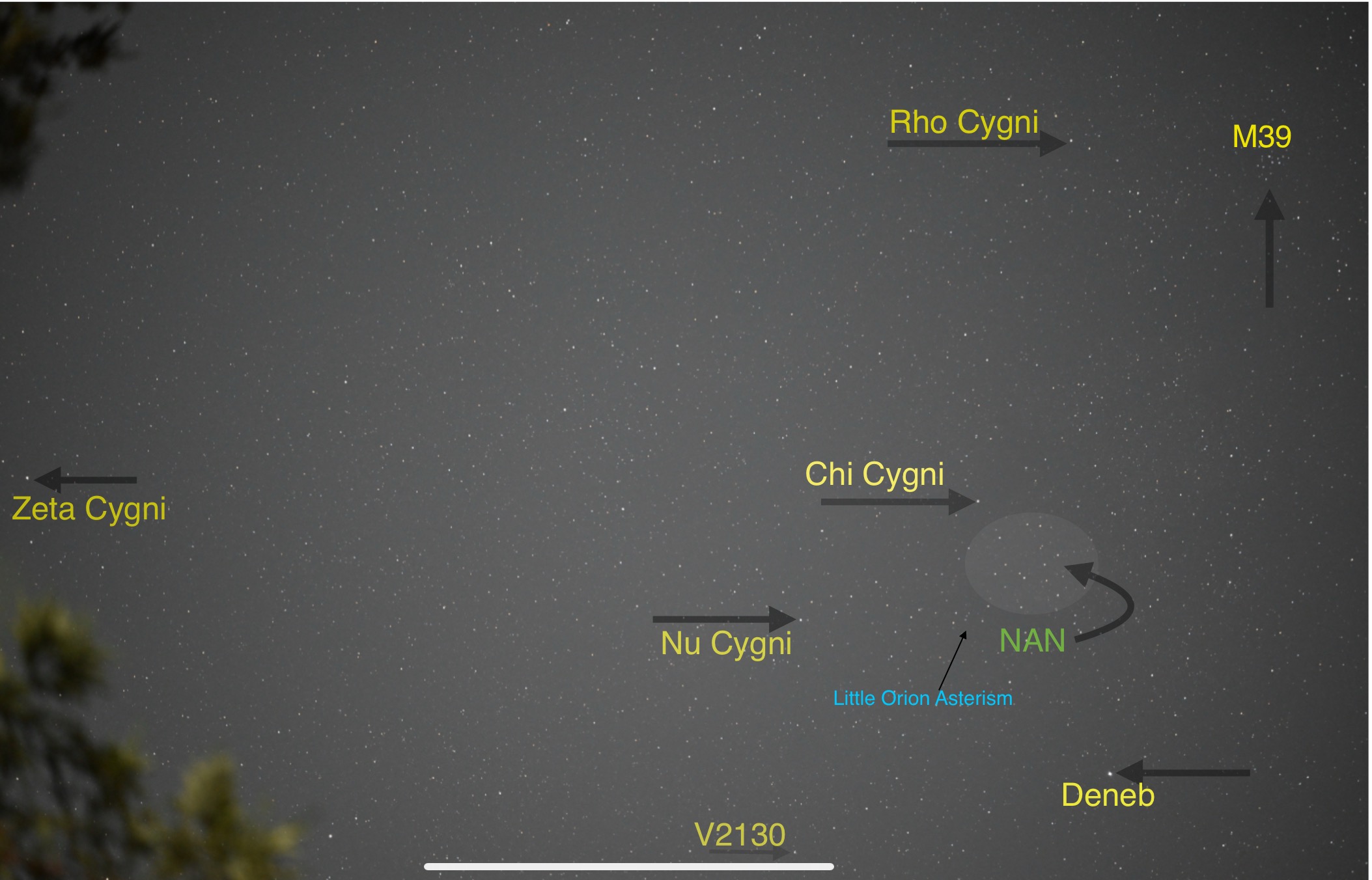

Hey blackstar,
I made a mark-up of your first image showing various stars and where the NAN is located. Do you want me to post it?
blackstar
Hey blackstar,
Sure, it will help. But I am curious that NAN would actually be included in my shot. At most, I can only imagine that NAN was partially included. Thanks
Dawg Pics
This is your first image.
You can see the star pattern where the NAN is located. You won't see the nebula in an image like this because it is too dim. I don't know how many minutes of exposure it takes to make it visible. Anyway, you were in the right area.
You have it in your second image as well. It is up near the top of the frame towards the center.
How do you ID all the stars and the nebulae? Assuming your marks are legit, I see my second image has "Deneb" moved to the frame center, and as you mentioned, NAN moved to the upper. So my original proposal wrongly indicated that Cygnus was the center part of my images, and the bright star was Sadr instead of Deneb? I rechecked with Stellarium and see Deneb is below NAN, confirming your marking. These days, in our area, the sky is all muggy and cloudy. Give me no chance for night imaging. :(

It was a challenge, mainly because I was on my iPad and had to go back and forth between Stellarium and your image. I used M39 to start because it was obvious, from there, I star-hopped and confirmed using the smaller magnitude star patterns. When looking at maps like that, I also kind of sketch out the star patterns to help locate things. That part of the sky is difficult IMO because there aren't a bunch of large star clusters or other things that are obvious. Your image helped me because I haven't been familiar with that area. I am now. 🙂

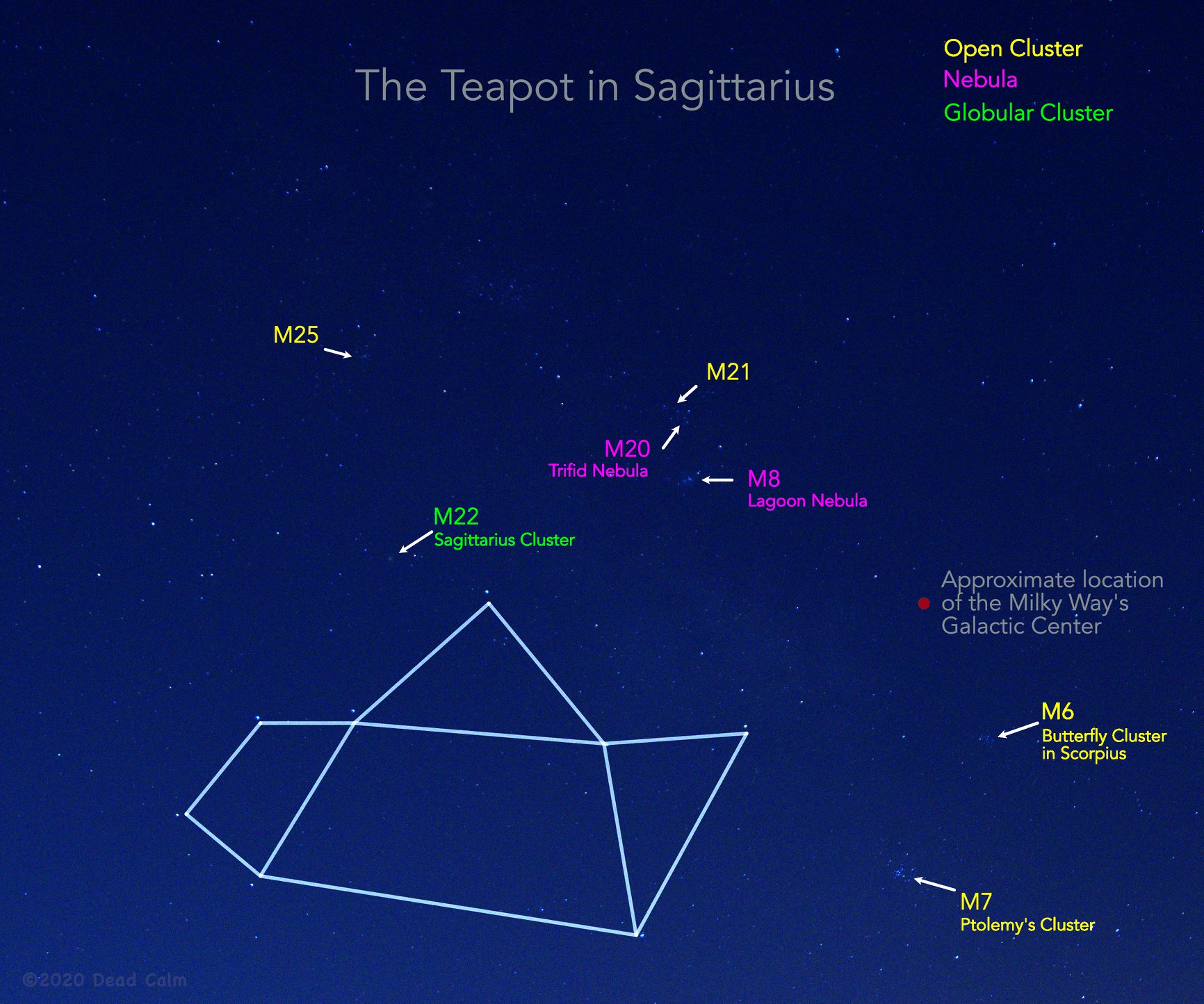

When the Teapot and Scorpius start rising, there are lots of obvious targets in that region, and they show up easily with a single long exposure. I attached an image, which isn't great, that I took a while ago from my back yard. It should have been a longer exposure. I don't remember if I posted it on here. When I get a decent tripod head, I will set up my tracker and take some long exposures of that area.
As far as you question about what you caught in your images, I think when you processed your image you got amplified noise and bloated stars. Your initial image has a nebulous bright center, and I think when you used curves and levels to brighten the stars and darken the background, you got a bunch of artifact. There is a glob in the image I attached, M22, it is a small, dim, fuzzy object.

Since you were interested in Sadr. You have it in that second image. It only took a glance to find and verify it. If you enlarge it a bit, you can see a smudge to its right. That smudge is the Inchworm Cluster. I love finding dim, fuzzy objects. 🙂 I am pretty confident on my observation, but you might want to enlarge and look at the star patterns to make sure.
blackstar
Ok, I see Sadr now. Thank you for the tip. I may try cropping into the Sadr/inchworm cluster region and "level" it to see if any details can be revealed.
