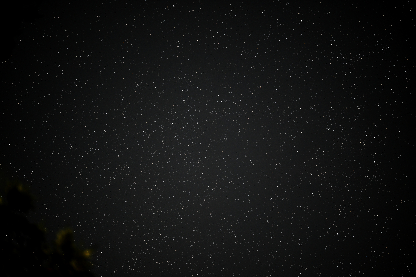

I was experimenting with catching the North American Nebula with z8+z105mm (without tracker). I didn't know where the NAN was exactly in the dark sky but saw it from Stellarium was close but higher than Vega in the direction between W and NW. So I just aimed in that direction and saw massive stars in the frame as I focused into infinity. Took two dozen shots and several Darks and Biases. Thinking of using Siril to stack the Lights and process, but unfortunately, all of the Lights except one are useless due to trails (I didn't think 5" is too long for 105mm). So took the only remnant (which is still with a little trail) and tried to get/save something out of it from Gimp... Surprised! The first picture is the original, the second is processed with Curve, and the third is processed by Level. What do you think I have caught?

A massive vignette.
Really ought to use a tracker on multi-second exposures at telephoto length. This is most needed at the elliptical plane. I did my comet photos without tracking, and at 70mm anything above 1 second had trails. I also forgot to flip off the VR switch so that added to my problems.
blackstar
A massive vignette.
If it is, what does the center part reveal? lol

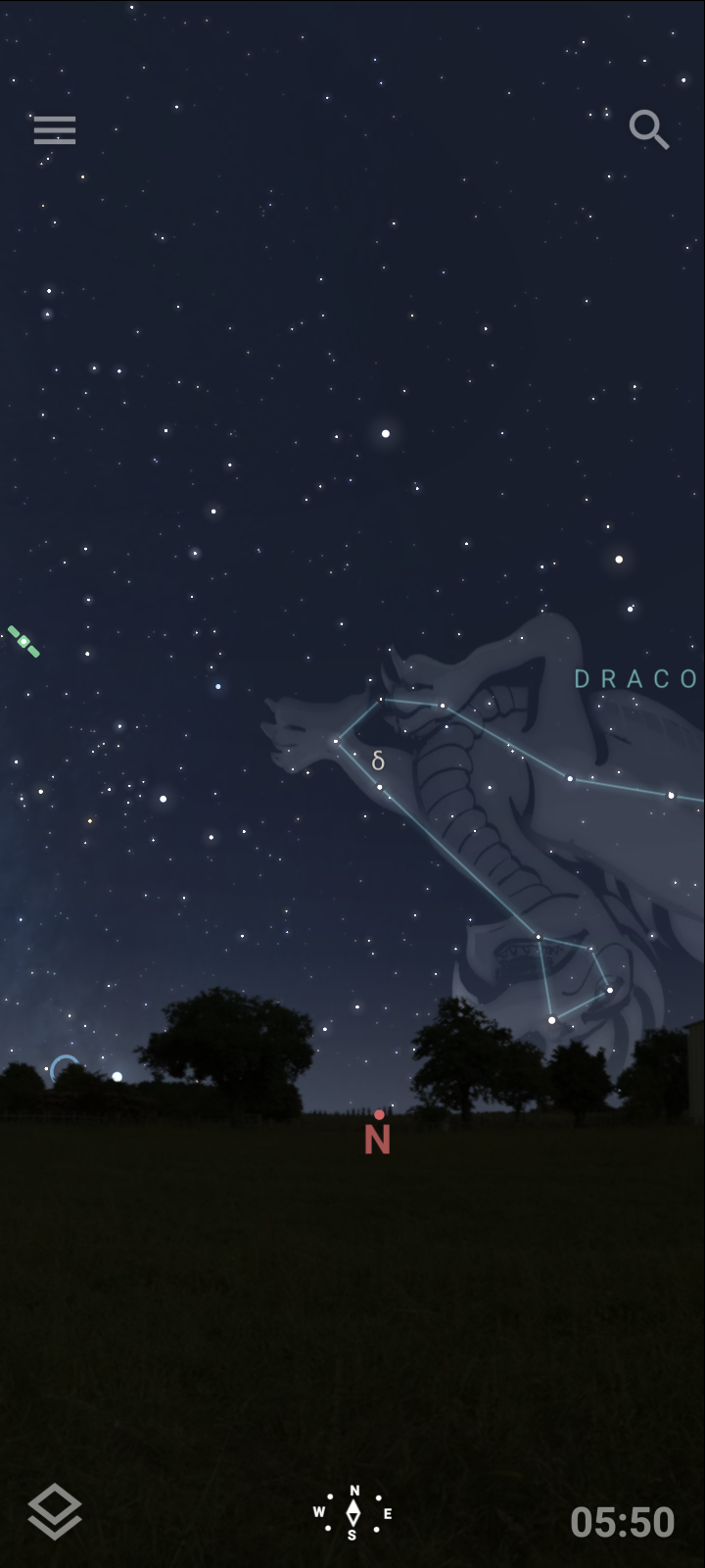

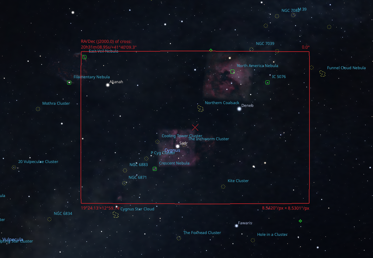

Back on original question: I believe Cygnus is top edge-center and NAN is just off frame up. But it is really hard to pick that out. Had to go back and forth between Stellarium and the photos many times looking for the patterns in photo #1.

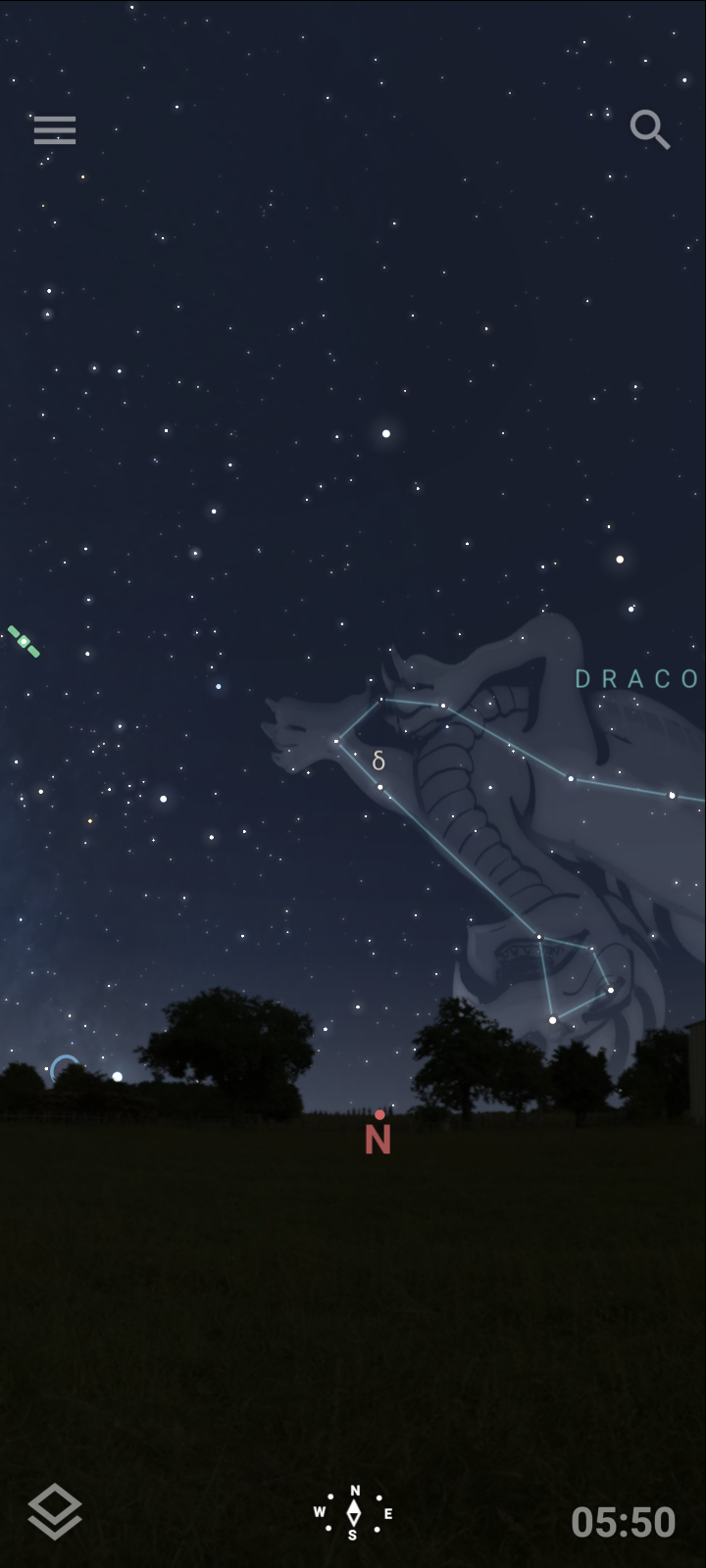

And I just discovered you can point-view Stellarium mobile to assist in live identification. Nice!
blackstar
Wow!!! As you did (going back and forth between SL and the image), I am surprised to see it IS (most likely) the Cygnus/Crescent Nebula which is below the NAN (just out of the frame)!
How? I was excited to hear this. But after hours of research, nowhere, nothing was found to enable my new iPhone 15 Plus to do this. Not even able to open the camera and SLM (Stellarium Mobile) at the same time, if it's required to point-view in live ID. No guide for this was found either... Help needed.
BF Hammer
Look at the bottom of the screen of Stellarium mobile. On my Android phone I find a small compass. I believe I touched it and lingered on that touch a bit and it started moving the view as I moved the phone. Touch the sky and scroll, the tracking stops.
blackstar
Thanks much, BF. On my iPhone screen, the compass is kind of hidden in a tree on the right side of the foreground. Finally, sort it out and get the point-view scene.:giggle:

Ok, I tried again. Still failed (lost focus on stars) with three dozen lights except one. This one looks pretty much the same as the last try except there is strong evidence that makes certain what I had caught is actually the Cygnus constellation (with very little detail though). Compared to Stellarium's image, there is the bright Sadr in front of the center of Cygnus. It does show in the image I caught. I expect it's very possible to image night stars/celestial bodies with great details when equipped with a tracker (in my next purchase list) for multiple long exposures. Here are the images:
