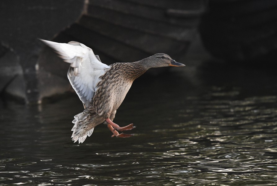

I now dont thinki its stopping down it looks like something is wrong,ihave no idea why it happens to me.
This is from when i was happy with the lens, being wild life shots it can't be two samples exactly the same

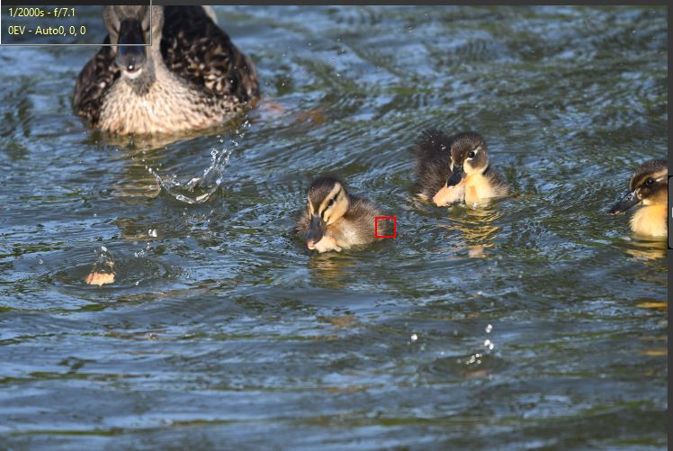

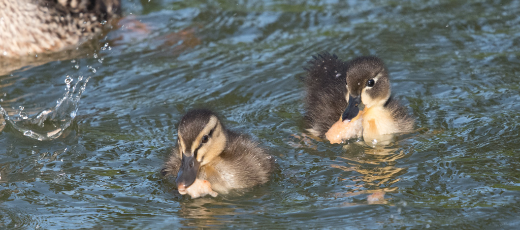

Looks like i may have developed back focus in the camera ,ok i wasnt spot on the front chick but it looks sharper further back,no editing just converted from raw for posting,i would have thought this would have shown up from day one plus stopping down should improve the situation (sort of)
Just thought the first one has had some PP in the sense its a screen grab from view which applys the camera jpeg settings.
lokatz
Nice shot. As far as the back focus goes, you are right: the eye of the rear duckling looks sharper than that of the one in front. Be careful not to judge from a small number of shots, though - there is always a little bit of variance in the AF system

The problem is most of the time you dont get staggered subjects like that,as ime unhappy anyway i am just setting a focus target up,not going with the dock calibrations at the moment just the in the camera adjustments.
lokatz
I do that for all my lenses. It is always a compromise since you can adjust zooms only for one focal length, but works well enough anyway.

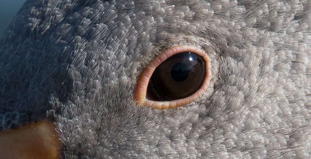

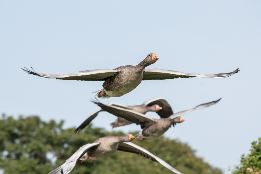

After looking at this shot ime not going to mess around with fine tune,it was great and something has changed so i will try to borrow a different lens for the weekend to eliminate the body,ok i missed its eye but at these settings and focal length, it should be spot on.

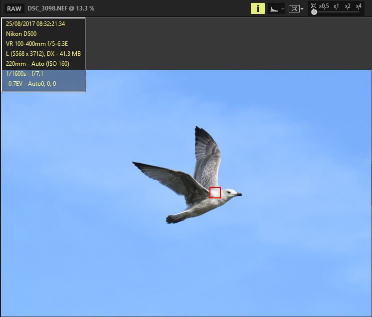

Looks like i have a lens problem,just run through the automatic fine tune as is generally recomended ie 10 shots and record the different values.
I used 3 different targets one for each of the tests the last one was a brick wall in good but not glaring light, tripod mounted stabilizing off, the results are interesting

I didn't bother taking away the two extreme values and setting an average as i felt it was too inconsistent, instead i borrowed a S/h Tamron 150-600. just need to edit some of them but they are worlds better than i have been getting this past week or two.

Dont know if i have cracked it or not,its too early in the morning here for decent light,i put the test charts away and set the lens at what my gut feeling was,hopefully will get some bird shots later.
Why it suddenly devolved such a large back focus issue i dont know but will give it one more chance before it goes back to Sigma,thats the beauty of a three year warranty.
mikew_RIP
Well i think i have cracked it,somehow a couple of weeks ago the lens developed back focus, the D500 auto af tune was driving me spare so i did itby eye.
