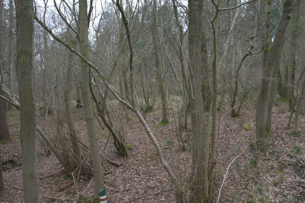

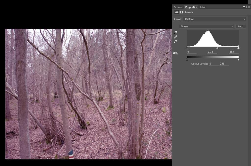

That certainly gets the colour balance right in the JPG, which I can do with the original RAW file after some fiddling. Maybe the colour cast is just a natural effect in the RAW files that I'll have to live with.
Unless there is something specific throwing the WB off. Say multiple colored light sources, than it should be pretty close.
What program did you use to look at the RAW file?
I downloaded the nef file and opened it in Lightroom. What I see is that is looks very overexposed. I had to drop the exposure down to get it correct. Also the small amount of highlights were blown out. All the things will affect the color. I did not see magenta at all though. It was slightly green but it is in the woods so there might have been a small green cast in the woods anyway.
WayneF

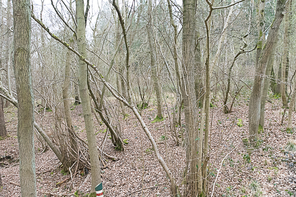

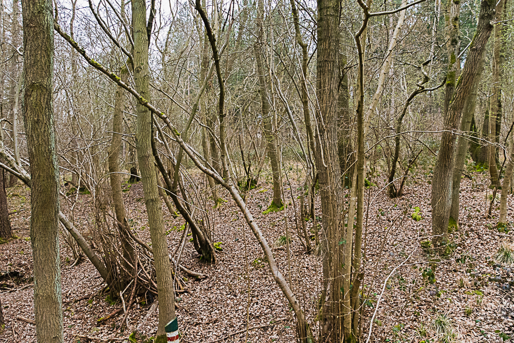

I don't see any issue here. Adobe ACR "As shot" (applying camera Auto WB from Exif) says 4150K +8 Tint, and looks like this:
Auto WB in ACR gave the same 4150K +7.
Then cilcking the WB tool on the white band on stump at bottom gave 4650K + 11 Tint (more yellow, very slightly less green).
Only the white sky at top is clipping a bit, I left it alone, doesn't hurt anything (it becomes arbitrary). You can recognize this area by holding the ALT key and touching the Exposure slider with the mouse. Move the slider up to see where other things start clipping. Here it takes nearly +2.5 EV to start seeing anything else clipping.
Danno
I opened it in LR and did not see the color cast either. It was only over exposed. Below is the unedited file and a file with minor tweaks to bring the overexposure in line.
karlheinz

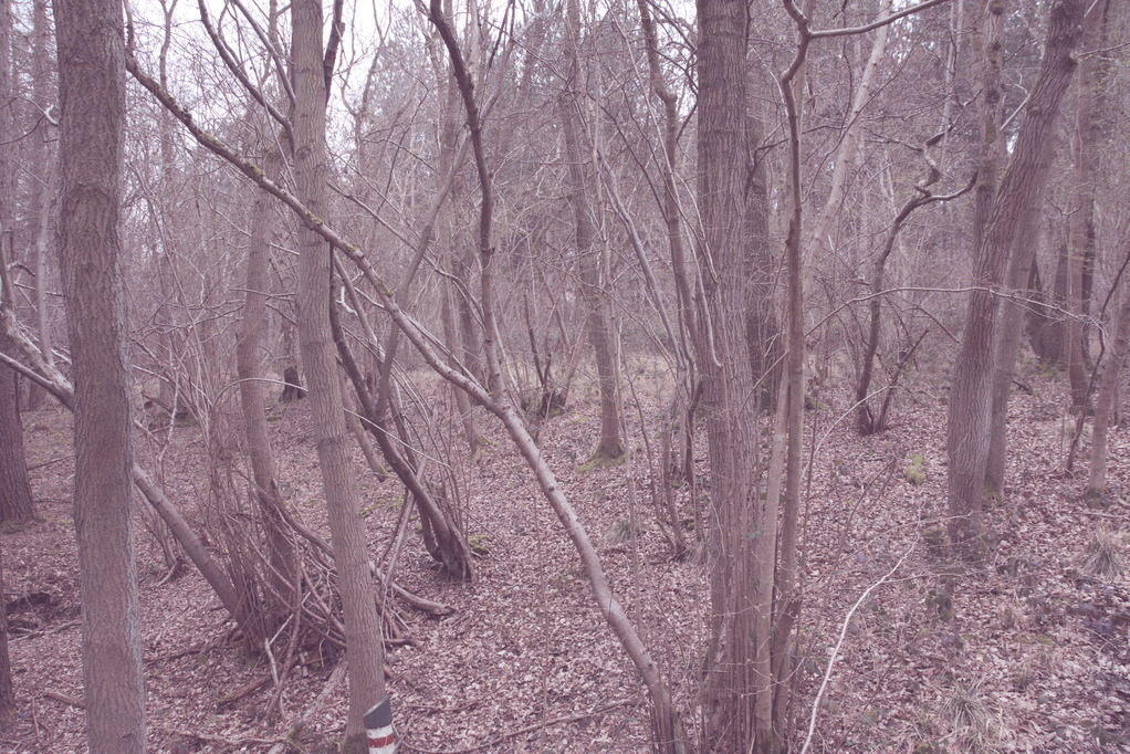

Thanks for the fast reply Danno. I've attached a JPG version which is a straight export from the original RAW file, just resized.
EXIF Data is embedded.
Hi,
I have got the exactly same problem wirh a d7200 and either gimp or rawtherapee.
However, I do also have a d7000 for some time now and the nef images from that camera look close to the jpg right after opening (same programs). Thats a good starting point to mess around with the raw files. The 7200 after opening is so far out in color and contrast i don't bother.
My only currently working linux workaround is to use a newest ( as in compile the source - not from the package management) dcraw. That has sufficiently good calibration data for the d7200 included. I am using that to convert the raws to 16bit tiff which then work in rawtherapee or gimp. I am eagerly waiting to see the 7200 raws working out of the box in rawtherapee...
Karl-Heinz

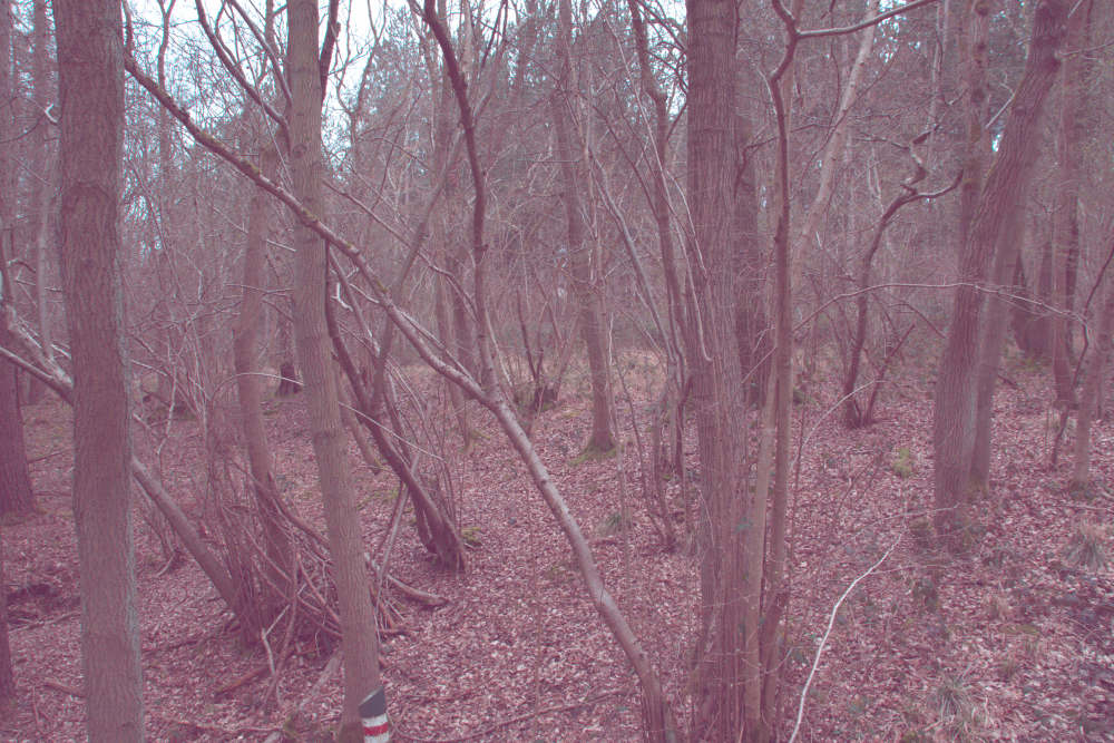

This is what I get with no processing with Darktable 2.0.3 running on Fedora 23.

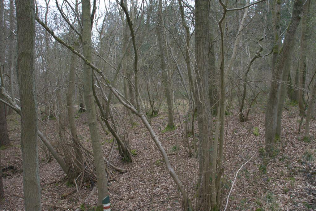

Just tried opening it in RawTherapee it gives this result.
Both on Fedora 23
Horoscope Fish
The raw file is fine, if a tad over-exposed, which means there almost has to be a problem with the raw file conversion process, meaning the software. The raw file opens just fine for me in Adobe Camera Raw here at home if, again, a little over exposed. Easy-peasy stuff to correct and again, the raw file looks to me as it should, prior to processing.
Further, I can duplicate the magenta cast that shows in shot you posted originally almost perfectly (after first correcting the exposure) by going back and over-exposing the raw file one full-stop and decreasing the Green Channel Mid-tones by 25%. Once I do that, I get this:

I'm still digging around to get to the bottom of this, but it looks increasingly as if the issue lies with the Nikon NEF file format used by the D7200.
Just as an experiment, I tried to convert a couple of D7200 files to the DNG format but the process failed with a message saying 'unrecognised file format'. I then tried to convert NEF files from a Nikon D3200 and much to my surprise, it worked!
So then I got a few D3200 NEF files and loaded them into RawTherapee, Darktable and Digikam. No problem. No colour cast.
That looks pretty conclusive to me. It doesn't solve the problem though. I'm certainly not an expert on this topic, but it seems that something in the colour profile used by the D7200 is different from that used on the D3200 (and other Nikons).
Now all I have to do is figure out where to go from here.

The point is, other raw software (Adobe) has no issue with the D7200. It would seem the problem is your software is not supporting it.
Of course, Exif should make no difference if you simply set WB in your software. That is the idea anyway, to set it right.
Horoscope Fish
Sounds to me like the raw conversion software you're using simply hasn't caught up yet. It will probably self-correct, in time, but of course there's no way of knowing how long it will take for that to happen.

The magenta color cast (sometimes accompanied by *un-removed vignetting and distortion) is something I've seen on a few cameras from several brands (e.g. Canon G1X2*, Nikon D7200) when opened in certain apps (e.g Picasa 3) which are not familiar with the specific RAW implementation. In those cases, the RAW file has worked well with the software bundled with that model of camera.
However, if
- you have an older version of the software that came with an earlier model, or
- you're on a platform that doesn't support the bundled software, or
- you're trying to open the RAW file in the editor of your choice,
you may encounter this. Anytime I see magenta I assume that software is not familiar with the camera's RAW file before I worry about the integrity of the RAW file.
