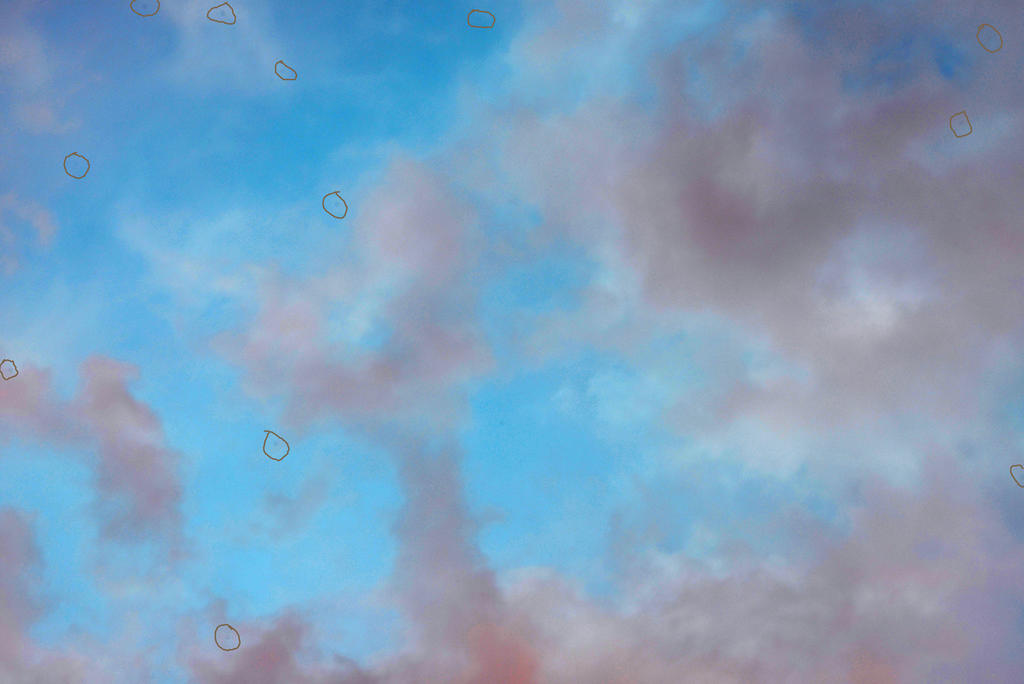

Yes, I also took f/16 but will retake both f/16 and f/22 when I have a plainer background. My point is this is just a few shots after getting it home. What will it look like after 300 shots? It certainly shouldn't need a wet clean THAT often.

hark, I'm sorry to read about this. But I have to say, the same thing happened to me, and this was the moment that made me decide that I cannot use my D600 in its current state.
I had wet cleaned the sensor diligently once again, and there was not a single spot left on it. I took a test shot - clean. I went outside to take a picture half an hour later - and had a big dark blob in the picture. And that was after already some 4000 pictures taken with this D600!
That was a little over one week before my vacation, and I really could not clean the sensor every day or even several times per day while travelling. My solution was to buy a D800. I've cleaned the D800's sensor once since then (after 5 months), but it was just dust, and just one speck, and I change lenses a lot meanwhile (on the D600 I was using a zoom, now I use primes).
I know some think our complaints are exaggerated, but I know how you feel.

It boggles the mind, to think that they shipped it back to you with what you just posted. It looks worse than ever! I sincerely hope that at this point, they give you a refund. I think it has been mentioned previously on this thread, but have you looked at the lemon laws for your state?
hark
The issue will be forwarded to corporate. They want me to submit an unedited photo which I hope to do within the next day. I took a test photo at the church this afternoon taking advantage of their white projector screen, but I haven't yet loaded the files onto my computer. I followed Marcel's directions, but my lens didn't have the f/16 marked on the lens to line up with the infinity mark (it only went up to f/11). I'll be checking the photos later tonight and see if the photo turned out. :)
