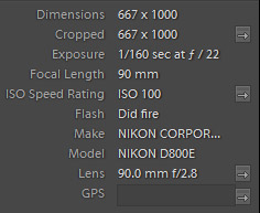

Let me try something. I imported Scott's shot with the faulty EXIF in LR 5.7 and then exported again.
I'm curious.
Yes it would work because the the model is written to it already. It just doesn't show up here when exporting from the new LR. I did the same as you except I imported it to the new LR.
Blacktop
It's not the site that causes it. We see the symptoms of a bug in LR6.
If it is only happening here, it's probably too freakish to expect a fix soon.
As someone said earlier. it's a handshake thing. Why else would it work with Flickr and not here?
J-see

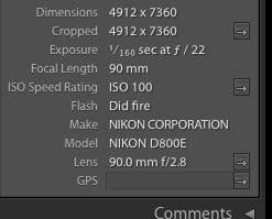

It sure is a strange bug. I checked 5.7 if I could maybe tweak the metadata but there's no option to adjust make or model. Is there one in the 6 version? If, maybe there something can be done.
J-see
How does the metadata section in LR 5.7 look compared to my earlier screen shot?
It looks normal. I have no 6 to compare it to but when comparing your shot against any of mine, the meta is the same. It's likely just some code that needs a different value.

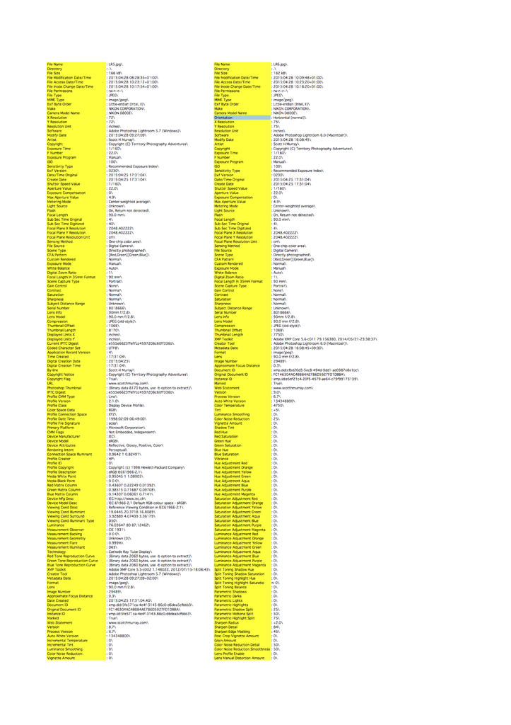

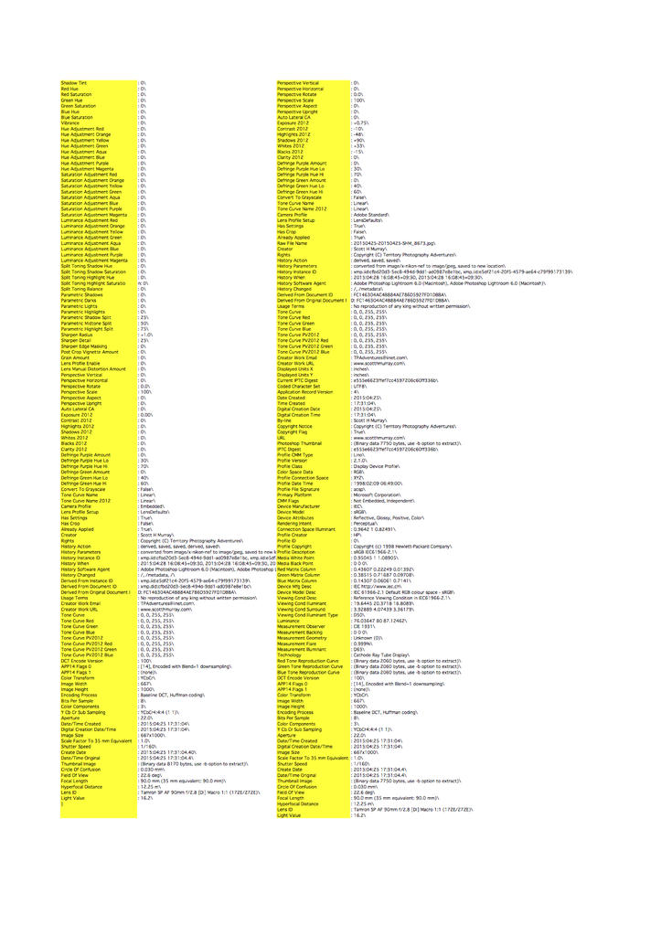

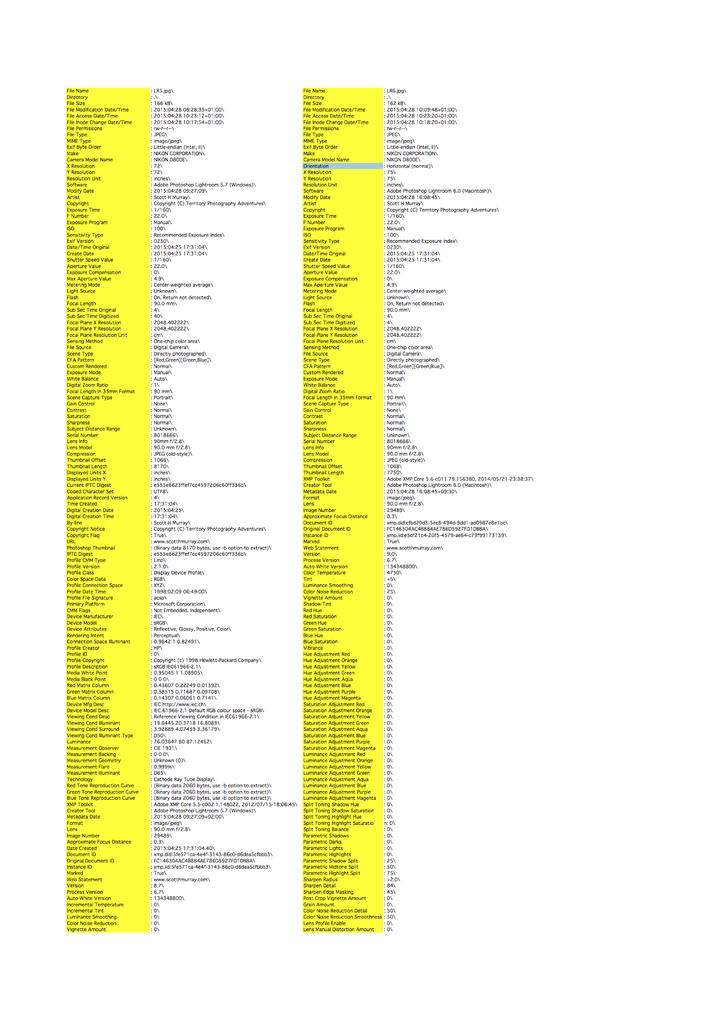

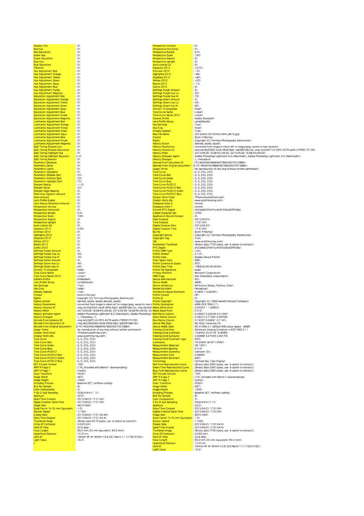

I have just used a program called exiftool to display the detailed exif data in each file.
Attached is a converted pdf file which I hope shows the differences between the two versions of the same pic Scott posted.
there are some interesting variations but the camera model and make sections are identical. It was a pdf but have to export as jpgs for it to load here .
Sorry for small print. Download and enlarge to view.
Page 1
page 2

Ok from what I can tell the software here is reading the Make section and not the Model section.
@jdeg any ideas?
I'd have to look at the raw exif data on each file, but I bet CC is inserting a line return or some other character after NIKON and before CORPORATION. The software here is confusing the model field, probably because of the way it reads the delimiters.
