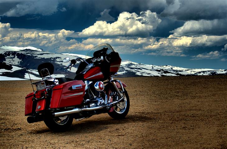

Thanks, Here is my last set of bracketed shots from today with some tweaking.

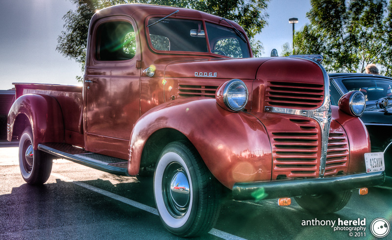

My observations on HDR is that when done right, it should have a 3 dimensional ink drawing feel to it that is so precise and detailed with lines that are too perfect for an artist to be able to master so that the viewer has to ask themselves if it is a very talented drawing and never wonder if it is a photograph.
Photo legend your picture is a perfect example. The curvature of the fenders makes the truck look like it is a monogram or raised lettering. But the power lines in the back ground are details an artist would never draw. In my opinion the colors are too bright / bold which gives it the dreaded over processed look. If it was done in black & white or the softness of a chalk, it would be awesome.

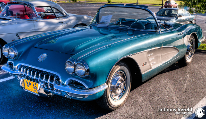

More than anything else, HDR should add depth and detail. This is especially apparent with the paint on cars. Even the absolute best controlled studio lighting is unable to reproduce what the human eye can see in broad daylight on a nice paint job. HDR, however, can:

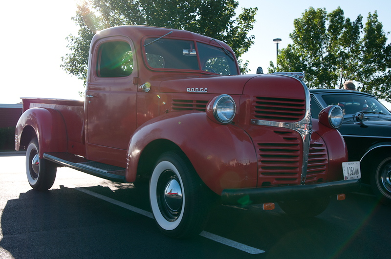

Now, compare the above to these below. These are the base "0" exposures of the 5 bracketed series compiled to make the above HDR photos. Note how flat and lifeless they are?
KWJams
That's what I am talking about! :cool:
The HDR version of the Vette is what HDR must have been meant for.
When you look at something breathe taking like that picture is and you think at first that it must be an airbrush mural, and then you start noticing the depth and details and have to question yourself of just what are you looking at?? That is a successfully developed HDR image.
I like the way HDR rendered the lens flare on the Dodge. :cool:

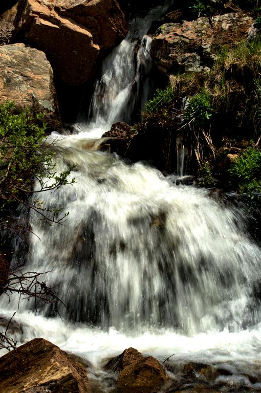

The wife, myself and our little girl Koko took a ride today up to the top of Beartooth Pass.
It may be over cooked a little but it sure has the ---WOW factor going on.

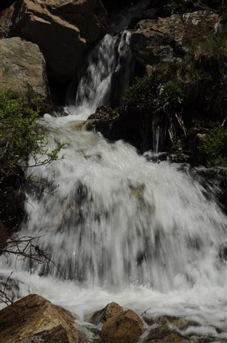

KWJams
Yes a slower shutter would have helped for merged images, but is was just about right speed for a single image.
I wasn't trying to get the silky / cotton candy look. I wanted the water to look wet and freezing and not lose the foam at the bottom. When I merged the 3 together it resulted in the choppy look.
f/22, 1/30sec
ThePhotoLegend
If you utilize PS CS5's HDR merge than you can choose to "remove ghosting" and it does an excellent job at creating the effect on moving water you are looking for.
