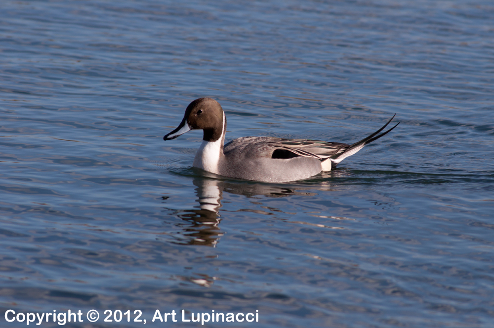

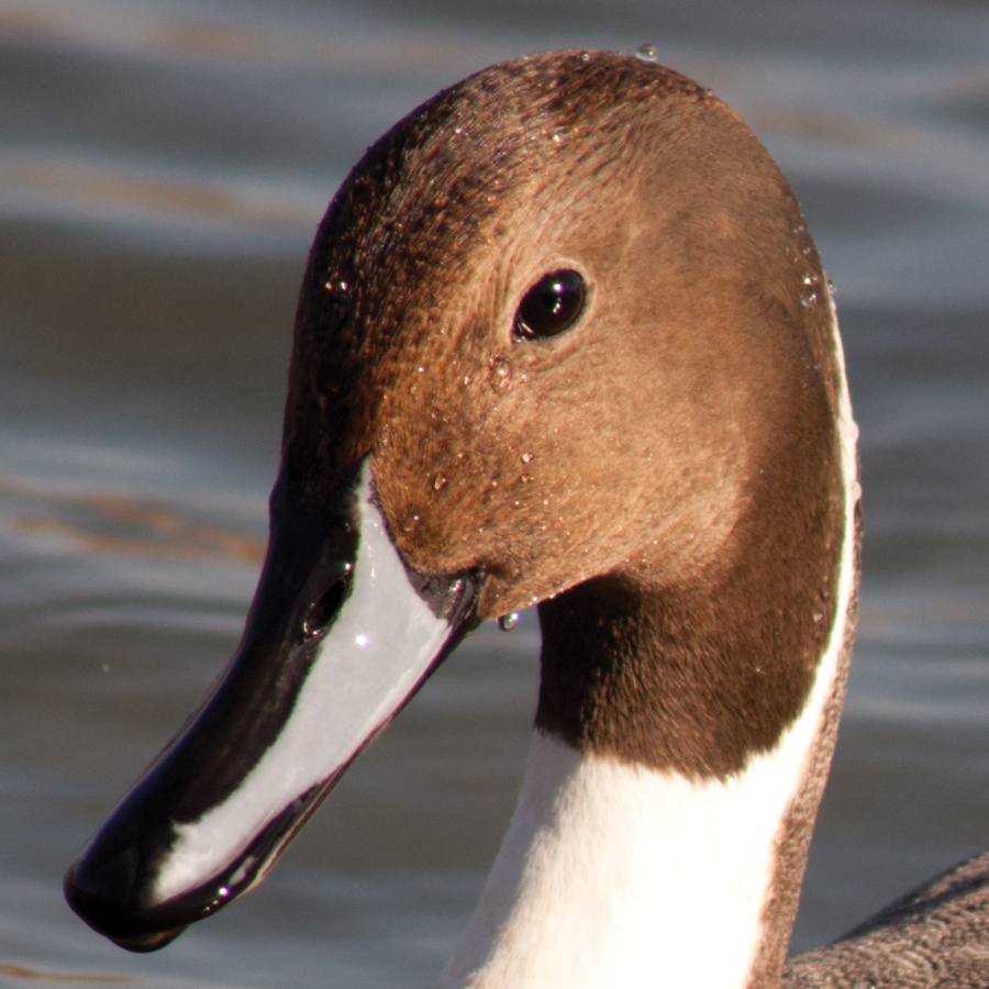

This is a "typical" picture I take. More times than not, I will shot 100 images and maybe 20 are crisp and sharp. Typically, this would be the majority of shots. Check the eyes!
The first image was scaled to 1000px
The second image is cropped at 100% so you can see just the head.

Here is another example at 100%.
Seems like the very ODD time, I get one that is really crisp.

what were your camera focus settings for the first duck shot? How many active focus points were you using? AF-S, AF-C ? What was the shutter speed and aperture? It looks like maybe the focus engine got fooled with the reflexion of the duck in front of it. The focus is looking for contrast and the eye of the duck was in the shade (not in your second example). Maybe if you would use only one focus point.

Here are the specs for the first image:
D90
300 f/4
ISO 200
1/1000s
f 7.1
-.7 EV
Shade
0,0
I used a single focus point on the shoulder of the duck.
Focus Mode: AF-S
AF-Area Mode: Single
Metering: Spot
Shutter Priority
Sharpening 4
Contrast and Brightness: Active D-Lighting (high)
Marcel
Happily retired
It looks to me like the focus was done in front of the duck's head. The water seems to be more in focus in front of the animal… There might be a problem there but I couldn't tell you what exactly. Could be the lens that needs adjustment of the body??? Sorry not to be able to help more. Let us know if you ever find a solution.

maybe the duck was bobbing about slightly on the water? not uncommon when shooting wildlife. small birds are worse as they move incredibly quickly. the slightest noise or movement near to the creature makes them instinctively move their head. also, when shooting wildlife i use singlepoint, AF-S, plus the highest shutter speed i can get.......good luck!

All elements being equal, I think the equipment would render the same result, either all good or all bad. Something is different between the shots (in my opinion). I sometimes have soft shots with my D3100, somehow I can always trace it back to me. Generally when folks have equipement issues, the problem is consistant.

Well, at 1/1000s, I could have been doing the jitterbug and I am sure I would have frozen it solid.;) After reading the comments on this thread, I suspect it may be an "issue" with the D90 and I am not alone.
I have long suspected that the focusing is off slightly on the camera. I know it can take really sharp pictures, just that it does so inconsistently. I tested for dust, all the tests show no dust. I wipe the contacts and they typically look clean, so I don't believe it is that.
I may bite the bullet and take it in to Nikon and pay the $150 for a thorough cleaning and adjustment and see if that fixes it.

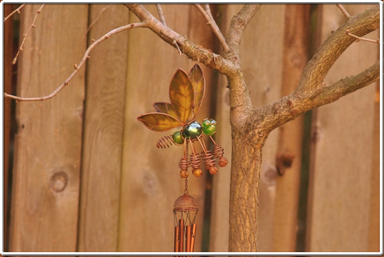

How does this image look to you? Took this at noon today from my deck. I put the centre dot on the middle marble of the dragon fly wind chime.
Your comments welcomed. I didn't take this for composition, just strictly to test the focus.
D90
Nikon 300mm
f 5.6
1/800s
ISO 1000
Shutter Priority
AF-Area: Normal
Meter: Spot
0EV
Focus Mode: AF-S
Tripod
Remote Release
I am wondering, what if I used AF-C???

At this size it looks good, especially if it's raw. Sometimes Active D lighting can produce inconsistant quality, if its on (default on some models), might try turning it off, just a thought.
Marcel
Happily retired
I find it a little hard to see in that small picture. Could you post a 100% crop of the dragon fly so we'd have a better chance to give a valid opinion? Looks sharp to me as is, but a crop would say more.
