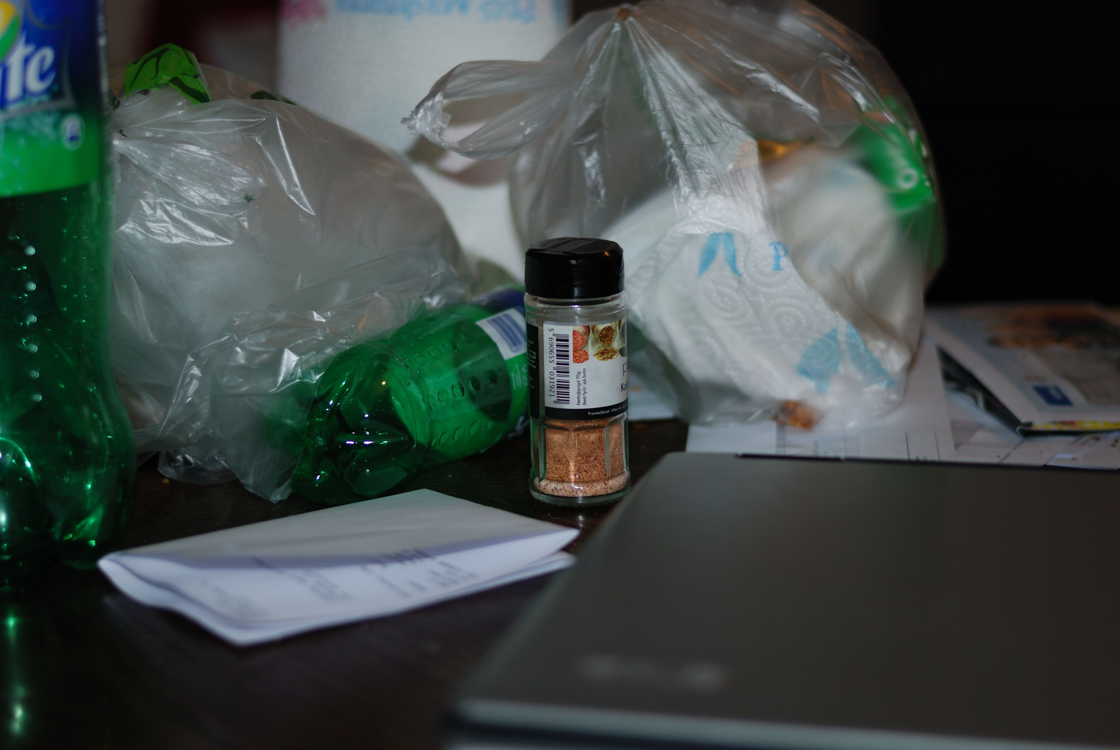

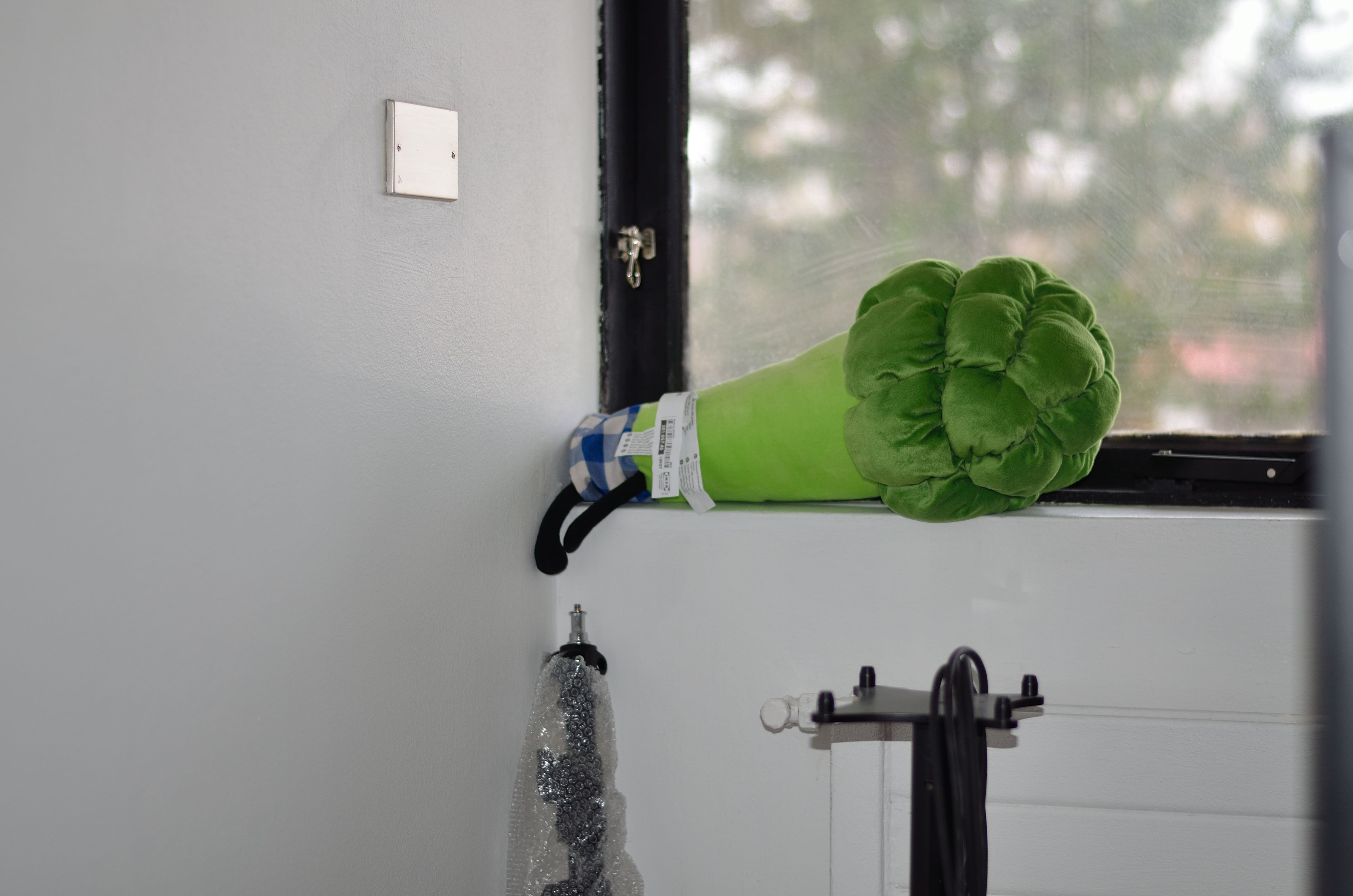

Hi James, I didn't have much time to fill in my profile but I will do that. My name is Stefan and I come from Iceland, I was one of the first to get D7k in Iceland. Probably won't do that mistake again, that is to be one of the first.
I need to go over my photographs I made soon after I got the camera because I don't think it was this right from the start but has rather become worse and worse. However, I will need to analyse that further.
What has make me quite angry is how these issues seem to be handled by Nikon (not at all) or other people which were more lucky than us who got bad copies. People who got good copy just don't believe the problems or simple write them off as user error.
It took me weeks to accept that my copy was bad, probably I should have quit testing after few days but due to the discussions online I kept going testing. Which were obviously waste of time!
I will post photographs here - thankfully I didn't need to throw all photos taken by D7k but the throw away are probably around 50-60% due to the issues.
If my D7k will come back repaired then you will maybe see new photos... but I will probably be without next 3 weeks because of these problems.
Like I have said, D7k can deliver super-sharp photographs when it works properly. So it is not all complaining from me. :)

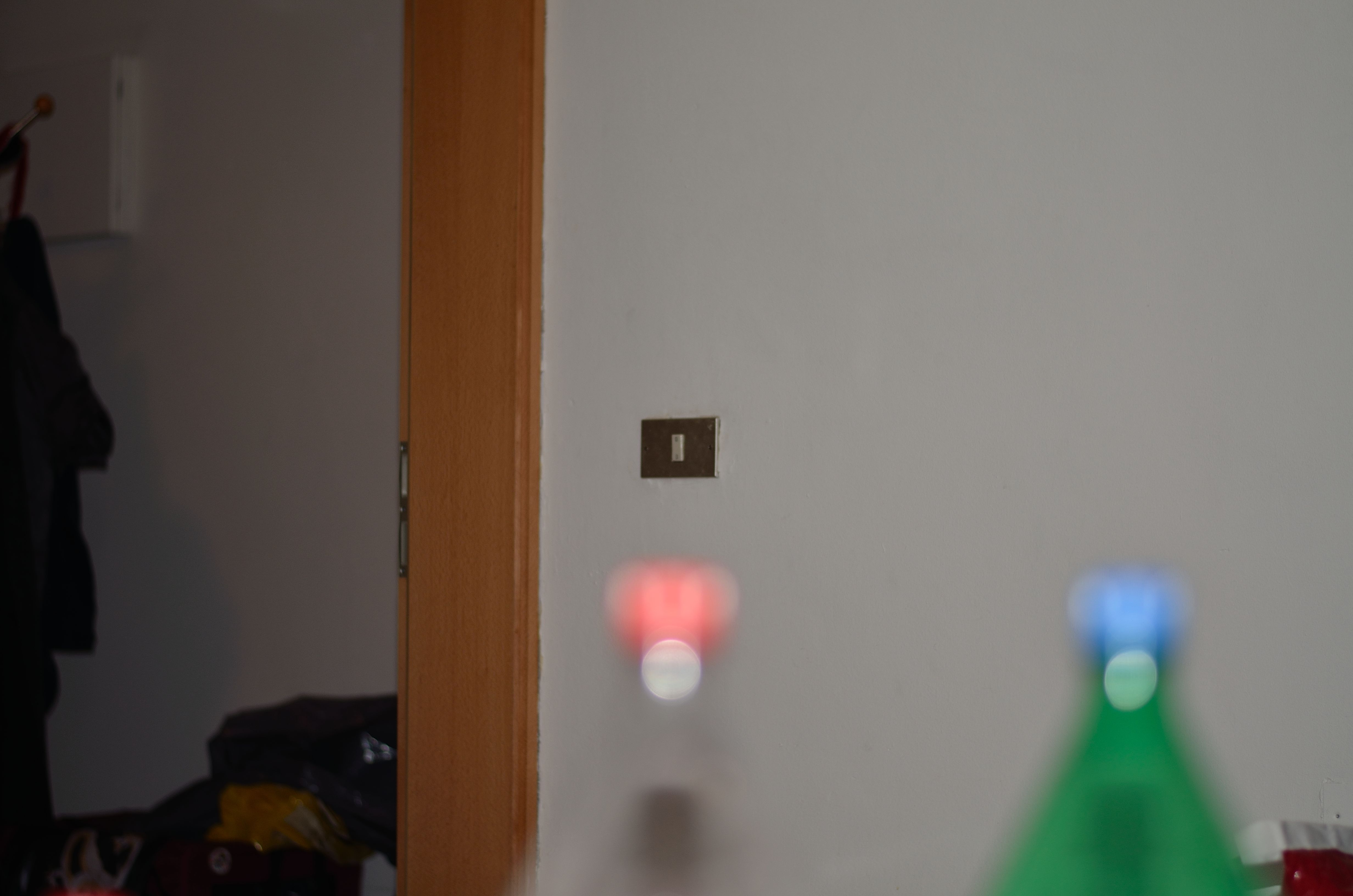

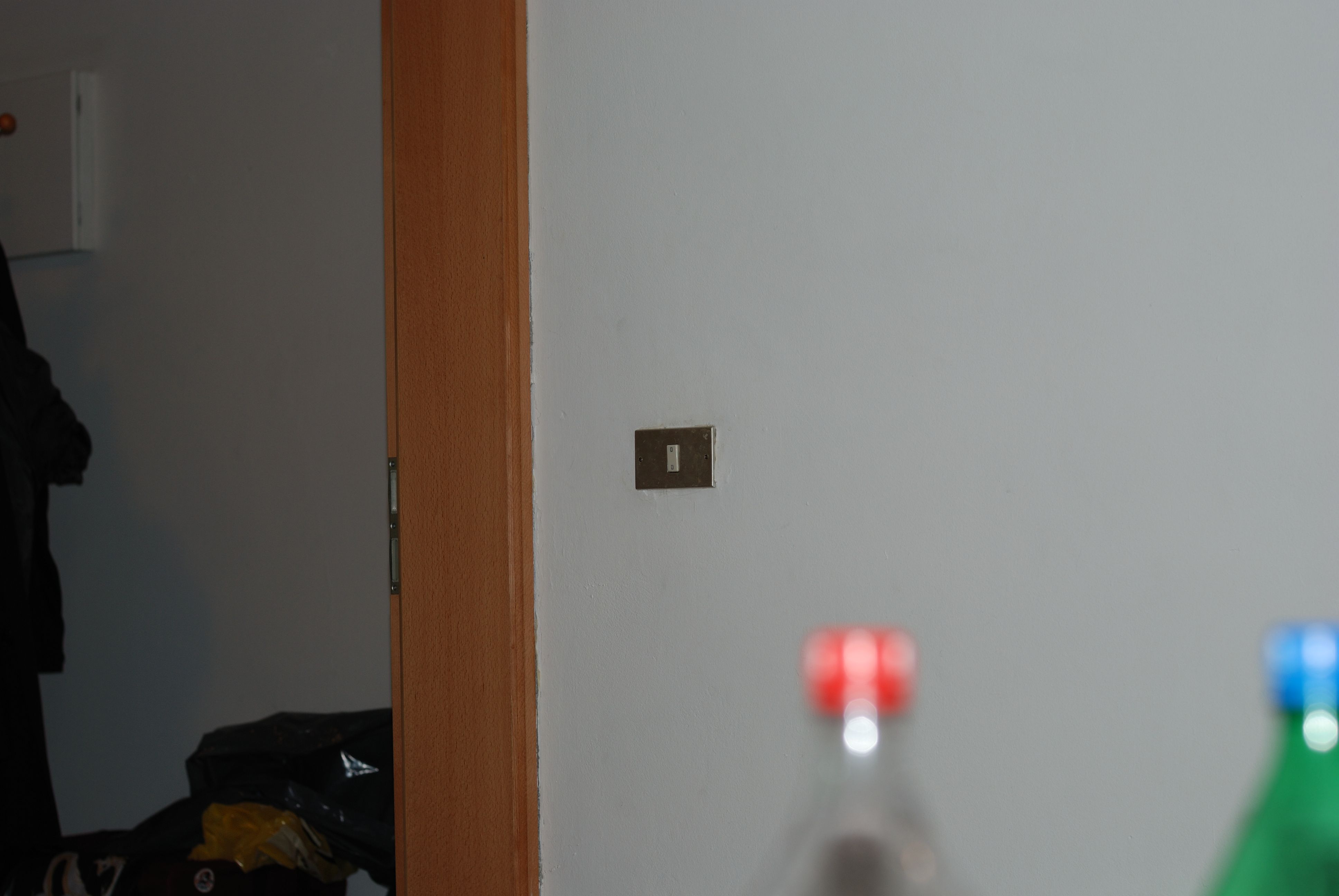

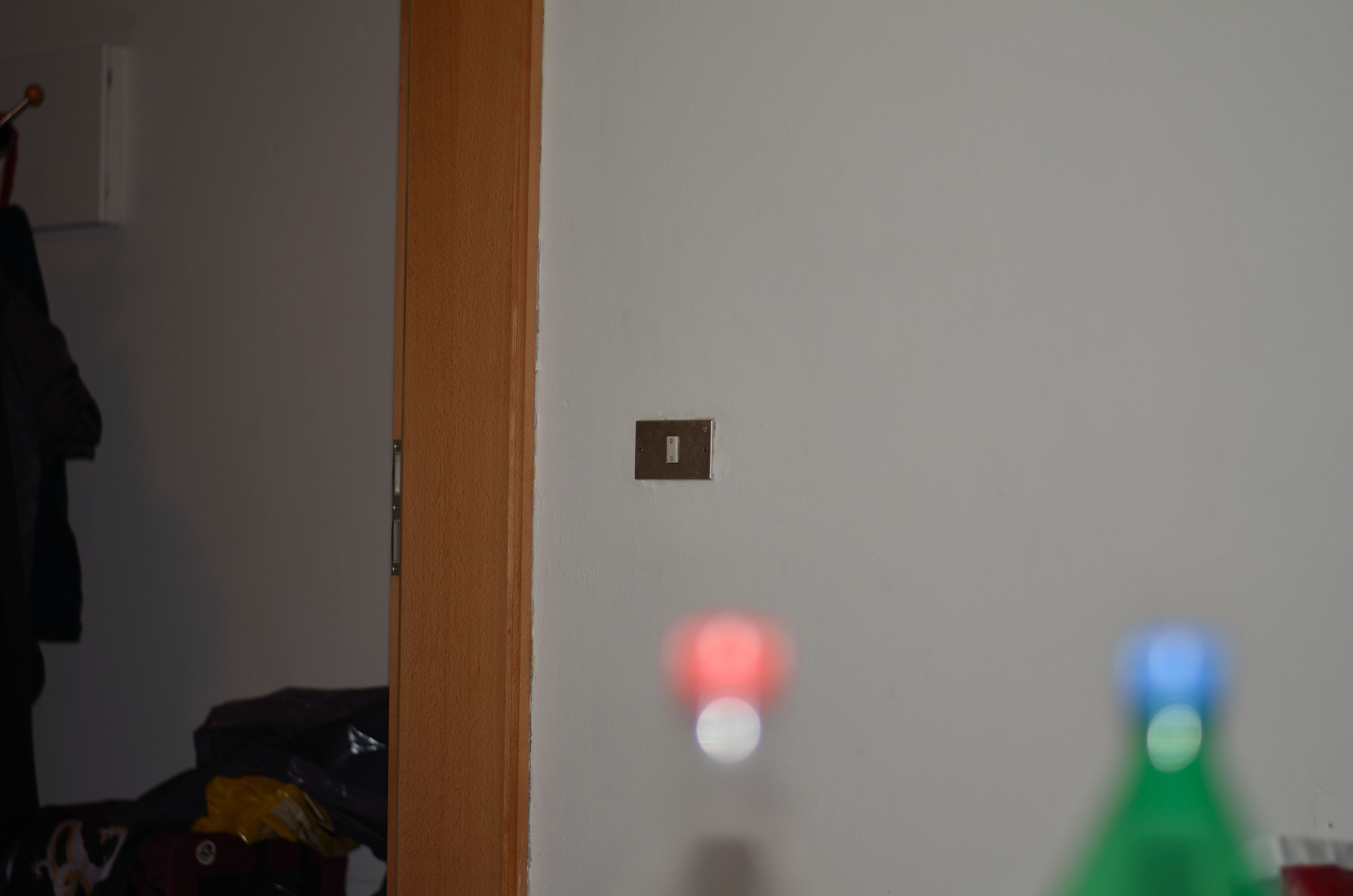

Oh no... it is starting to behave strange again. :( Autofocus on the light switch in the center of the pictures.
Correct:
OOF:
OOF:
What do you think about this? For 1 1/2 hour after I received my camera back it was great or at least acceptable, now I'm starting to get this. :(

Stefan, there are a few things I suspect could cause this behavior.
I notice that these were taken using the flash at 1.8. This makes me wonder if there was indeed enough light AND contrast for the focusing to be efficient. NO CAMERA can focus in darkness or when there is not enough light and contrast.
Second is the setting AF-C that you are using. This lets the focus wander around until the shutter opens. I would try the same shots using AF-S, single point, making sure you either depress the shutter half way long enough for the focus to acquire it's subject.
These are the suggestions I make and maybe… hopefully it can help you get sharper shots.
And sometimes there is no substitute to manual or live view focus. That's how all the great shots we see from the new D800 were done anyway. All these super sharp pics are NOT just snapshots. Don't forget that.
Falcon1
Thanks Marcel for your comment. I have however also tried AF-S (focus light on) and it is not much better. The strange thing is that it was ok for some time (in same light/contrast) but all of the sudden it started to show its bad face again. Now I expect some focusing errors, this is consumer body after all, but it is too high percentage of failure.
In some photos it is almost like it is smearing the outlines, I don't experience this at all with my D80 and I had no problem handhelding D800 (it was sharp, sharp, sharp) when I got to try it in a camera store here in Iceland.
Will test it outdoors again later today... I get to depressed trying it indoors. :(
