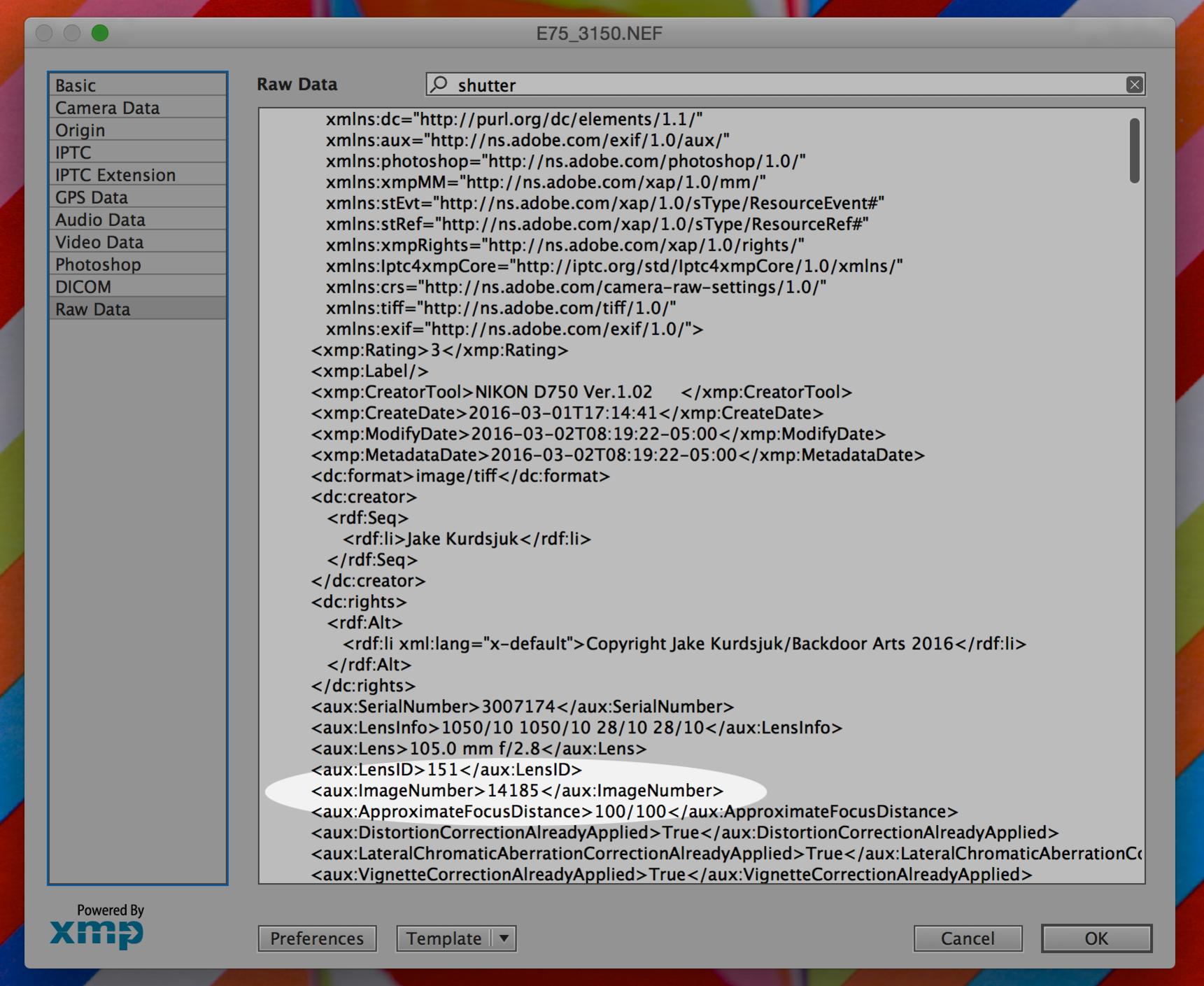

Shutter count is contained in the firmware and not within the shutter and it is not reset when the shutter is replaced. If you send it in for service and want to know how many clicks on a new shutter, open the first image you take with it in Photoshop (or PSE). Go to File -> File Info, and then to the Raw Data tab. Scroll/Search for ImageNumber and the number found there will be the starting number for your new shutter.
BTW, this is a lot faster and a lot easier than uploading a shot to one of those shutter count websites.
I used PSE to check image number the way you suggested for the photos I've taken before and after I sent my camera for the new shutter replacement (in July 2015) and the numbers are sequential, meaning the shutter count as well as the image numbers are not reset. However, since I use sequential numbers for naming my photo files, I know right away the shutter count without using any fancy tool.

I'd like to add one more detail: after replacing the shutter the technician made more than 100 clicks to test the new shutter. The numbers are confirmed by checking ImageNumber with PSE.
