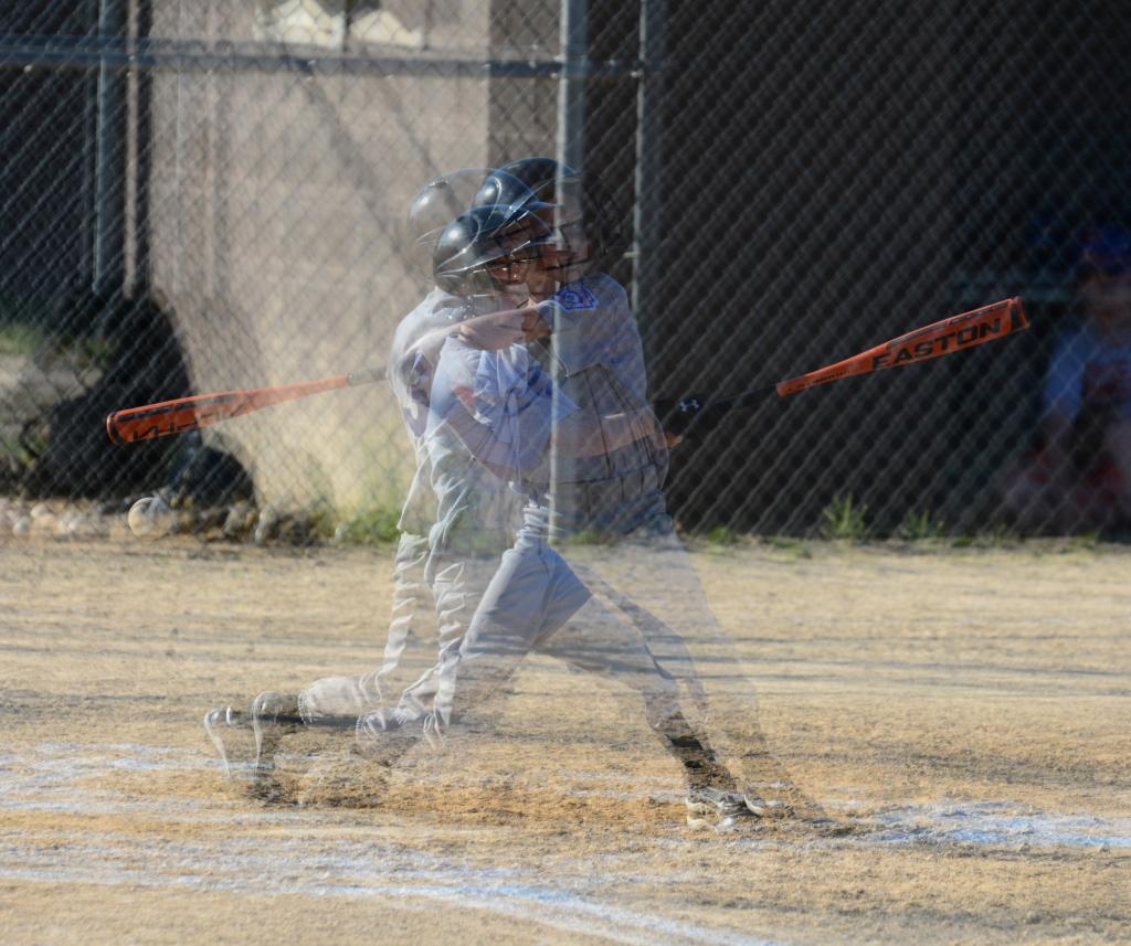

Hi, my name is Frank. I have been a hobbyist photographer for almost 40 years. I recently sold my D90 to upgrade to the D7100. My favorite shooting subjects are my 6 grandchildren. I love taking continuous action shots of the kids in their sports endeavors. Yesterday, when I used the D7100 to shoot my youngest grandson batting at little league I came up with some very unusual shots. Instead of getting several shots of him swinging the bat @ the ball, I ended up with single shots with MULTIPLE exposures...........and I don't know why!! I never had that problem with the D90, but didn't have all the new settings the 7100 has.
My settings were: Shutter priority mode, Ch, APS-C, 6-shots per actuation, auto ISO, auto WB, and a shutter speed of 1/640. If anyone can tell me what I did wrong...............or if the camera is broken...........I would appreciate it immensely. The next grandchild's soccer match is this Sunday. Thanks for looking, and drop me a line anytime.

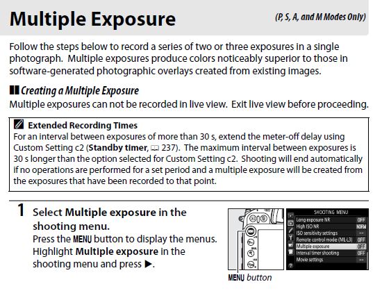

Check this setting:
Menu button
Second icon on the far left (looks like a camera) click the ok button
Look for Multiple Exposure (should be off)
If it is on then that is why you're getting photos like this.
My settings were: Shutter priority mode, Ch, Multiple Exposure OFF, APS-C, 6-shots per actuation, auto ISO, auto WB, and a shutter speed of 1/640. I used my Nikon 70-300mm lens just like I did with the D90. If anyone can tell me what I did wrong...............or if the camera is broken...........I would appreciate it immensely. The next grandchild's soccer match is this Sunday. Thanks for looking, and drop me a line anytime.

The only other suggestion I can come up with would be to do a two-button reset, see your manual or Google how to do this if you need. After doing the reset put your camera in Shutter priority mode -- but don't change anything else -- and test the camera for proper function. If the camera still malfunctions it may be time to call in a professional.
If everything goes well, you can assume pilot error. From here, begin making ONE adjustment at a time, making sure you know what you're doing each step of the way, and testing for proper function as you go.

Someone else asked earlier... Are all your shots like this? If they are, then I have no idea. If this was the only one, I still vote for multiple exposure was on. I think on d7100 it can be set to stay on or just for one time use. If it was set for one time use, it would be off when you went to check it. I don't have a d7100 though so I can't say for sure.

ALL the shots that I tried to take in "continuous" mode are like that one. I double-checked, the Multiple Exposure is OFF and was Off. Thanks for replying.

Unless it was a data file recording error, seems like multiple exposures setting is the issue.

maybe you no mup at the camera ? at the left of the camera there is roller that maybe aimed to MUP (mirror up)

try to reset the menus maybe before take a picture check it cuz i just took multiple exposure and after you taking multiple exposure the mode turn off him self
try again and before you taking the photo check the mode
