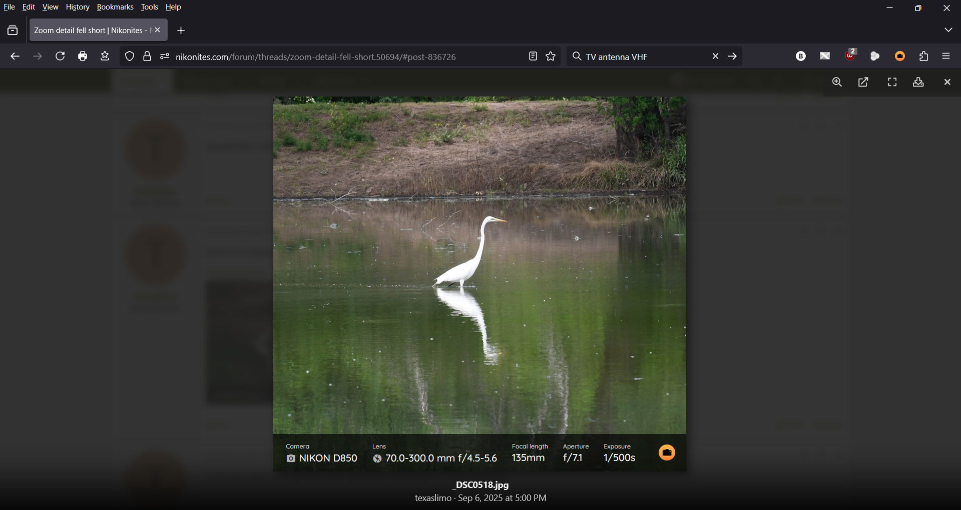

BF Hammer
@Clovishound I do see exif on the image. 1/500s at f/7.1 (135mm).
If a tripod was used, VR should be turned off. Focus might be off. Shutter speed by all recommendations at 135mm is fine. But I will add that I never have had an exceptionally good example of a 70-300mm lens. There are many versions, but I found both of mine to be low contrast and soft in general. A used 70-200mm f/2.8 is a much better match for a high-resolution D850.
@texaslimo after uploading the image, there is another button to click on to insert the photo into your post so it will show the full size photo.

I know this is turning into old news, but I remembered I have a 2nd exif viewer installed. Some extra details...
FILE PROPERTIES
Content-type: image/jpeg
Size: 450402 bytes (439.85 KB)
Last modified: Mon, 08 Sep 2025 00:22:59 GMT
Dimensions: 2289x2079 pixels
IMAGE META DATA
Date: 2019-06-16 15:04:45 -0400
Creator: RICHARD GERMANY
Make: NIKON CORPORATION
Model: NIKON D850
Lens: 70.0-300.0 mm f/4.5-5.6
Focal Length: 135mm, 135mm (35mm equivalent)
Aperture: ƒ/7.1
Exposure Time: 0.0020s (1/500)
ISO equivalent: 400
Flash Fired: No
White Balance: Auto
Distance: Infinite
Software: Adobe Photoshop Lightroom Classic 13.1 (Windows)
Exposure: aperture priority (semi-auto)
Exposure Bias: none
Metering Mode: Matrix
Focal Length: 135
Color Space: sRGB
Focal Length (35mm): 135
LensModel: 70.0-300.0 mm f/4.5-5.6
Preserved Filename: _DSC0518.JPG
It looks like the recorded focal distance was at infinity. I am guessing that was a near-miss on focus and it should be just a bit shorter than that. Otherwise I cannot criticize the exposure choices much. I think I would have accepted a higher ISO with Auto-ISO active and taken a higher f-stop more like f/11. On my D750 I'm willing to take photos at ISO 3200 in some situations, ISO 1600 anytime.
