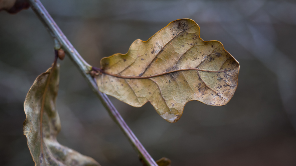

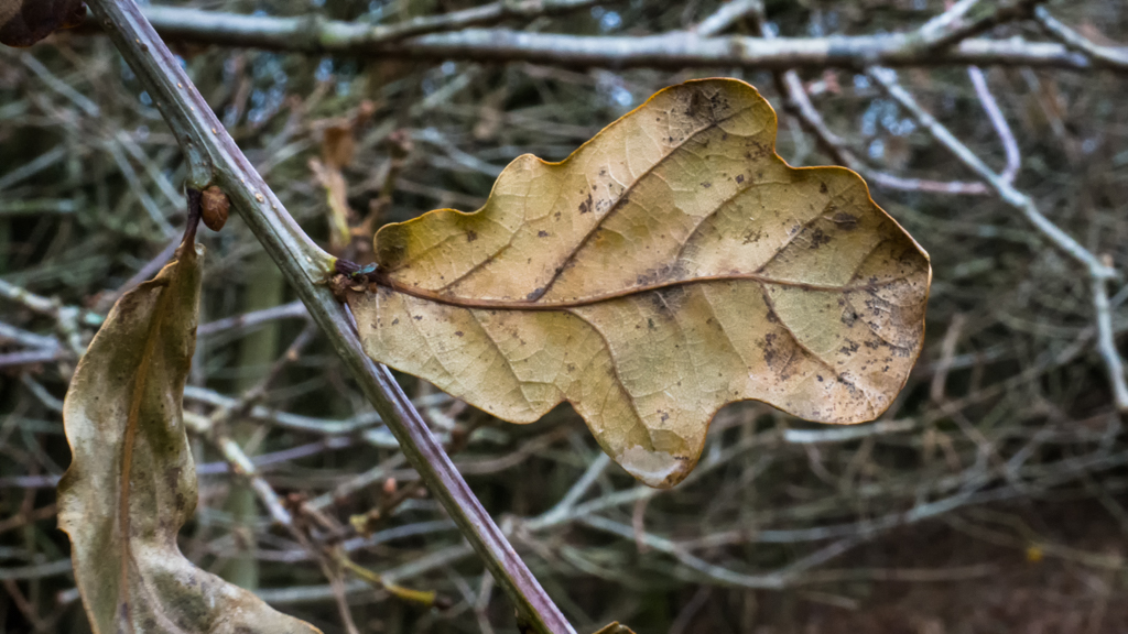

It does make the point that the 50 mm f/1.8 is NOT best plan. Novices get the notion it is, but we won't see many pros suffering that way (they tend to want their work to sell). There will be better results to stand back with a longer lens. Instead of 50mm f/1.8 at 6 feet, instead maybe 200mm f/4 at 24 feet. Or even 100mm at 12 feet with f/2.8. Generally we're outside and have lots of room so this is no issue. But there may not always be enough room indoors.
200mm is 4x longer than 50mm, so if standing back 4x farther, it has exactly the Same Field of View as the 50 (at the subject). And if at the same aperture there, the Same DOF too (at the subject) - the adage about the "same image" has same DOF, etc. (at the subject, it does).
But the background is certainly NOT the same then... most of it is zoomed and gone missing (you want it excluded right?), but what's left is in more blurred focus (assuming that is a plus here)... due to focal length and distance to the background. In regard to the background, the longer lens standing back has a vastly larger Circle of Confusion (the blur circle diameter) at the background, computed by this new calculator. The actual CoC number isn't so useful, but it being LARGE is the point and this benefit. And then if opening the 50 to f/1.8 to help blur the background, the subject DOF goes to pot too.

Anyway, it makes the point that standing back with the longer lens will be better results, sometimes much better,
in regard to blurring the background, (your plan is to blur it, right?)
and in regard to simply excluding most of the background, (you want the clutter eliminated, right?)
and in regard to better DOF at the subject. (f/1.8 certainly needs better DOF at the subject, right?)
A major point is that since the telephoto background is so much smaller area, we can easily and simply slightly move the camera sideways to select the best (least objectionable) part of it to be shown in the picture.
