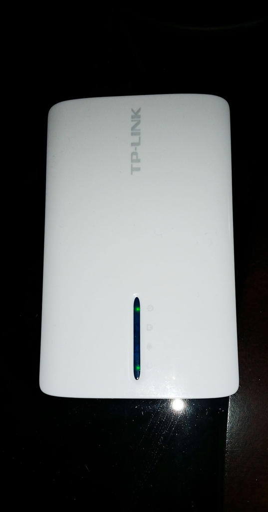

The setup works well, funny, the camranger uses the same TP 2000 mah battery as the portabe router, makes me think hmmmmmm, the little wifi with the camranger even looks the same as the TP-Link MR3040, another hmmmmmmm.
1/10 the price of a camranger.

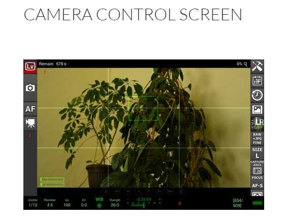

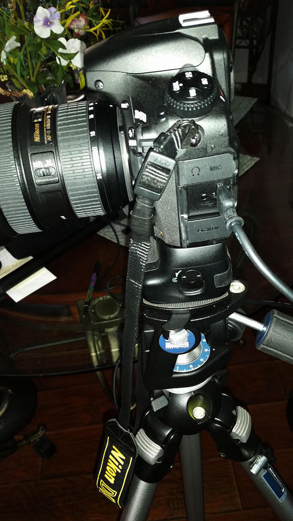

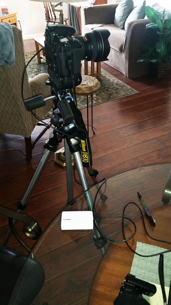

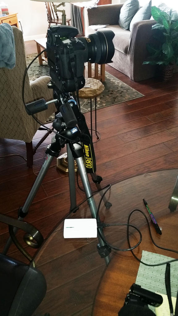

It just takes a little googling, there are also some youtube videos on the setup. The best place to begin is the qdslrdashboard site.

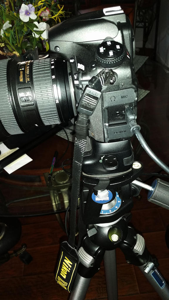

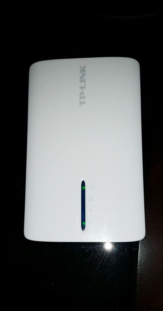

Here are some pics of it hooked up to the D810, worked the same with the D800. Uses the usb cable that comes with the cameras. You can also give the app a try by using it tether via usb (you will probably need a usb female to micro usb, about five bucks) and see if you like the app.
Yeah, it's the same stuff. I did some research last year on this and got into some hackers that were doing this with various other things. Seems to be same hardware just a different label.

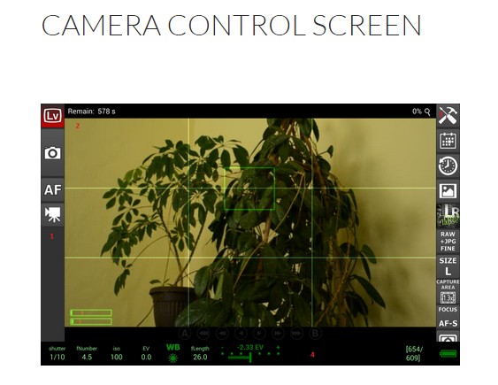

Welł, after seeing the screen shot I may just play with it. I need to find the same setup but for iPhone. Time to find those links tomorrow. It's too cheap not to do it.

Yup ... being a CamRanger owner, I can confirm the TPLink adapter looks to be the exact same hardware as what CamRanger relabeled. Sometimes it makes more sense to wait on a purchase like Kevin did. :)

Update, just got it configured ( the TP link that is), already had the software on my IPad mini. Took a bit get a grasp on the settings, how to connect, but after playing with it all I can say money well spent. Hope to get to play with it this weekend, but so far very impressed with the software and device.
Took some shots playing around with it while in LV on the Ipad. It shows you the shot, I shoot RAW, you click on it and it shows you the Histogram. You can click on ISO in the bottom and change the ISO on the fly, well any setting for that fact works very well. You can delete pic's from the card, view pics from the card and even movies.
