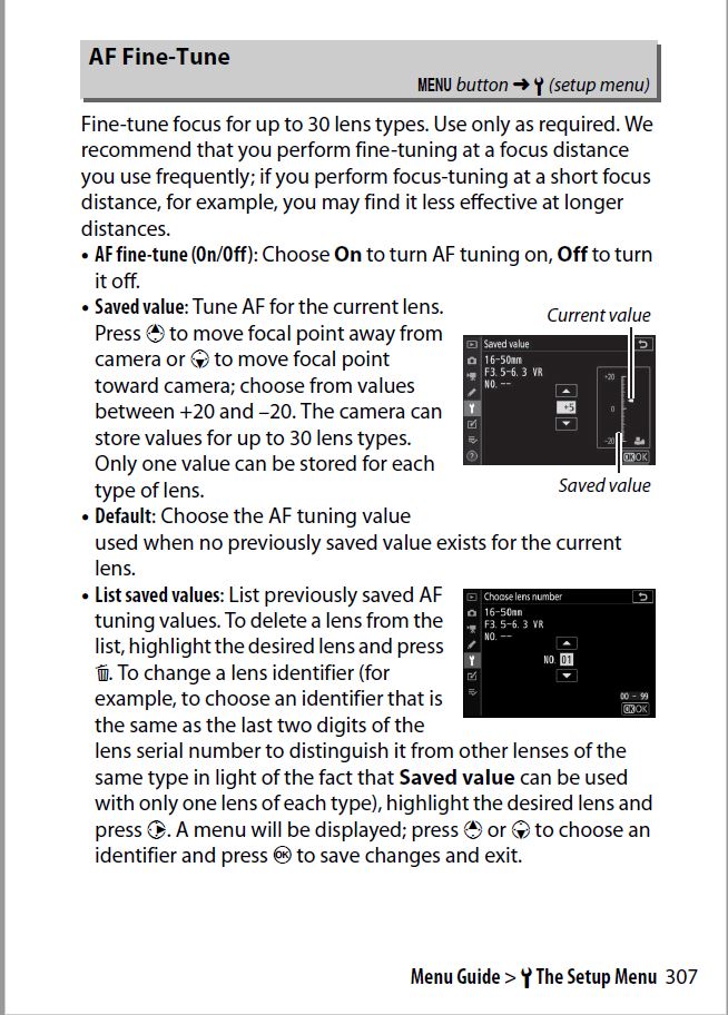

Sorry to repeat this but AF fine tuning may not be a thing of the past just because you use mirrorless, unless we think Nikon included it because it was a slow day and they had nothing to do.
From the Z50 manual and i think its the same in the 6 and 7

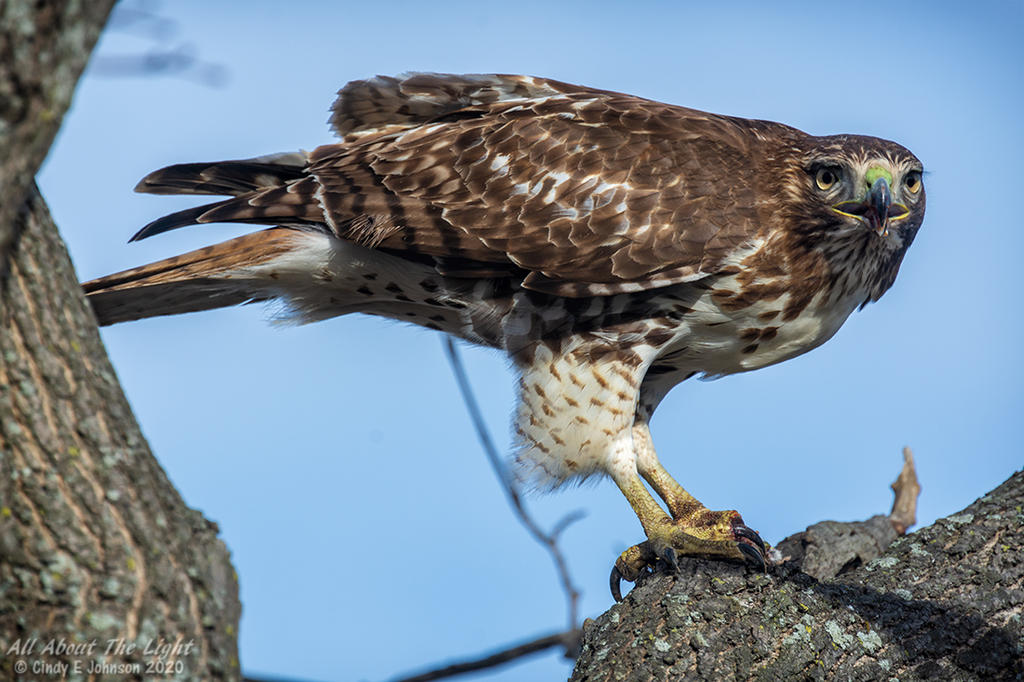

Above was one of my first images taken with the D7200 and the refurbished teleconverter on my 300mm f/4 PF. Back when I compared this refurbished TC with the first preowned TC, I swapped them out to make sure the refurbished one was the one I wanted to keep.
Ever since I have had no end of soft photos. The level of sharpness that it produced initially is gone. I've been using the Shake Reduction feature in PCC because it's as if every photo displays a slight blur.
I still have more testing to do - and I'll even test the lens without the TC to see if anything is going on with it. I cleaned the contacts on both the TC and the lens and used a rocketblower on the body to remove any loose debris that might have been present. After I test the lens alone, I will try the combo on my backup D7200 to see if that makes a difference.

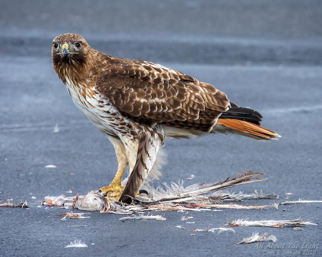

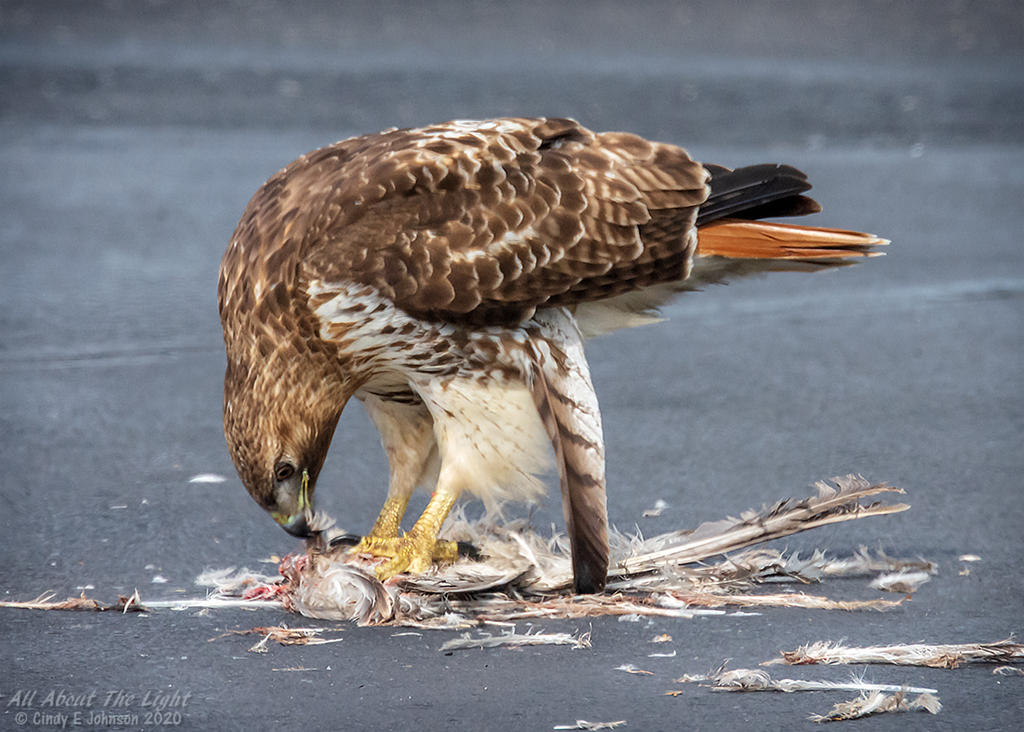

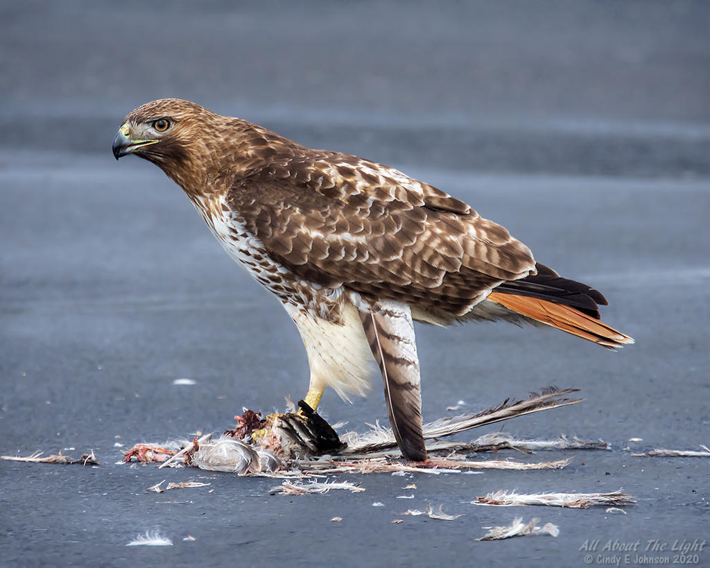

I am still trying to identify the cause of the soft focus. Today I had an amazing opportunity to photograph a red-tailed hawk with its prey. I was literally 20 feet or so away and shot well over 100 images. I'm lucky if I have 5 in focus enough to salvage. This image is cropped quite a bit.
It is one of the five that was slightly soft - and I used PCC's Shake Reduction as none were sharp enough straight out of camera. At least the Shake Reduction feature in PCC does a good job.
Prior to going out, I used a rocketblower on all the contacts. The VR definitely seemed to engage properly. My next test will be to swap out the 1.7x TC with the 1.4x and see if the problem continues. If it does, then most likely the issue is with the lens. If not, then it will be the teleconverter. It's definitely not the camera since this happened with 3 different bodies.

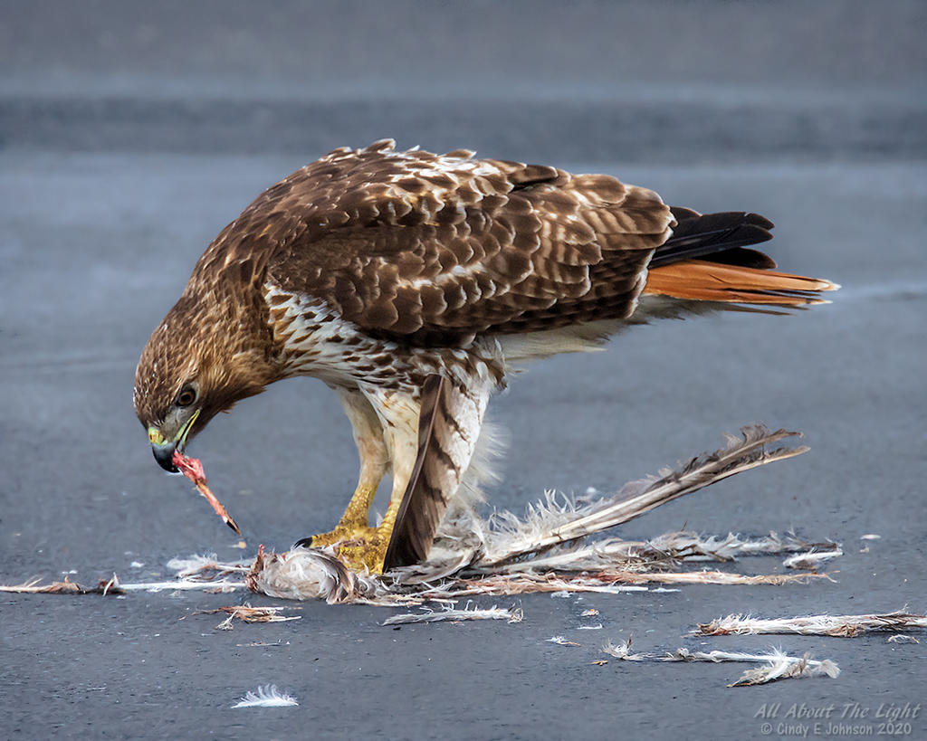

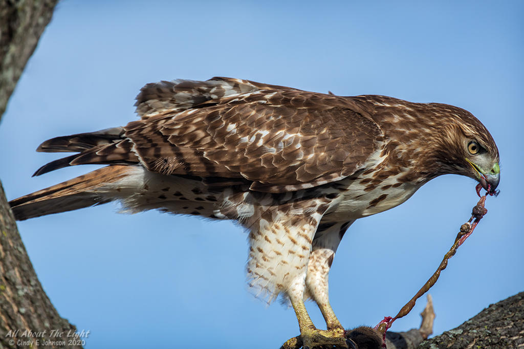

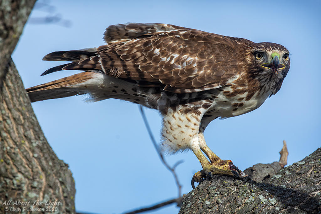

Due to my frustration yesterday, I guess I hadn't looked through the entire folder of images very carefully. At some point, I vaguely remember changing my settings - one of which was switching to AF-S with single point. That made a noticeable difference although there were still a few photos here and there with soft focus. At least the VR seemed to be working properly after using a rocketblower on the contacts. That was causing some of the problem.
Here are the remaining images I've edited.

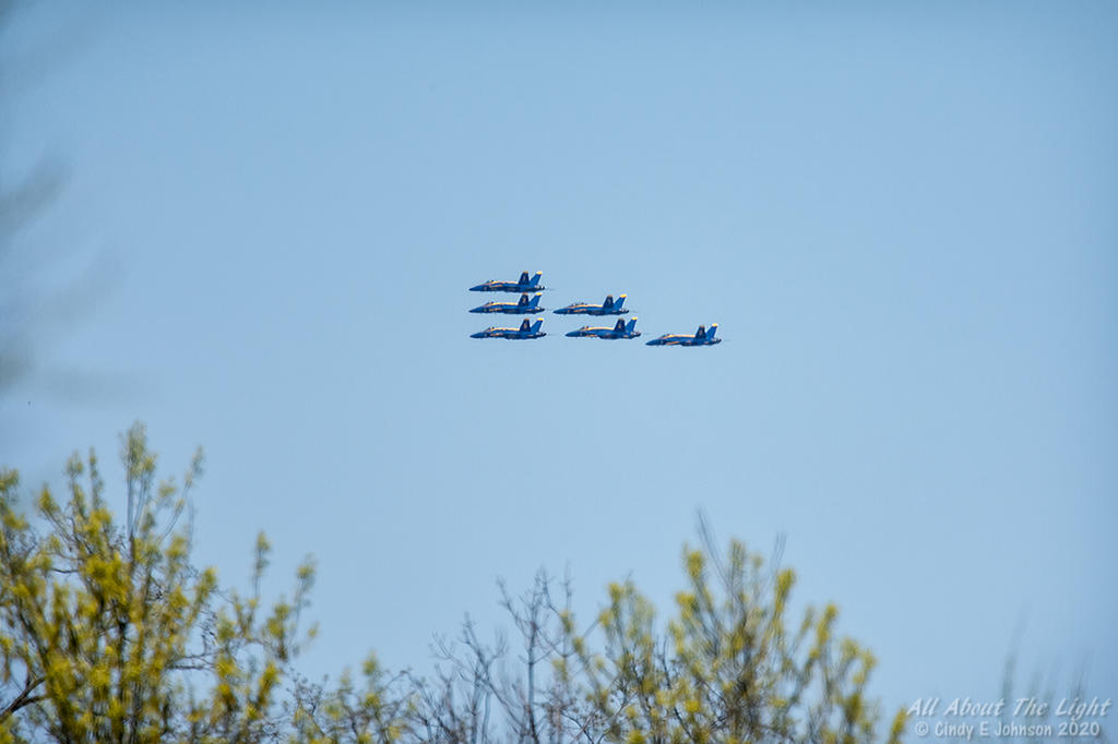

I am very disappointed with this 1.7x teleconverter. Today I used it to photograph the Blue Angels - although they were pretty far away. All of the images wound up being very soft. A little bit of a crop to this image along the same lines as other crops I've done. Not even Shake Reduction could make the images better. Here is the best one.
Yet here is one taken with the same lens and body but with the 1.4x teleconverter instead of the 1.7x. No Shake Reduction was necessary. The issue is definitely the 1.7x TC. :(
