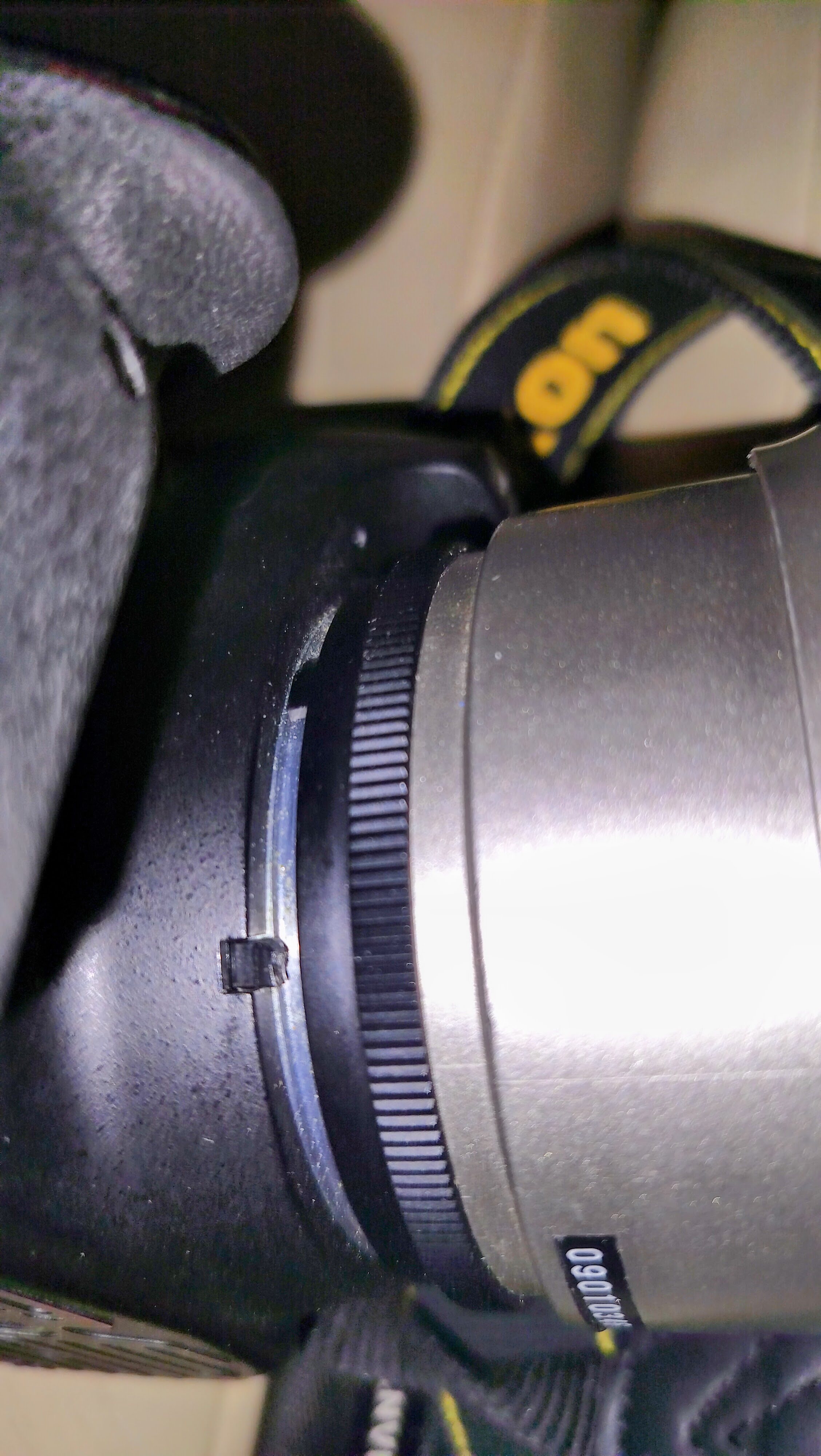

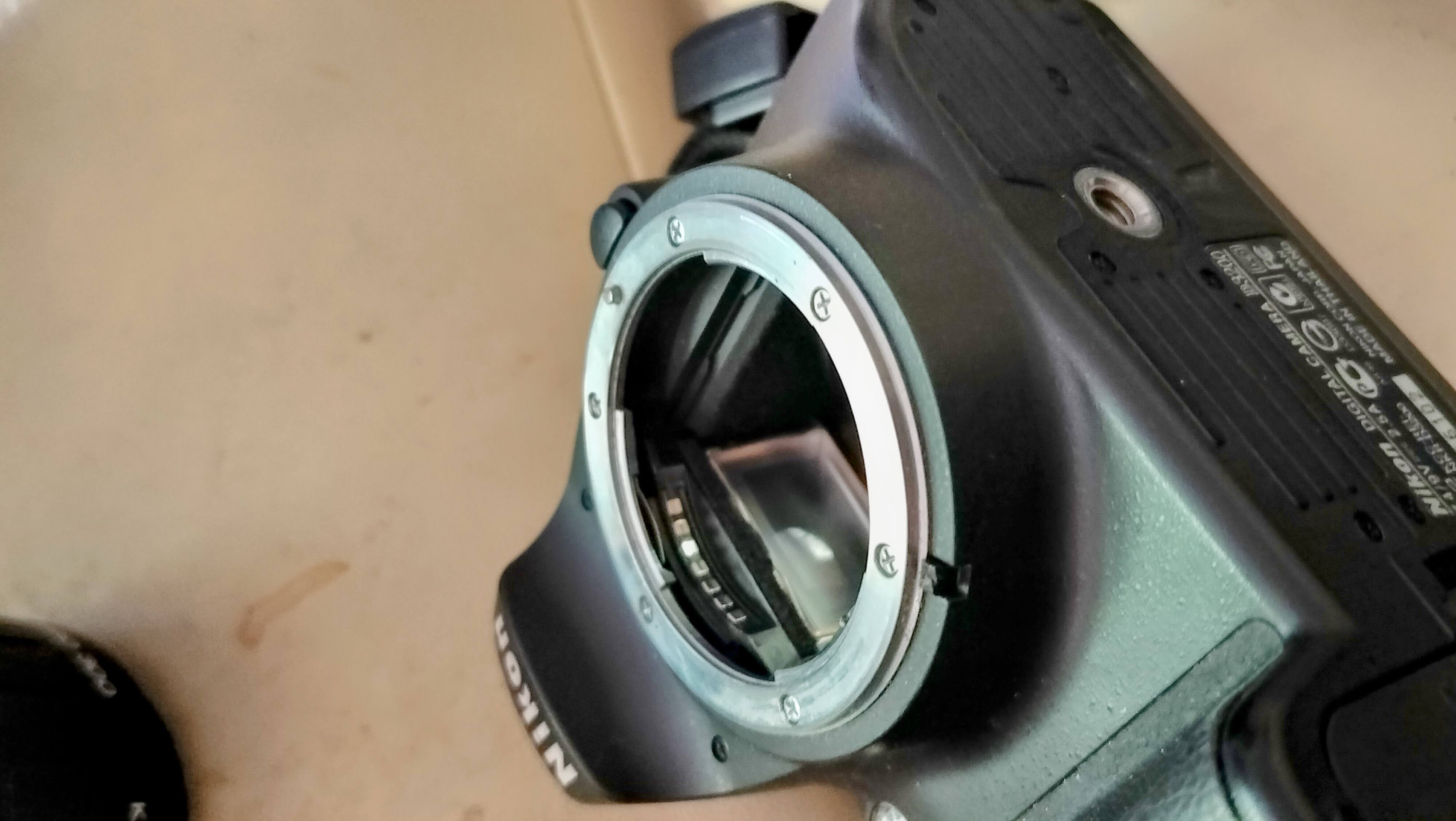

First post here. I have had Nikons since the 1970s. I have a D3200 and just bought a Vivitar Series 1 AF 100-400mm 4.5-6.7 Lens. The camera screen shows, "Lock lens aperture ring at minimum aperture" That is f22 for this lens and it has a switch on the lens to lock it. I get the dreaded fEE error message and cannot get rif of it. I have removed the battery and fitted / removed the lens several time. The camera works with my other AF-S lenses perfectly. Note please that this is and AF lens. I never expected the zoom or autofocus to work with this lens as it is an AF variant but it would be nice to take phiotos with it. The lens has been tried in all modes M, A, S, P and both auto modes. All give the above message on screen and fEE in the viewfinder. I even have an old 500mm f8 mirror lens that works manually.
What am I doing wrong here? All help gratefully received.

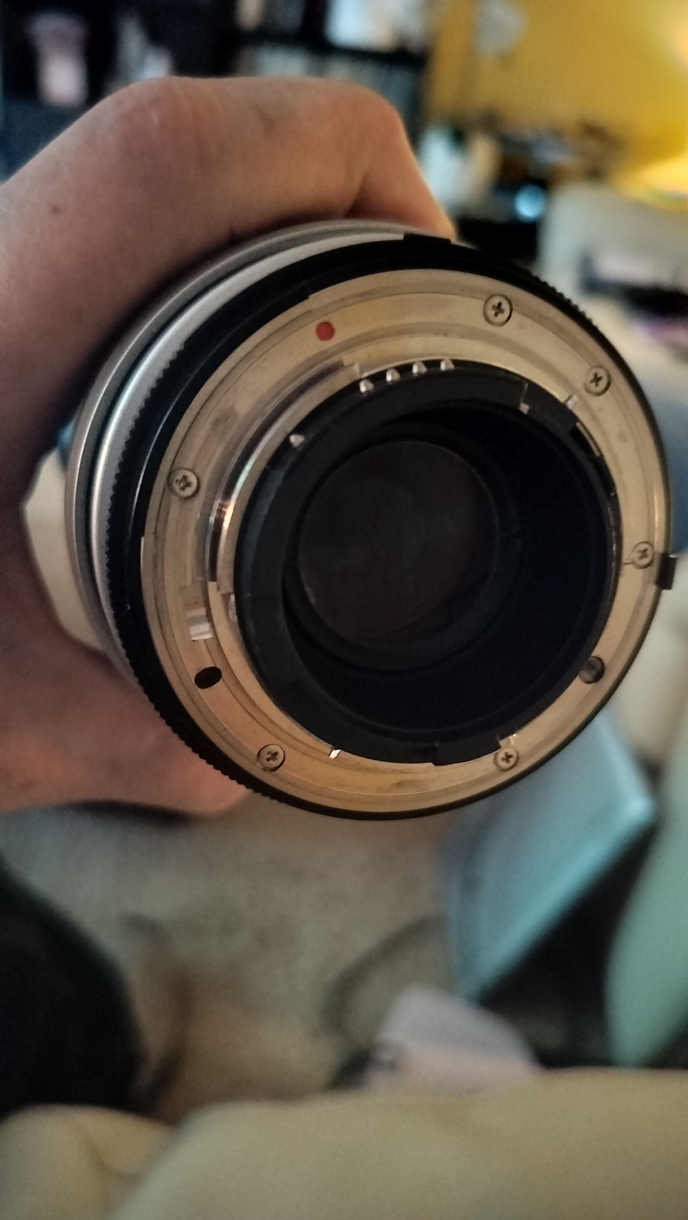

Is the lens a F-mount with the CPU connector pins? Is a mount adapter in use here?

Count those CPU pins on the Vivitar lens and then compare to your other lenses that work. I think you will notice a large difference. It may have been compatible with earlier generation bodies at the time it was built, but then became incompatible by changes to the CPU pin setup over time.
And it's a screw-drive AF system also, which means it could only be used as a manual focus lens on your D3200 anyhow. But the CPU pins also communicate metering information, not just focus information.
Now I notice there is no feeler-lever for activating the f-stop visible. I say that lens is not for you.
