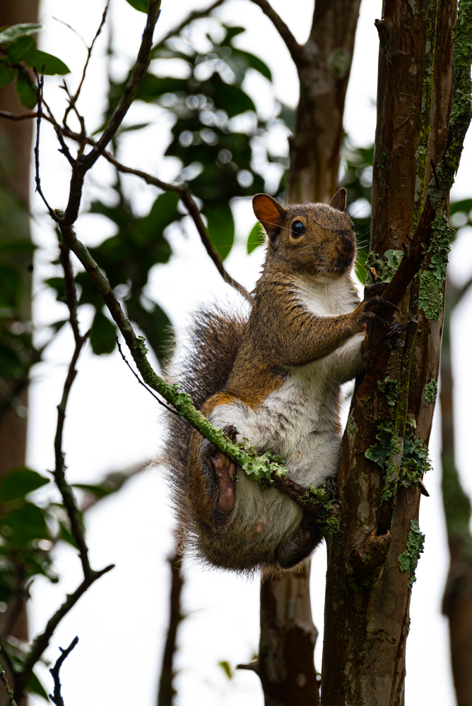

I shot a squirrel (no blood was spilled) in FX mode. While I was changing modes, the squirrel skedaddled. Here is the result.
Squirrel, FX mode.
Squirrel, magnified.

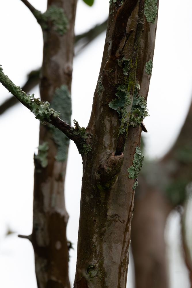

Crepe myrtle, DX mode.
Crepe Myrtle, magnified.
Files in DX mode were less than half the size of FX mode with both in RAW. I was pleased with the resolution of the DX mode, although it definitely isn't as good as the FX. I was able to enlarge the FX to a higher magnification before losing detail, than the DX.

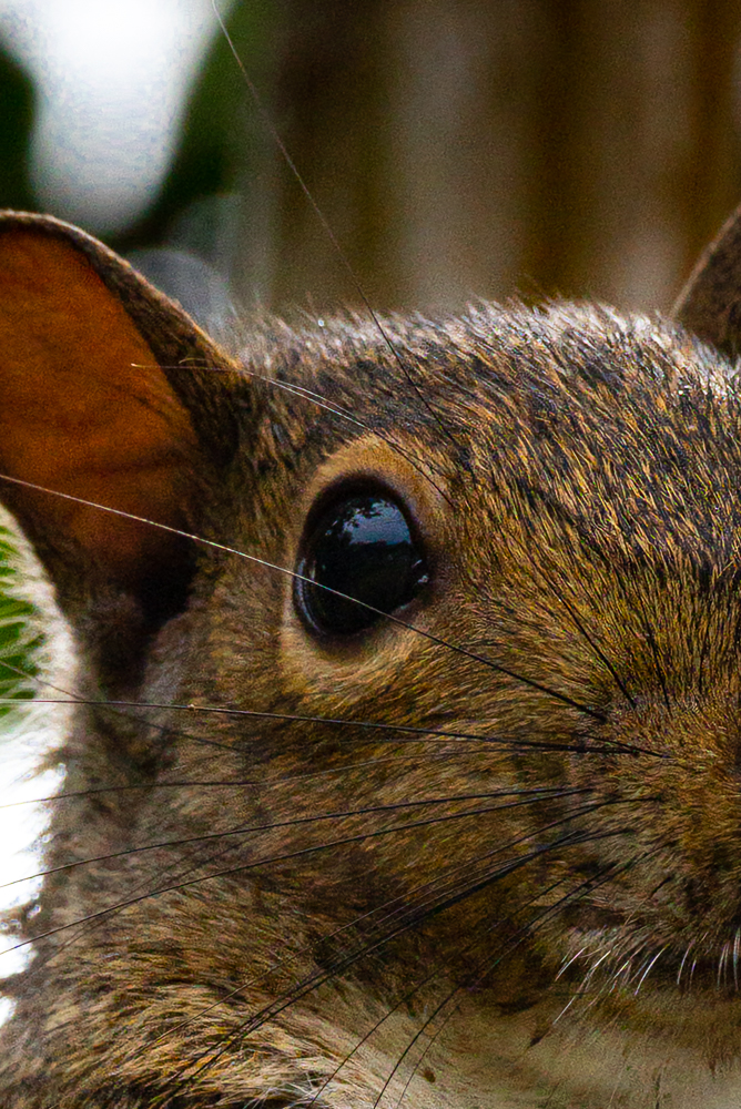

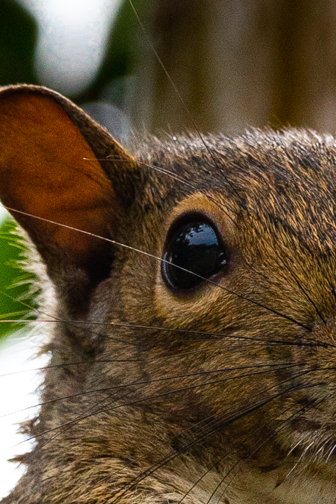

I tried the enhance in LR. It obviously is hardware intensive and bogs down LR on my computer, which admittedly isn't the fastest. It also works. From this single example, I wouldn't call it an extreme improvement, but it definitely smooths out some of the noise, most notably in the areas above the head, and in the ears. I'm sure it would make a real difference in the print-ability of a large blow-up, or tight crop.
Here is a before and after of a blown up portion of the first photo.
Original:
Enhanced:
