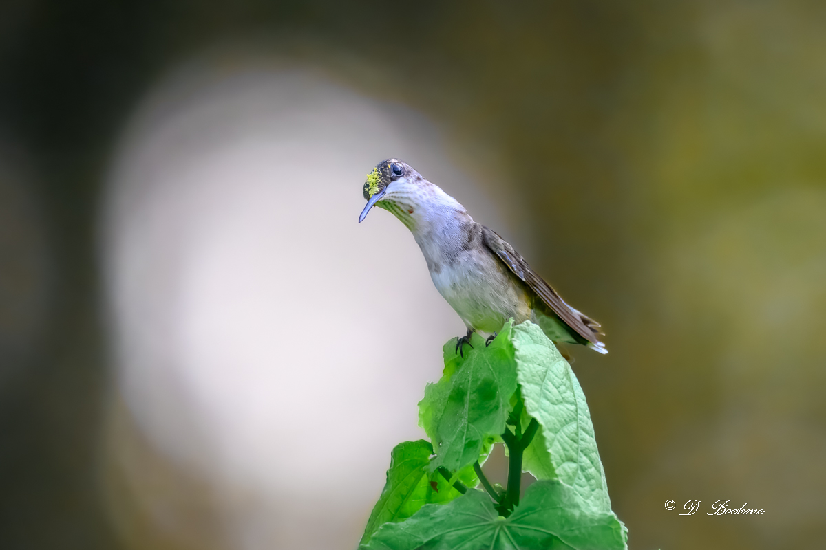

Here are two edits of the same file. The first is minimal editing with NO cropping: I have cropped tighter than this with good results, but this was the first one I could easily find.

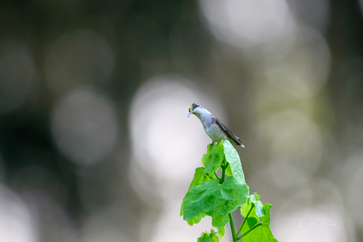

And here is a heavy crop:
