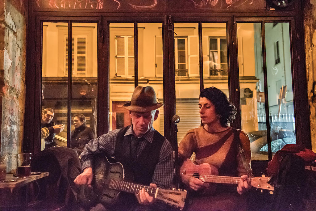

I had a go at this one but also chose a 2nd image that I will edit when I have time. When I raised the exposure, there are multiple colors of light present. The building on the far right is lit with fluorescent light (green color cast), the building behind the couple is tungsten (golden brown color cast), and then along the bottom edge of the image is a mauve color cast. I had trouble trying to match all the colors so I decided to convert to black and white. You could also opt to use a mask and have them in color with the rest being black & white.
I did most of my edits in Adobe Camera RAW before heading into PCC. I used Nik Dfine for noise reduction (couldn't get a whole lot of reduction with it) then converted to black & white in Camera RAW. Nik Silver Efex was going to use too much contrast during the conversion (which adds more noise) so that is why I chose Camera RAW for B&W conversion. I also tweaked the noise reduction there, too.
Then I went back to PCC and used a High Pass Filter mask for sharpening their faces slightly. There's going to be noise no matter what, but the exposure is raised enough to see some detail. You *should* be able to right click the image to open it in a separate tab/window. That will allow you to enlarge it the most.

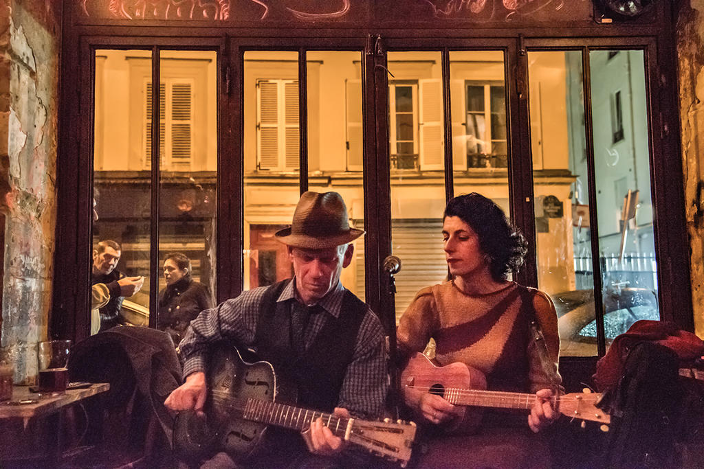

I chose this particular image because the original was very dark. I decided not to convert or try to correct the background colors although I dialed down the saturation on their faces.
The problem with editing images that are high ISO and underexposed is you can introduce artifacting. That's when areas within the image start to take on a squarish appearance. I could have used an adjustment brush and added more noise reduction to their clothing and the background, but my attention was primarily on their faces. In fact, when I used Nik Dfine for noise reduction, I wound up lowering the amount since the photo was way too creamy (smooth) and the artifacting was more noticeable. It's a juggling/balancing act when you encounter artifacting.

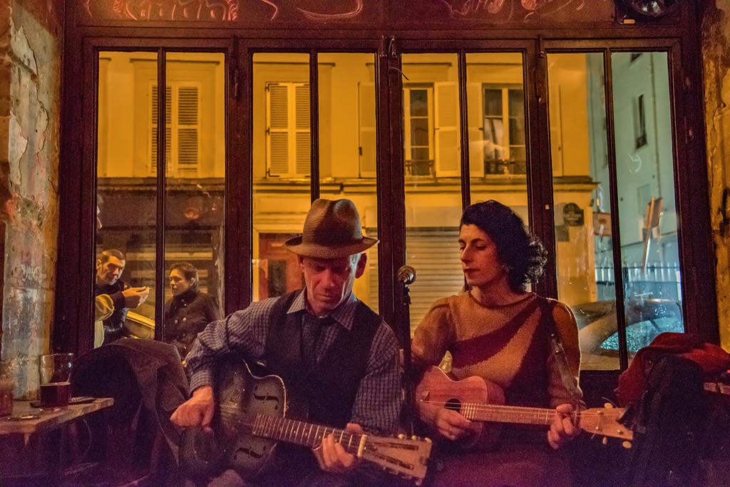

Thanks for uploading the files, it gave me a chance to play with a d750 file. You have gotten some good advice about metering back lit shots. Just one stop would have helped greatly from 125th to 60th. If you are going to be taking this type of shot infrequently don't forget about a prime lens. Looking forward to seeing more shots.
