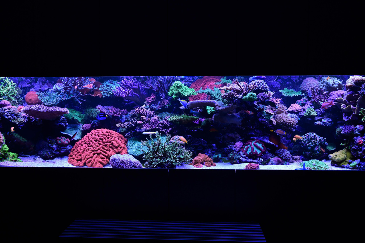

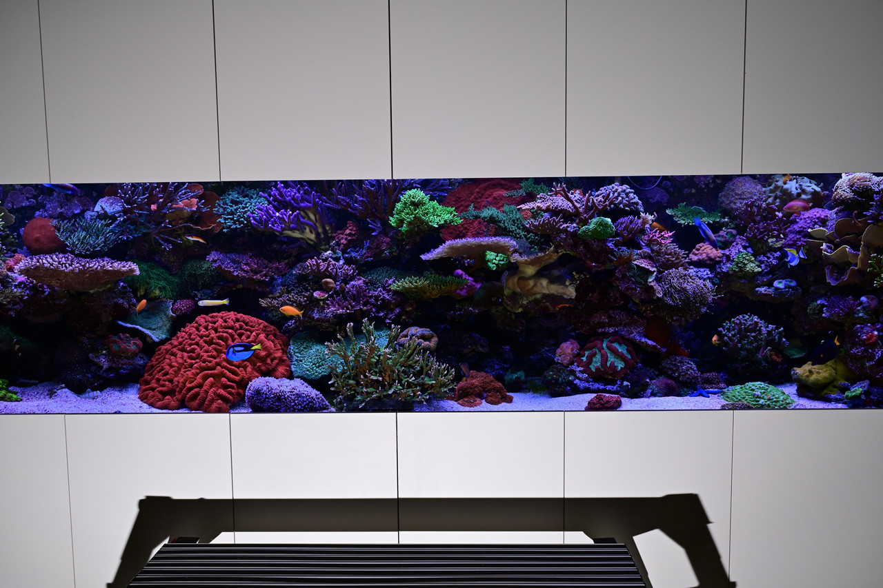

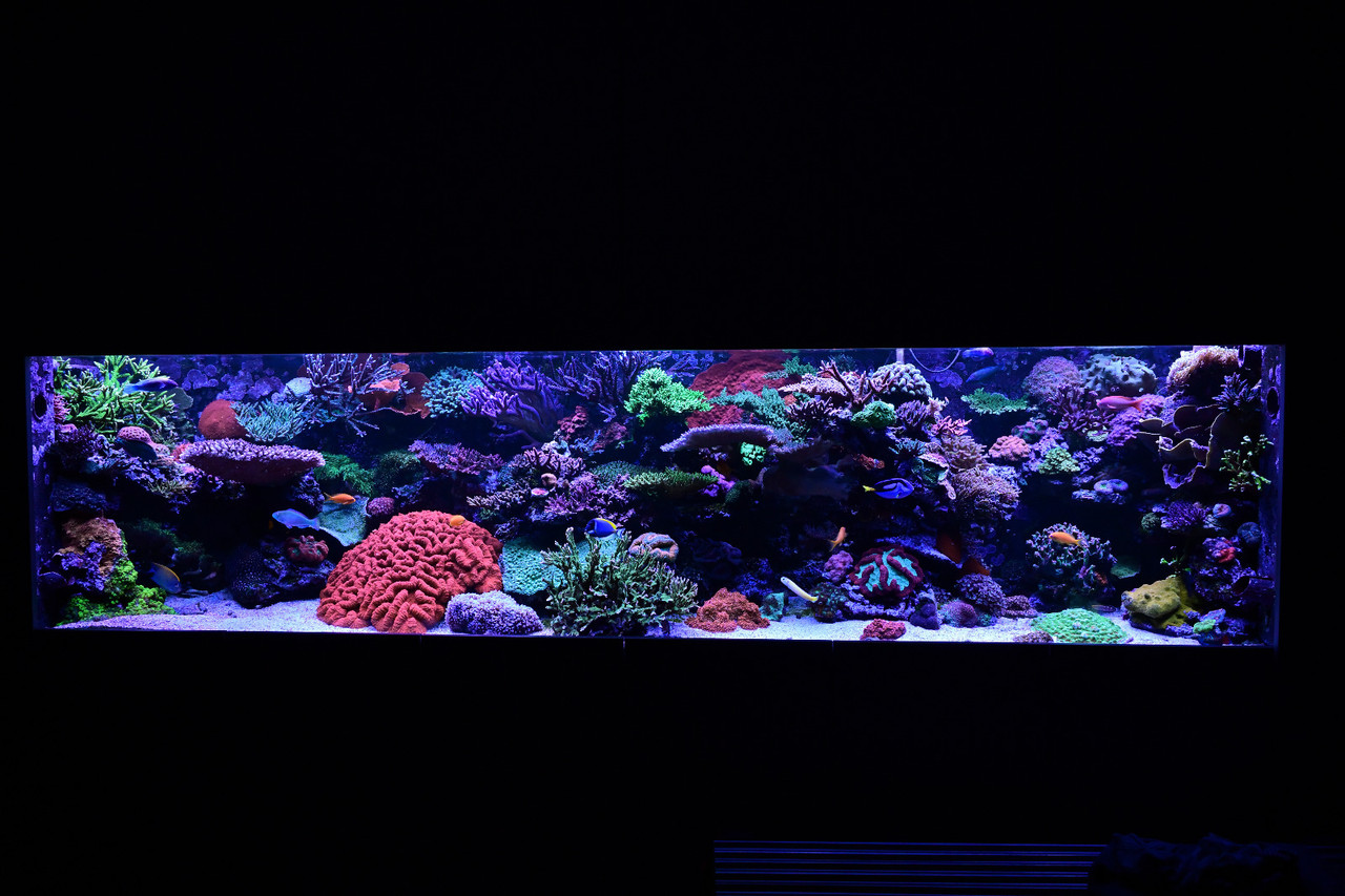

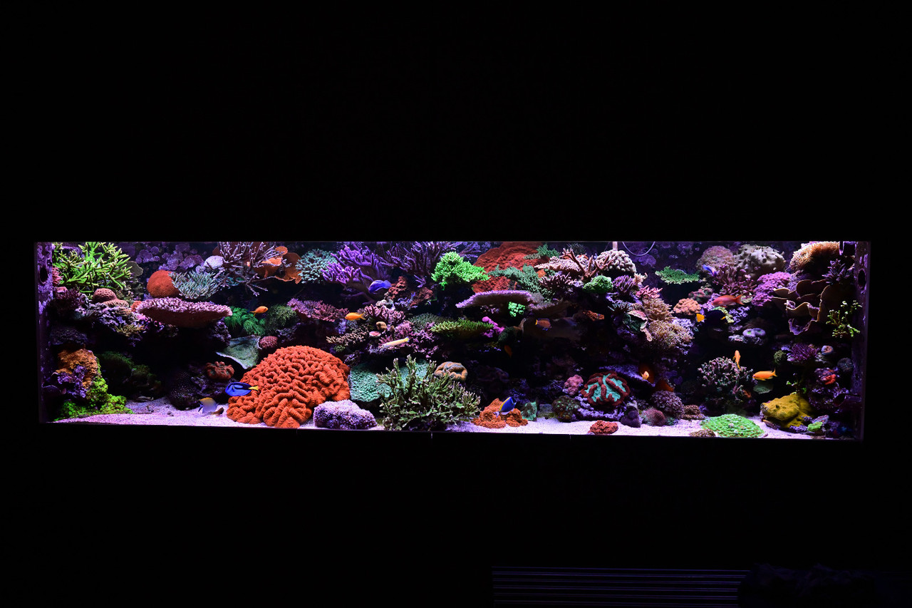

I will start with two photos and then explain how I arrived at these results.
I am not yet satisfied and suspect there is still more performance to be gained from the camera.

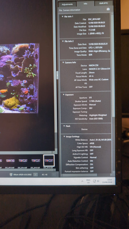

At the moment, I am shooting with the 24-120mm f/4 at 24mm. I use Manual (M) mode for maximum control. ISO is set to Auto ISO, while I adjust the other settings manually.
No physical filter:
With some alternative settings and a brownfilter.

With shutter speeds slower than 1/250 second, motion blur becomes visible when fish make sudden movements. A shutter speed of 1/160 second seems to be the minimum acceptable value, but 1/250 second provides a bit more safety margin.
ISO​
ISO values above 10,000 appear to introduce noticeably more noise, particularly in the background and shadow areas.
Aperture​
An aperture of f/4 has the advantage of keeping the ISO relatively low. However, the aquarium then appears rather flat, and the sense of depth is not adequately rendered. An aperture around f/7.2 to f/8 seems to be the best compromise.
Metering Mode​
After roughly one hundred photos, I concluded that my images were consistently overexposed. After trying various settings, I initially settled on Center-Weighted Metering. However, I noticed that the brightness of the gray aquarium cabinet surrounding the tank was influencing the exposure.
For that reason, I switched to Highlight-Weighted Metering. So far, this appears to work best, partly because the lighting comes from above and consists of approximately 1,000 watts of LED lighting. To prevent the image from becoming too dark, I apply an exposure compensation of +0.3 EV.

This is the most important point for me. Is this approximately the maximum sharpness I can achieve, or should I expect more? I have the impression that the entire aquarium is not being rendered sharply. What could be causing this, and which settings should I still experiment with?
2. Dark Areas​
Due to the Highlight-Weighted Metering, the less brightly lit portions of the aquarium remain quite dark. Because of the moving fish, bracketing does not seem practical. I still plan to experiment with Active D-Lighting. Are there any other in-camera options that might improve the rendering of these darker areas?
3. Color​
Color reproduction is currently of secondary importance; I prefer to tackle one thing at a time. The difference between Photo 1 and Photo 2 is the use of a brown correction filter. Unfortunately, this filter costs approximately two to three stops of light.

Overview of the settings used:

Great job documenting your process. Have no experience with aquariums.
The 24-120 is not known as the sharpest lens, perhaps a fixed focal length lens with better sharpness. Supposedly the lens is sharpest at 35mm @ F4 but your depth of field would shallow, tried F11. Remember you are shooting through water which tends to defuse light so sharpness may always be an issue.
I like the second image color but the filter is costing you a lot can you achieve similar results with white balance in camera or post? Is there different aquarium lighting where you could change the color and intensity? Might be something to play with if affordable.
As Clovishound mentioned today's software can do a lot with sharpness, shadows and color. It is always best to start with best you can get in camera and you are well on you way.

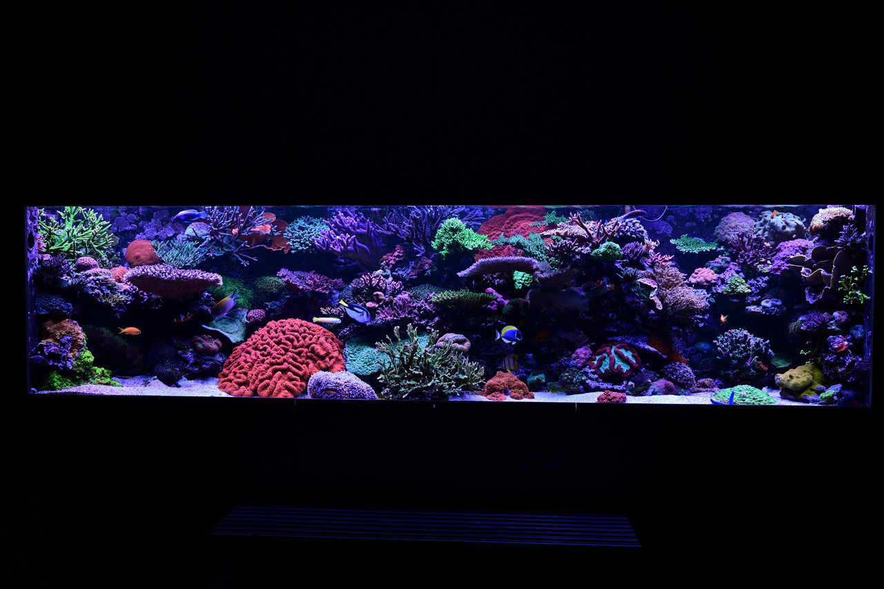

This evening I did some experiments based on the feedback above.
The baseline:
I have increased the light settings to achieve the maximum intensity in the tank.
The first picture I shot with 1/250s F/7.1 (auto ISO 1800) +0.3EV with 24mm focal length.
The image after is shot at 35mm (34.5 to be exact ;)) with the same settings.
Image 3 has the same settings as 2 but I believe the focus point is changed a small bit.

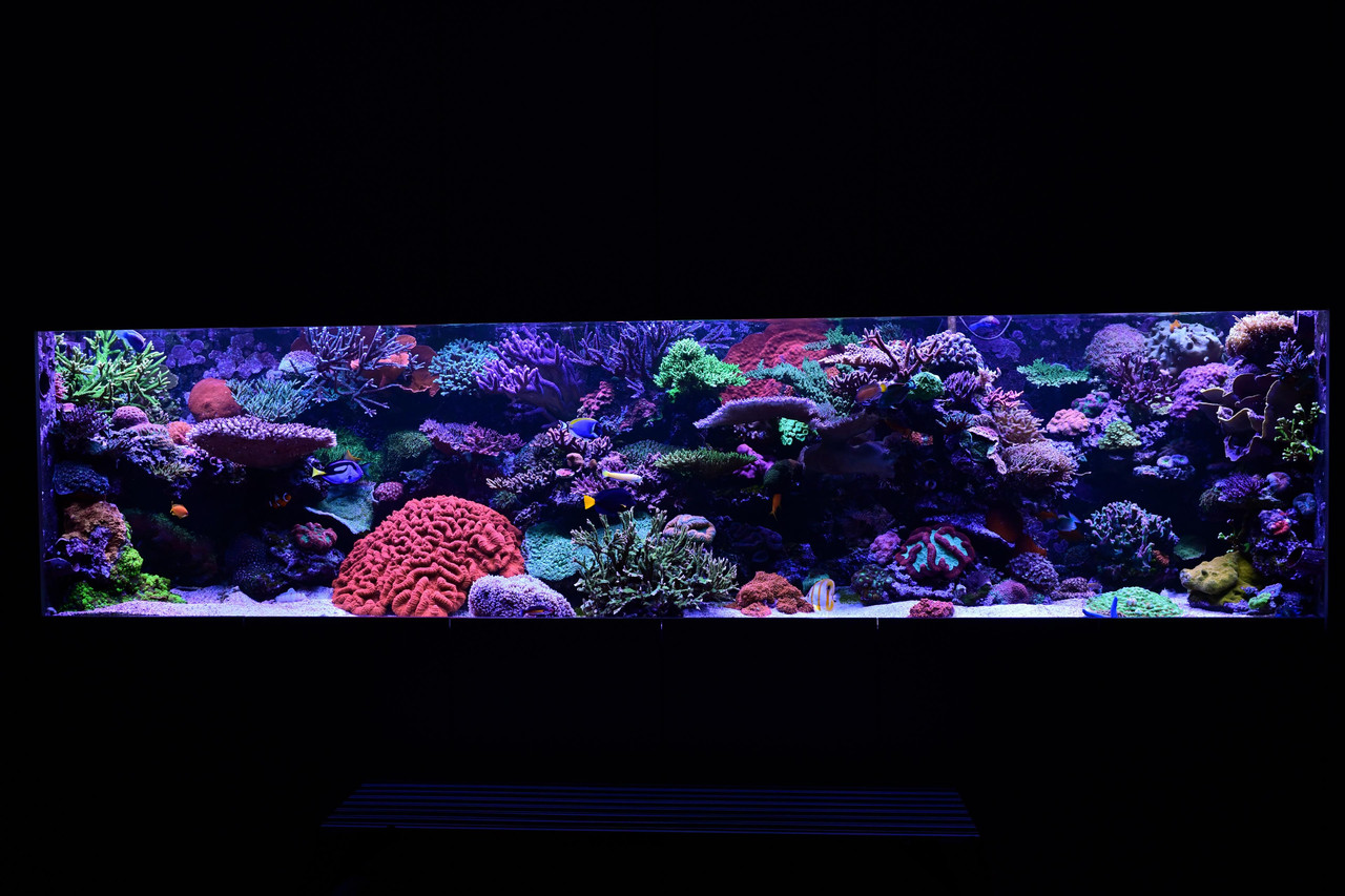

Image 4 I have increased to F/9, and compensated lighting by reducing shutter to 1/200 and +0.7EV. The ISO changed to 2800. I do not like this image. What is the main cause here?

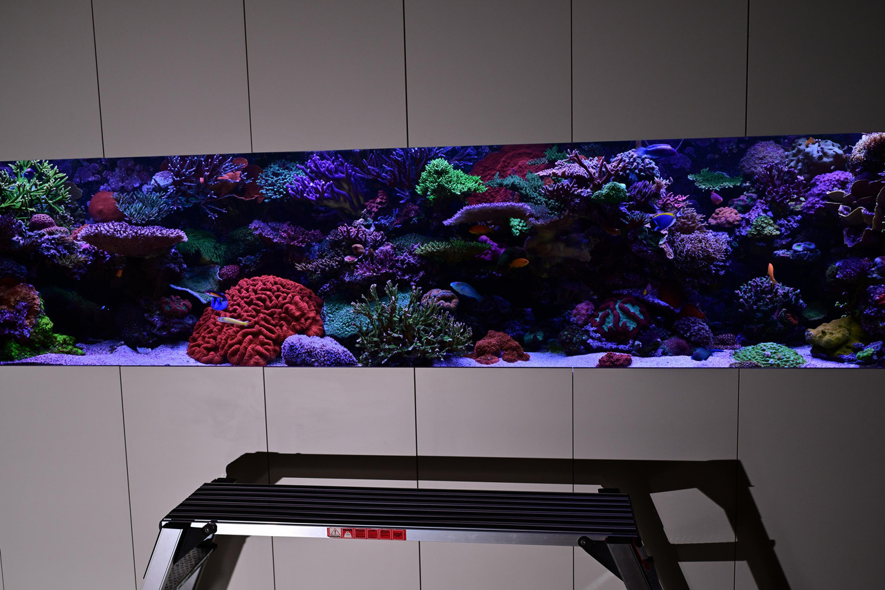

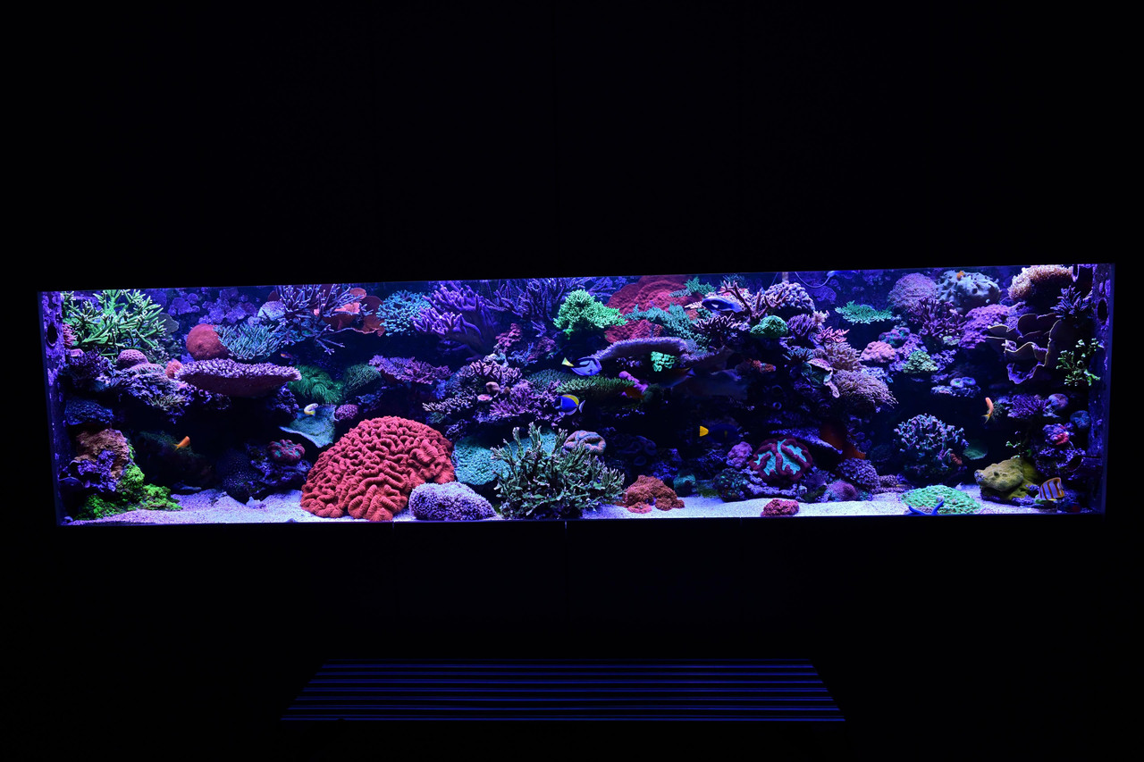

Image 5 I started to play with an external flasher. I have positioned it under an angle to prevent a nasty reflection. I notice I have to place it far in order to get an evenly distributed flash. Directly flashing from above will never get an evenly distributed intensity; the tank is too big for that. I am also not sure if I like the flash from the front. it does not feel natural or am I wrong?
F/9 1/200 ISO 800 and +0.3EV
F/9 1/200 ISO 800 and -0.3EV

The flash shots look great, a lot sharper, Just need a little tweaking. Can you set the flash to manual? If so give it full power and use one from each side if you can.
Another thing i have seen are LED strip lighting on a roll that can be taped to the glass at the bottom edge just above the gravel line, they come with a remote to change colour and intensity, you might have to lift your camera to get some gravel in the foreground.
