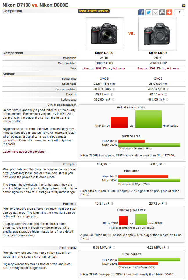

D7100 - 6000x4000 pixels (24 mp) on a 23.5x15.6mm sensor (prints have to be enlarged 1.5x more).
D800 - 7360x4912 pixels (36 mp) 50% more pixels, which is resolution. 35.9x24 mm sensor (1.5x larger). (this 50% more pixels is NOT due to the same 50% crop factor, it is just a coincidence of design parameters).
D800 will shoot DX too, 4800x3200 pixels (15 mp). If compared this limited way (to see the same view as the cropped FX), yes, then, D7100 is about 60% more pixels. But compared this way, the DX has to stand back 1.5x farther (which you did not do, you did not compare the same image view). The crop is a plus if seeking telephoto, but it is the pits if you want wide angle. It is really hard to accomplish wide angle from the DX crop factor. The lens may see wide angle, but the DX sensor crops it away.
It seems quite reasonable if to compare images, that it is only meaningful to demand comparing the same actual view, which means the DX stands back 1.5x farther, and the D800 FX still has 50% more pixels (in the same view). Also the uncropped FX frame needs less enlargement to print same size.
D7100 certainly has many fine features, but 24 mp being more resolution than 36 megapixels is not one of them.
I do agree that DX crops in the sense that a big chunk of sensor area is missing so you have a narrower field of view. What it doesn't do is magnify the lens and bring things closer. The image projected onto a DX sensor by a given lens is the same physical size on an FX sensor.
On that basis it's not the sensor size providing greater resolution and detail, it's the relative amount of pixels per area.
Pixels per sensor area is only important to noise. Pixels per viewed area is another thing, and it is very important, and it happens that DX always has to be enlarged 50% more than FX to see it anywhere. So.... any (dimensional) number you computed on the DX sensor must be divided by 50% before it is acceptable to compare to FX. That is simply how life is.![]()
Image size when viewed is based on pixels wide by pixels high. So a D300 DX and D700 FX would display the same size as they have the same pixel dimensions (give or take a few). A 24mp D7100 would be bigger than a D700 even though it's DX.
Your point almost sounds like the frequently quoted images should be uploaded at 1000 pixels and 72dpi. It's 1000 pixels wide end of story, the DPI does not affect it.
That's exactly right. Given the greater pixel density, the size of the individual pixels must be smaller, which means that they cannot capture the same amount of light as the larger pixels on the less dense sensors, all other things being equal. So while you have more pixels, it's likely that the information contained in them is not as rich as those in the pixels on the less dense sensor. So while you may be able to extract more detail on a crop, the information regarding the light that makes up those details may be such that you can't "do as much" with the information in post processing. On a well exposed, balanced image that likely won't matter. But on an image where you not only need to crop excessively but also do a lot of work with the exposure to see what you want to see, you may be able to extract a "better" result from the less dense sensor than you could from the one that gives you more MP's. There's always a trade-off. Thankfully not only do you have choices, but there are no real "losers" in these arguments.

I 100% agree with Geoff's original post, which if read carefully speaks from an "all other things being equal" standpoint - meaning lens, subject and original shooting location. If those things are not changed and only the body is swapped, a D7100 will offer you more pixels of your subject than the D800 (i.e. greater resolution). Period.
