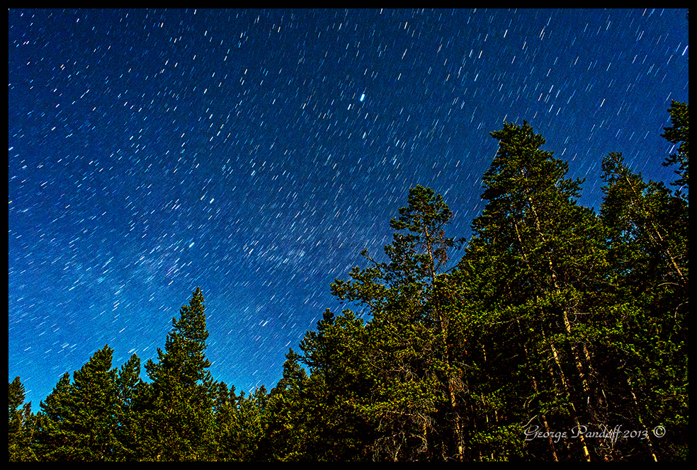

The higher the ISO (more ISO noise) the shorter the shutter needs to be open and the less movement the stars (star trails) give you.
Lower the ISO (lower ISO noise) the longer the shutter needs to be open but the stars start to move giving you star trails.
This was a three minute exposure to get the star trails.

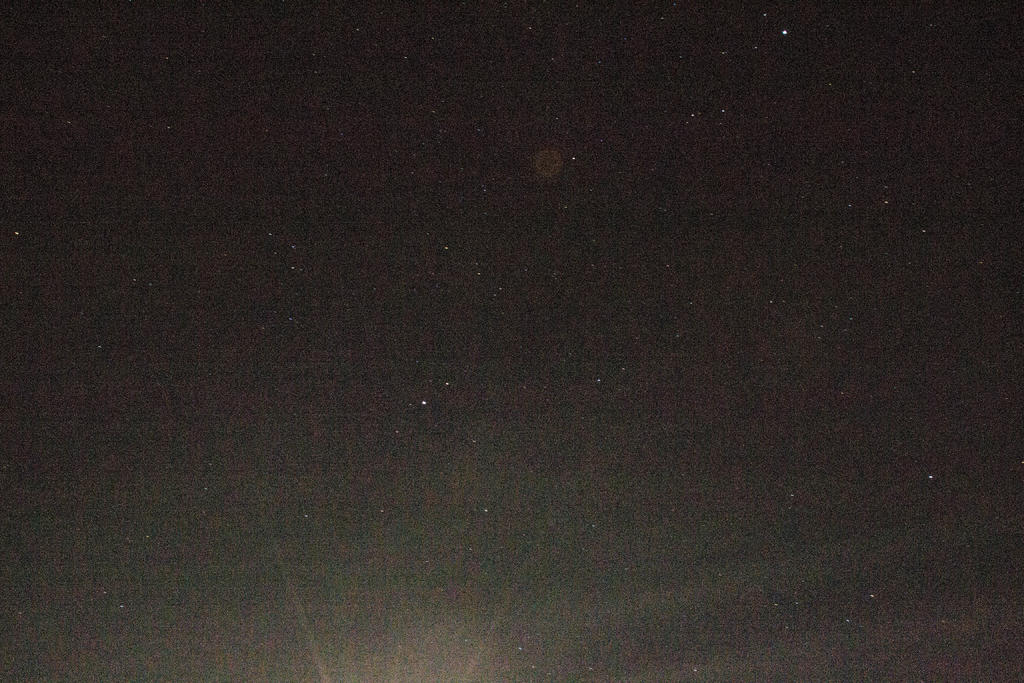

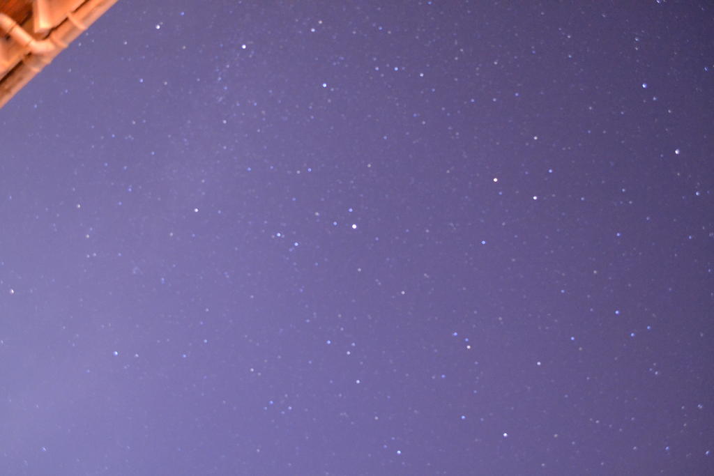

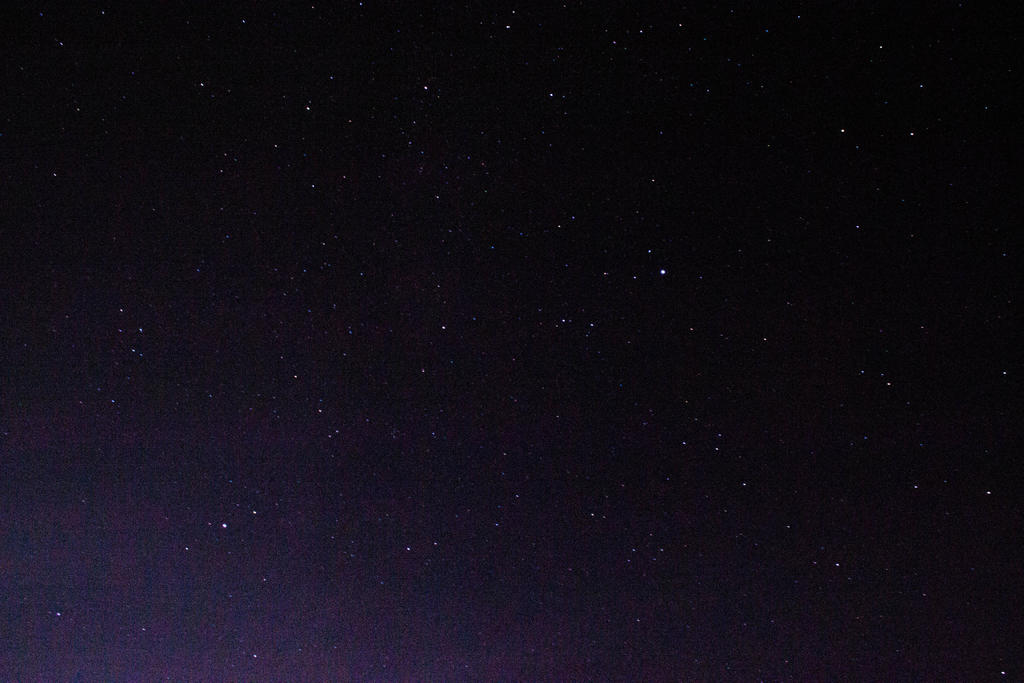

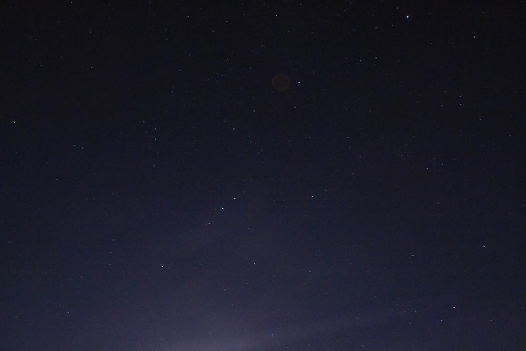

I went out tonight for the first time and tried shooting some stars. I got some but I dont think i managed to focus properly, I tried manually focusing but through live view and I could not see anything to focus on through that as the screen was not showing up. any stars, how can i solve this? also everyones advice was very useful in this DSC_0023.jpgDSC_0047.jpgDSC_0027.jpgDSC_0039.jpgDSC_0045.jpg
WayneF
You can focus if you first zoom the Live View LCD screen (same as zoom in playback) to make it greatly larger, which will then show the stars, which you can then manually focus for maximum contrast (to be the smallest brightest view).

Ok thanks, I think i did what you have mentioned waynef but my screen was too dark to see anything at all so i will try that again tomorrow night along with dave ws suggestion
Should work easily. Make sure your lens is wide open (depth of field in not a problem. :) )

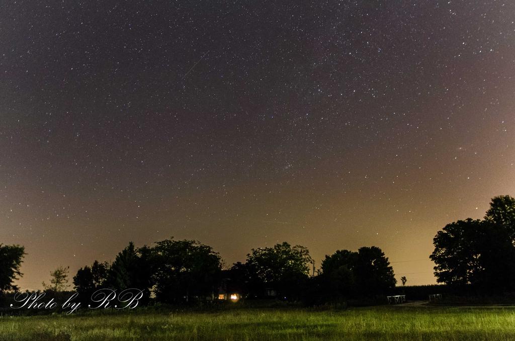

Here's one of the first ones I did.

I think I've gotten better over time. I hope anyway... So, the number one recommendation I can come up with, is to just get out there and do it! You now have all the basics on the settings you need, get out there and try them! Do variations on the settings, change things up, see what the changes do, it really will help! I went from taking a hundred exposures to get the first photo I posted, to taking only four for the last one I posted.
