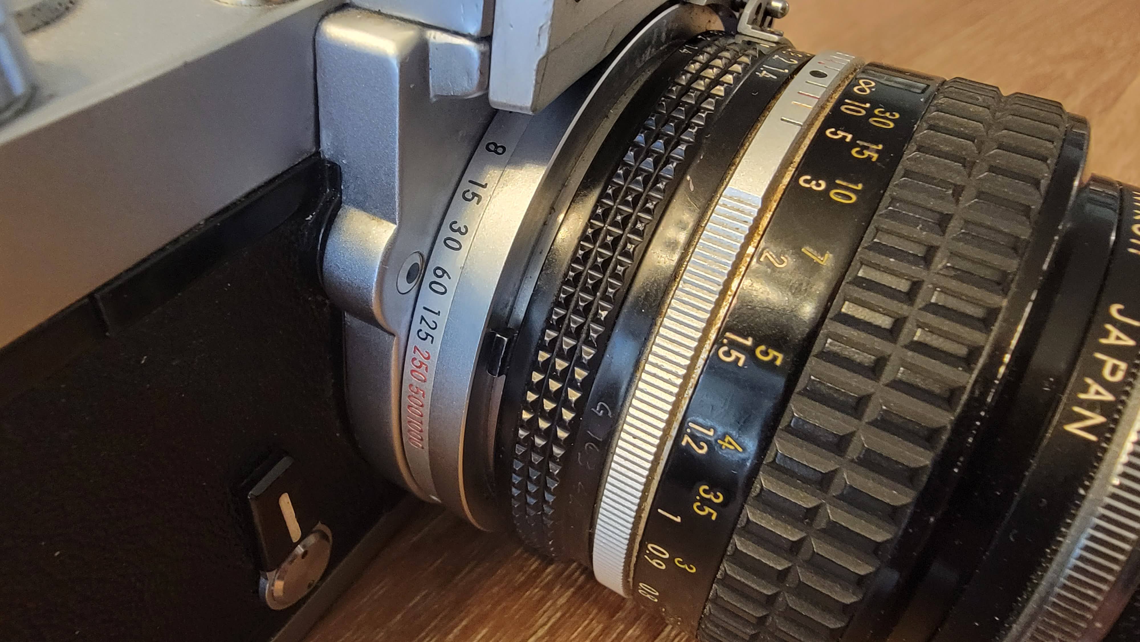

Just got my Dad's Nikkormat FT2 out and shot a role of color print film. Waiting for the results. The meter connection with the shutter speed ring is intermittent. Does anybody know how to fix it. When it makes a connection the meter works fine. There seems to be a little play in the shutter speed ring (front to back).
