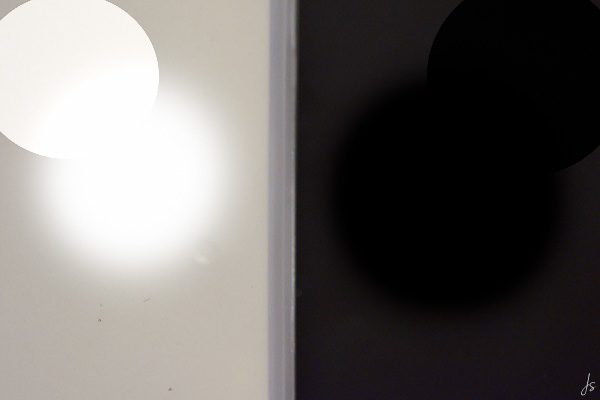

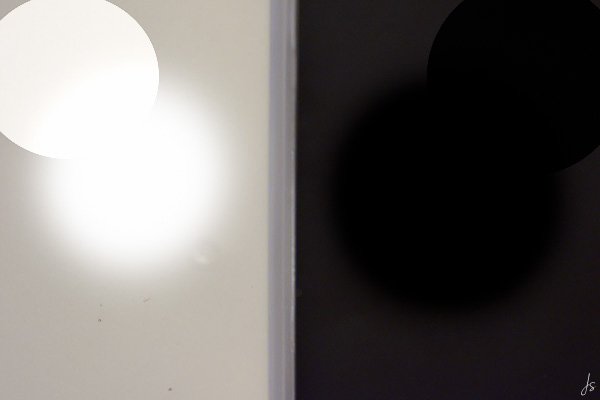

J-see
This is the shot having painted pure white and black into it.
WayneF
It is not really about WB. You have the materials to do the easy perfect experiment to see the absolute truth about how meters work.
Do a metered picture of each the cards (white, black, and gray). Three pictures, close enough to include only the one card in each view (to rule out other colors, other effects).
See? That is how reflective meters work. (incident meters are different)
(focus on a blank card is difficult, but it need not be exact focus for this... Just use manual focus).

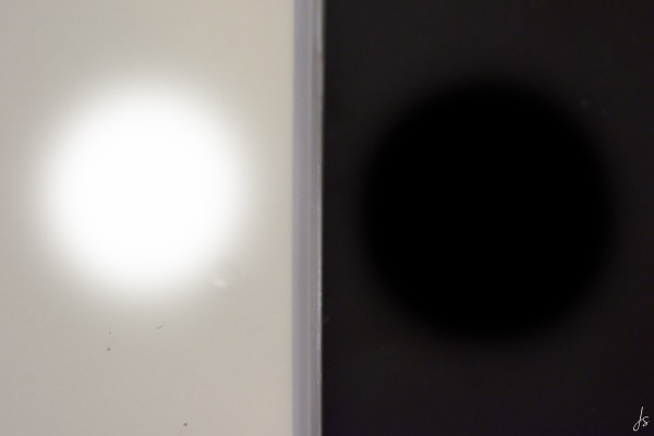

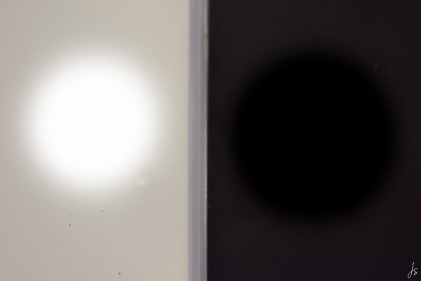

J-see
I did and posted them in the reply before. I used the macro to rule out any accidental metering of something else. The first I shot both next to each other, the second and third both separate. White and black become reasonable similar. They're slightly different but there's probably a margin of error. I didn't have grey but if black and white become grey, it showed what I needed to know.
If I want to adjust exposure to make them both match pure black and white again, I have to overexpose white 1.60 in LR and underexpose black 3.60. Only then they merge into the pure version. That's the shot including both.
The separate shots of white and black need around +5 and -5 adjustment to become pure again.
