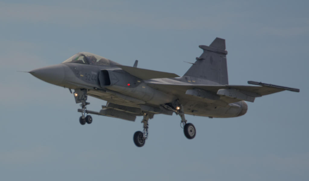

I have tested it now under controlled conditions the tripod against my old lens. There is noting to choose between the two....
This is the Sigma 150 - 600. Static on tripod

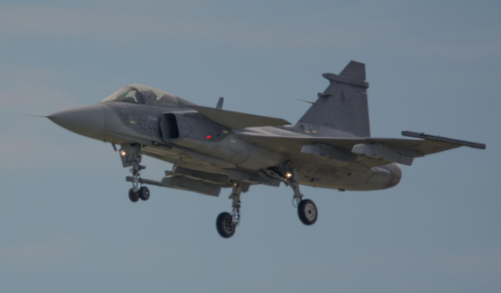

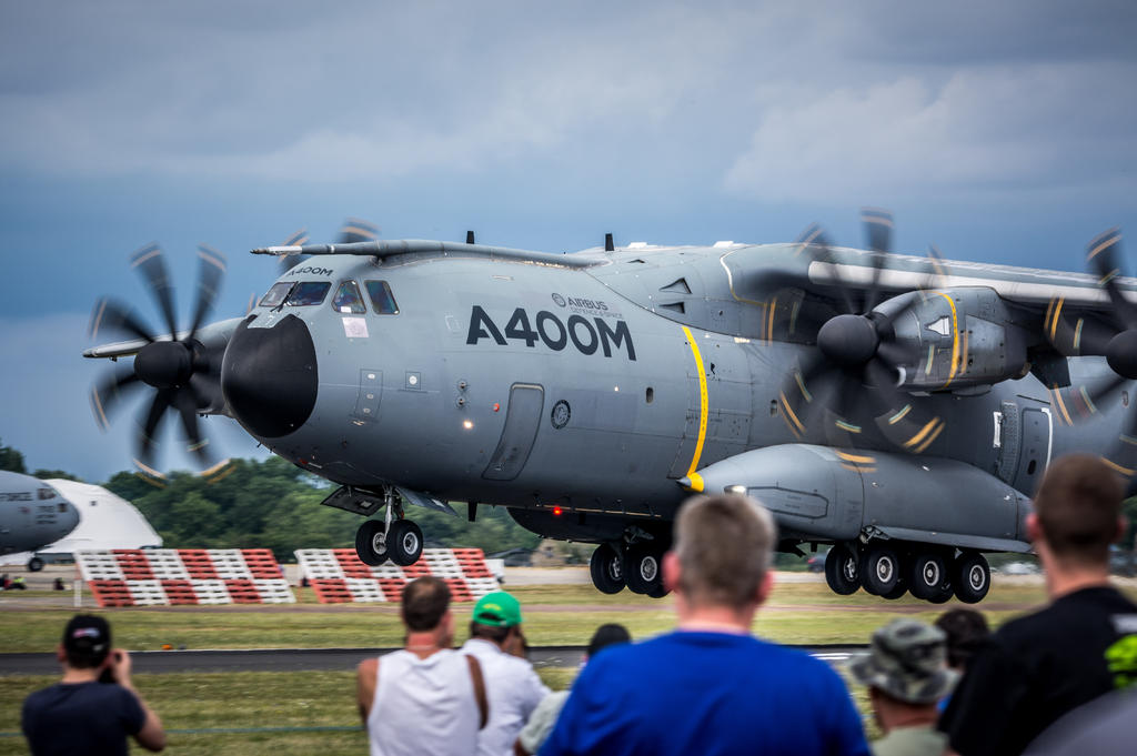

This was one from the airshow yesterday. Whilst I know its wide open at f6.3 as opposed to the one above at f8, it just looks wrong. I appreciate its softer at f6.3, however this looks very poor. The point of focus was just below the cockpit on the engine intake

That one looks like bad air. There is a great distance there and lots of opportunity for humidity to get in the way. The sky is not so blue either, making me wonder about humidity. I live in New York and it's hard to get a good plane shot in the summer. Same with the moon. I get my best long distance shots when its miserable cold out.
Shy Talk
Well, Trev. It looks like it's ok optically, so I guess you are just going to have to learn how to use it.
Using a 70-300 is just not the same as your new lens.
Are you using back button focus? I find it essential for moving aircraft.
Must say though, that I agree about your Gripen shot. Looks crummy.
There's kinda a limit to what you can do though sometimes, my lens does well normally, but I shot at Miramar a while ago and my shots were all crap. It was just too hot!
Theres days when you can shoot nicely at 300, but struggle at 600.
Cant think what else to suggest other than to practice using your new lens.
btw, if I remember right, Cosford is one of these shows where the light is wrong. That wouldn't have helped shooting that jet. It looks backlit.

Thanks Shy Talk. Maybe it is me. I don't know
The Gripen was from Yeovilton yesterday. It was partially backlit and it was a scorching hot day (if that had an effect)
I have tried back button focus and struggled with it. Perhaps I should try it again. I am at Fairford next weekend for a few days so plenty of time to experiment and practise. The sun there is behind you for most of the day.

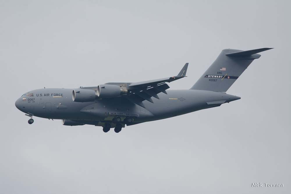

nickt

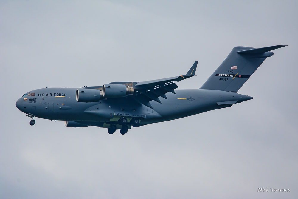

Here is my typical 'bad air day' shot. Very humid. Taken with the Sigma 150-600 C
Straight from camera
Tweaked up in LR
Still crappy in my opinion. Maybe if I was better in post I could do more fix shots like this, but when the air is hot and thick, its tough.

I don't know if the sir was bad yesterday
I have viewed quite a few other shots people took yesterday at the same show that were crystal clear

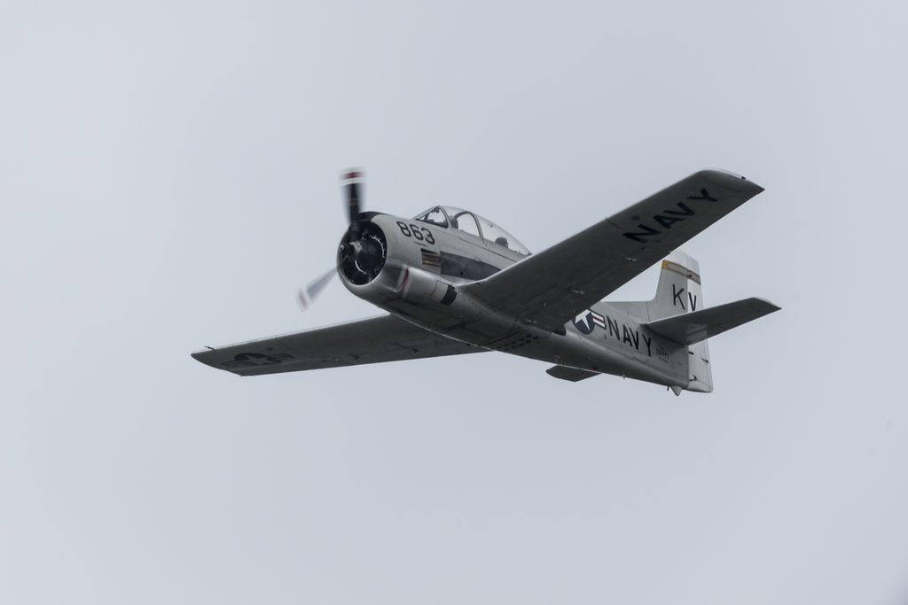

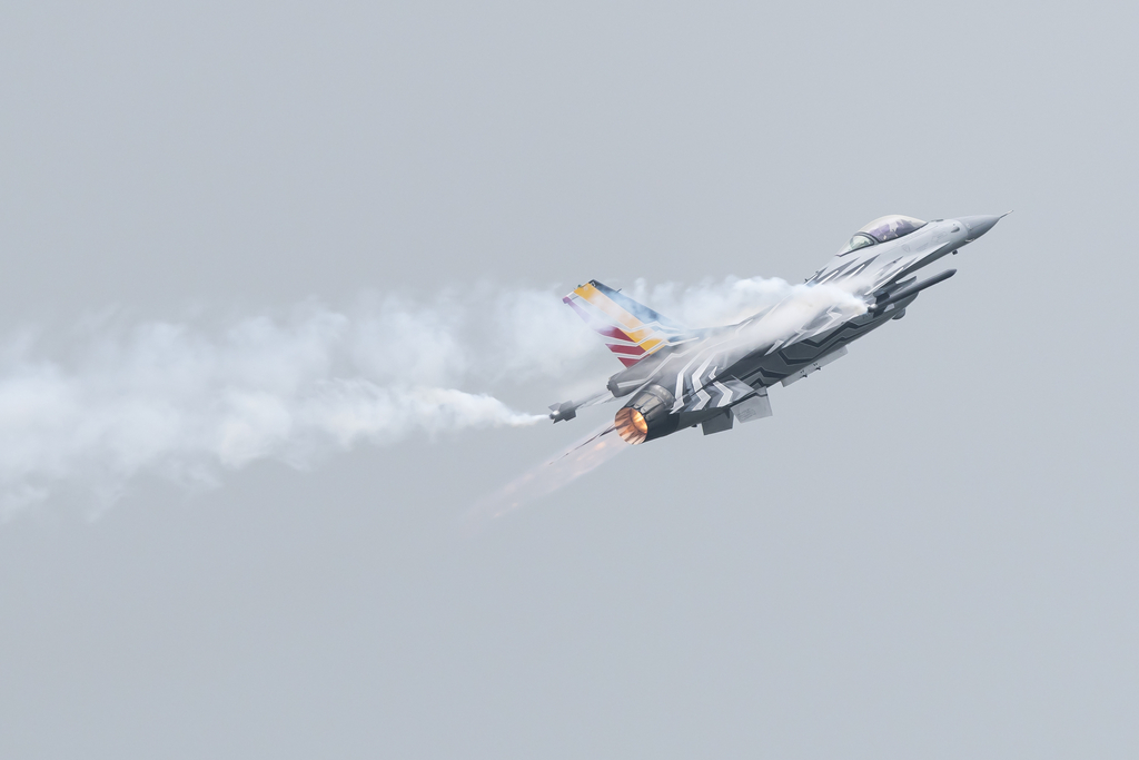

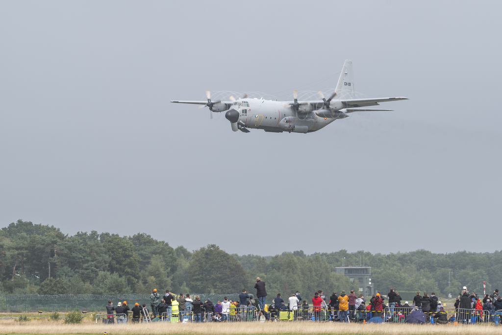

Ad B

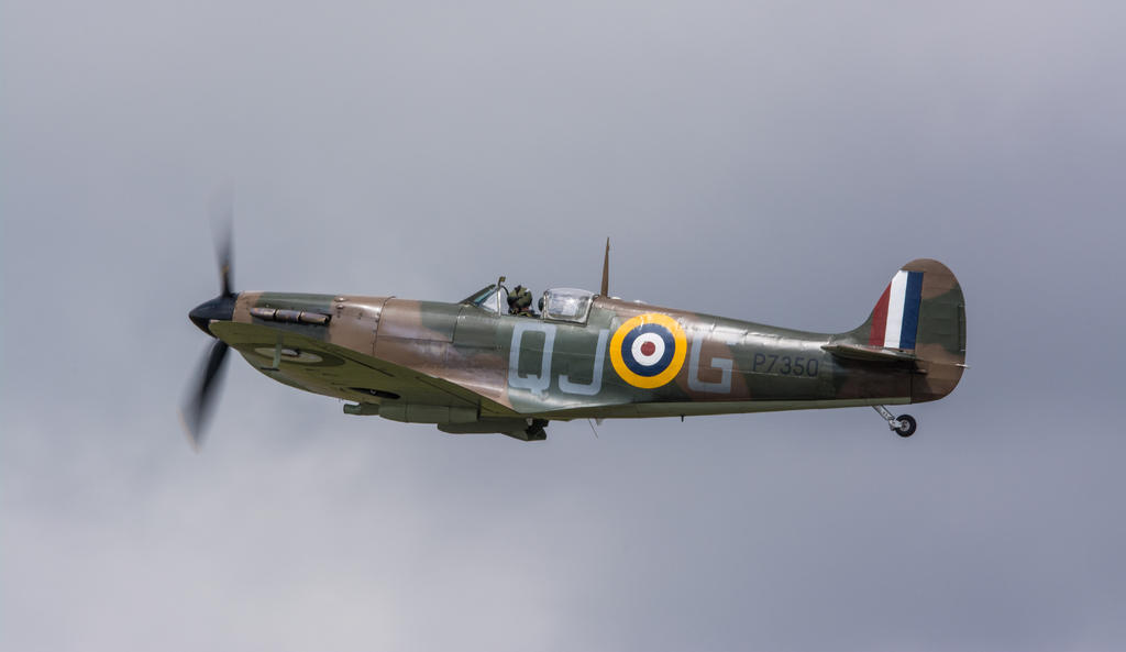

I have this lens for two years now and I'm very satisfied with it.
A bit more than 1,5 years ago I went to a spottersday in Belgium.
600 mm
600 mm
600 mm
150 mm
The weather was first rainy, later clouded and damp.
At that time I had this lens only a few months.

I never had problems like this with my 70 - 300. I had several photos from this show where the focus point is bang on the aircraft but the shot is out of focus despite high shutter speeds.
I have viewed lots of shots from the same show (many with compositions identical to mine) and they are tack sharp, so I don't think it was atmospherics

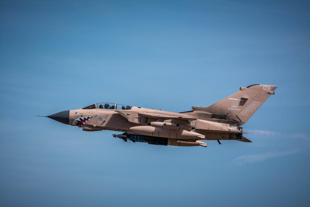

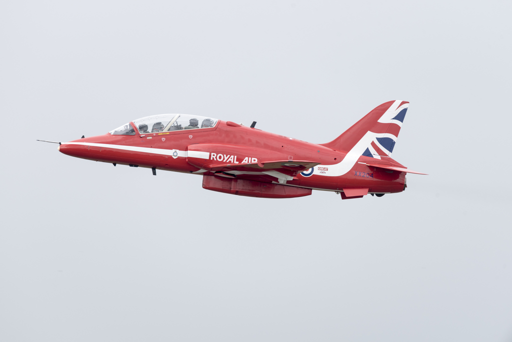

Well it looks as though the old lens wasn't right after all. These photos were shot at the weekend with the new replacement. Happy days!
