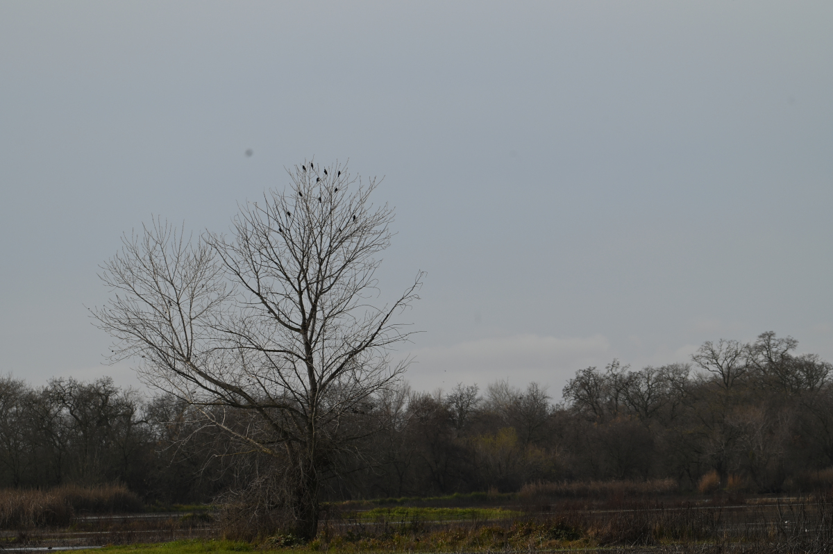

I think my z6ii hit the dirty sensor issue (see the image below, shot with z186 + TC1.4, FL = 252mm).
First I use Zeiss Lens swipes to clean both z186 and TC1.4 with no effect: can still see the left mid-upper dot in EVF. Then I activate the built-in sensor cleaning twice but still see the dot which seems to become smaller and moves up a bit though. It looks like the manual cleaning on the sensor is calling. Did anyone use lens swipe for the job? I deem a blower is little use but cleaning swab/sensor cleaner may be due for the work. Any advice, tips, or suggestions?

There is a plethora of videos/information on sensor cleaning on the 'net but if you don't feel confident enough to tackle the issue yourself - and the danger is that you could ruin the sensor or do other damage - then I would have it done professionally by a company that offers a guarantee on their work. In the meantime, the software Clone tool / Spot Healing tool or their equivalent is your friend.
Fred Kingston_RIP
I would try the blower first... If you got a "wet" glob of something while changing the lens... not unusual, the blower might not be sufficient. Then it's wet cleaning time... They sell "Full frame and Crop" sensor swabs specifically for cleaning sensors on Amazon... they're sterile single-use swabs... and "Eclipse" optic cleaning fluid. One drop on the swab and one swipe with the swab is usually all you need... It isn't rocket science... there's a procedure... as mentioned, there are numerous tutorials online. I'd never pay someone to clean mine... Once you do it yourself and see how easy it is, you probably won't either. Just don't do it in a crowd of people... Set aside 10-15 minutes of quiet time with your stuff laid out on a clean surface area, and go slow when no one or anything will interrupt you...
TwistedThrottle
Yup, I always start with the rocket blower with the sensor facing the ground. I use a swab after all other cleaning techniques have been used to minimize damage by dragging anything across the sensor. It feels intimidating to clean your sensor for the first time but It’s really not and has become just another step in maintenance. Just put one drop on one swab and swipe the sensor one time with minimal, even pressure. Most cleanings take once for me but you might have to repeat the process with a new swab if it’s still not clean after the first one. Watch a couple vids, take your time and don’t reuse swabs.
Clovishound
I got something that was likely oily on my sensor soon after getting my Z5. I was afraid I had ruined my camera. I was extremely nervous cleaning it. It took several swabs to completely remove whatever it was. I've had to clean it several times since. Those only took one quick swab. I try and be very careful when swapping lenses. One of the downsides of mirrorless cameras is the sensor is rather exposed with the lens/body cap off. Some of the newer mirrorless cameras have automatic sensor covers, or sensor coatings to protect it. I have never had to clean my DSLR sensor.
BF Hammer
I have used the wet swabs on DSLR sensors and my Z5. Yes, try to blow off with a rocket blower first. Honestly, the Z bodies are very easy to clean by swab. You remove the lens and the sensor is right there and close to the opening. No inspection light needed.

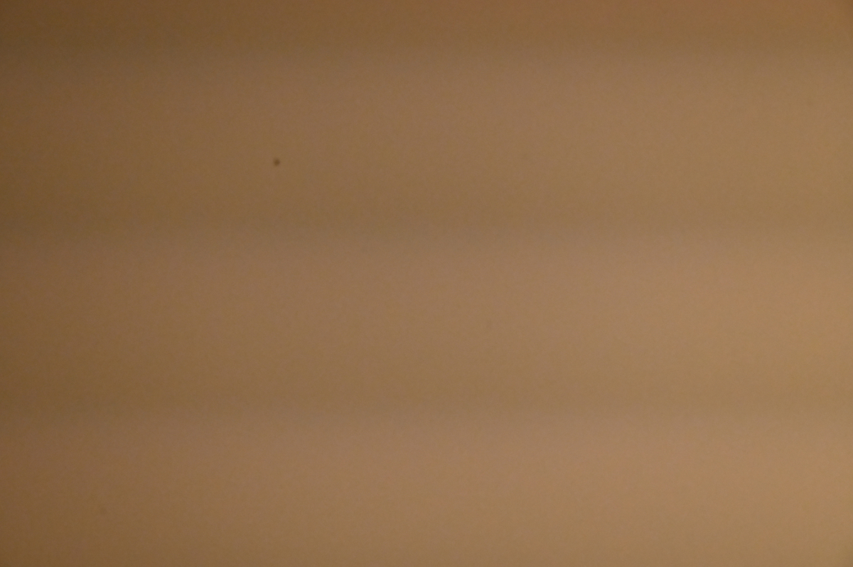

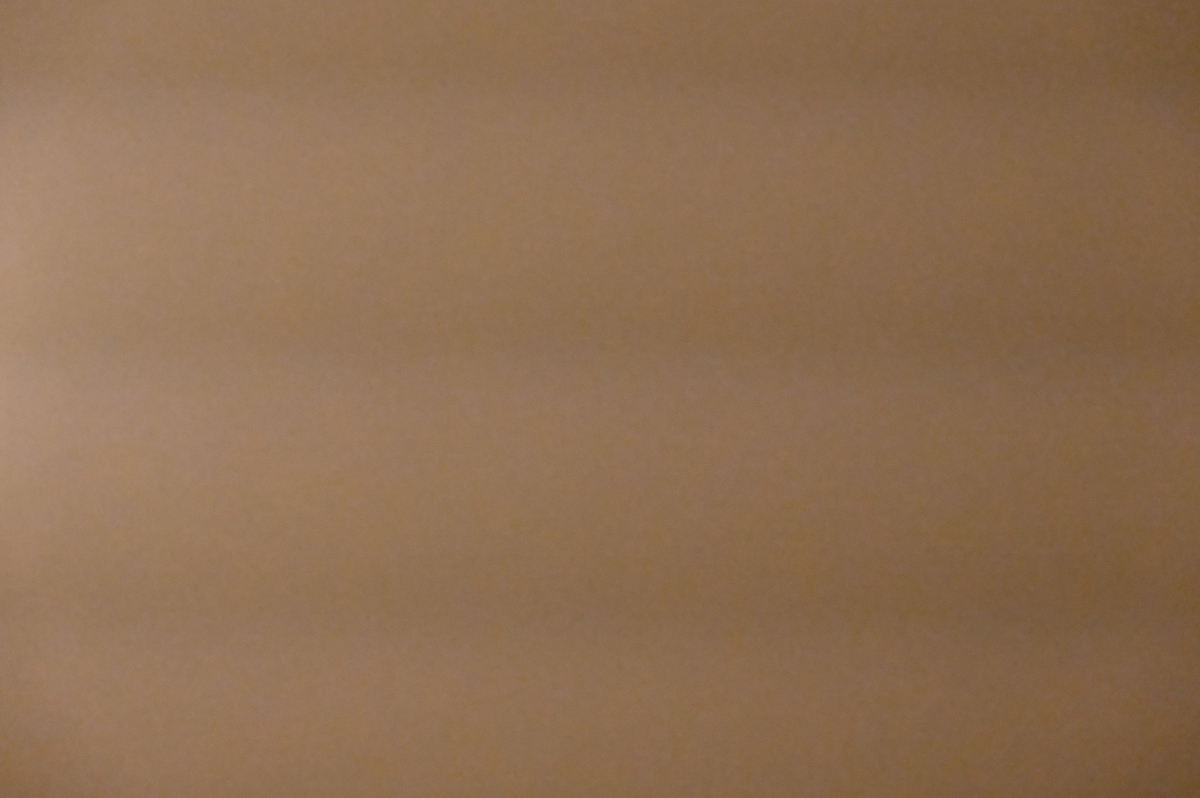

Received the cleaning swabs and used it with success. However, it looks like the width of the swab (for full frame) is a little smaller than the width of the sensor (z6ii). Is that a concern? But thank you guys!
Before:
After

Your test shots look good. They make various magnifying loupes to aid in sensor inspection. I just check after against blue sky if I can find any. I believe all the swabs are a bit smaller than the sensor the one for my D7100 are, haven't ordered for the D810 yet.

That looks clean enough as anything smaller that you can't see without a loupe is unlikely to show up on any picture.
