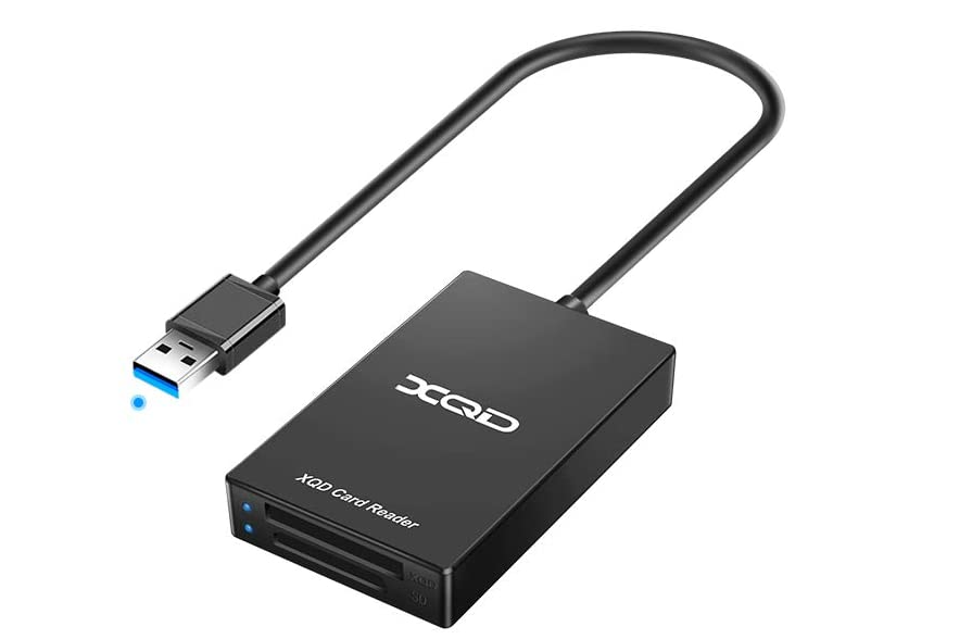

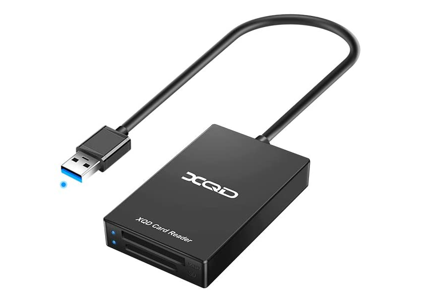

[h=1]XQD Card Reader, Rocketek USB3.0 XQD/SD Card Reader Dual Slot Memory Card Reader 5Gpbs Super Speed Compatible with Sony G/M Series, Lexar 2933x/1400x USB Mark XQD Card, SD/SDHC Card for Windows/Mac OS I thought that the one I had purchased was bad, the company reached out and sent me another one. I the replacement worked much better than the first one. the XQD worked 1 time with the new one and then didn't work right again. But so far after the hard format we are still good. I just havent had the time to shoot much I wish I could provide better information on my Sony card. Now that it is working I am happy with it.

This is the card reader I purchased on Amazon. The replacement that was sent by the company has been better than the one purchased.
