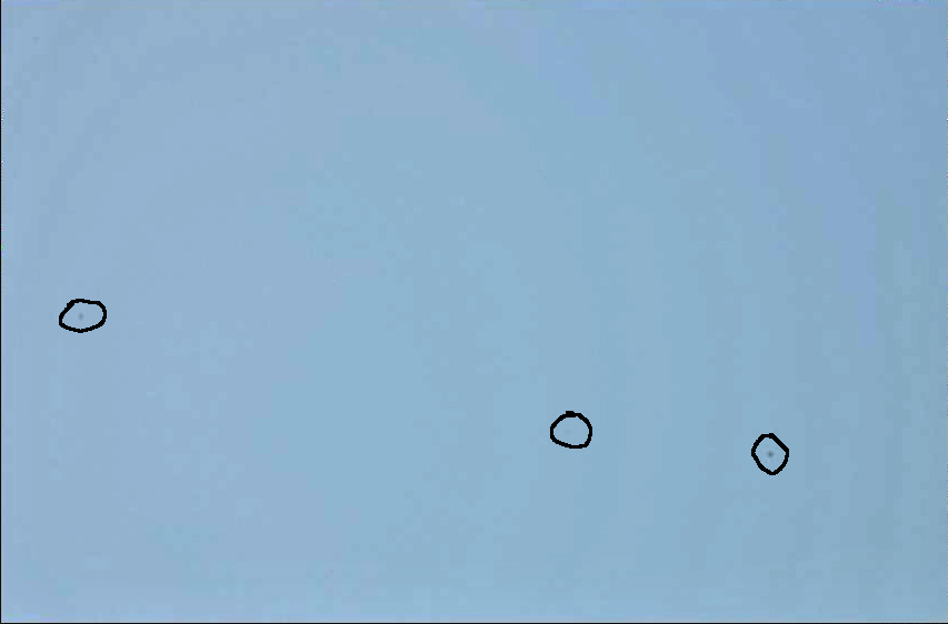

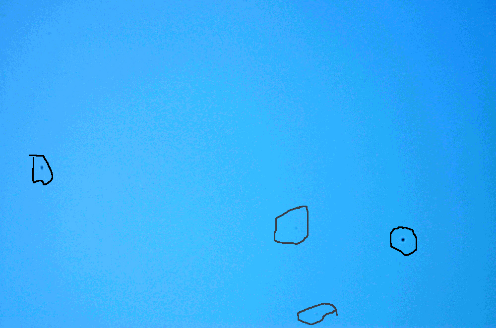

Roy, I only found 3 of the 4 that MikeW found. If you look closely at both of our photos, it almost looks like there is a circular splotch on the sensor. So I've got to ask...did you clean the sensor with some type of sensor wand and go in a side-to-side motion, or did you go in a circular motion? That pattern might be from whatever you used for your test shot, too, so it's possible it isn't really on the sensor. I adjusted the shadows in PSE10 to bump up the spots in this photo just like I did with my D600 test shots.
I do have a huge package of Pec-Pads left since I don't think I'll be needing to clean my sensor quite so often with this D610. If you want some, I can put several in a zip lock bag and send them to you--you'd need some type of sensor wand to attach them to. I reused a Sensor Swab wand for mine. First I saved the used Sensor Swab material and removed it from the wand. That's what I used to create my pattern. For the FX size, 1/2 a Pec-Pad was exactly what I needed. I folded it exactly the same way as the Sensor Swab making sure a little hung over the edges of the wand just like the original Sensor Swab did, then I rubber banded it to the wand. If you are interested in some Pec-Pads, you can PM me.
At least yours doesn't look nearly as bad as my D600 did! ;)
