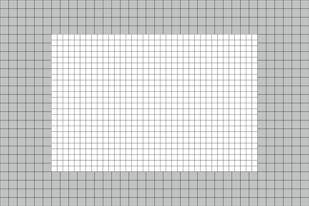

A sensor is made up of pixels which are spread out evenly over the entire area. An FX sensor is 36mm x 24mm, which is essentially the same size as a piece of 35mm film, hence the full frame designation. A Nikon DX sensor is 24mm x 16mm. This graphic shoes the relative sizes, with FX area being the full 36x24 box (each box represents 1mm), and the DX area being the white center 24x16 section...

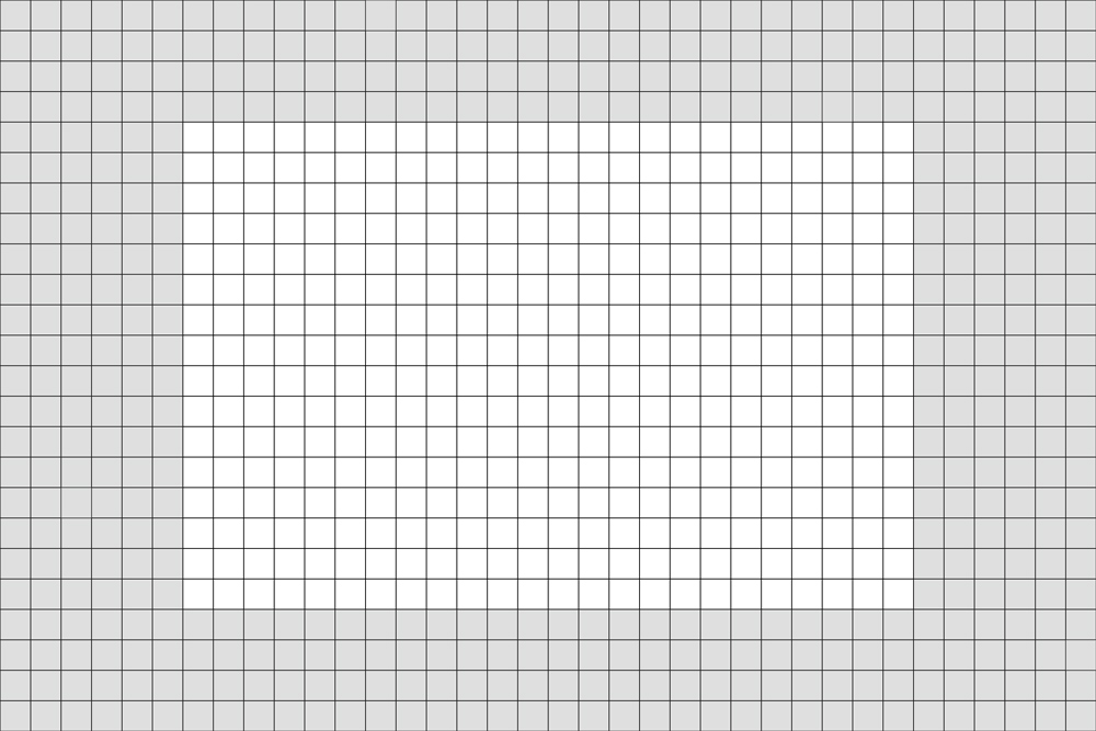

The thing is that DX sensors are generally not packed full of pixels in the same manner. My D610 is a 24MP FX camera. My D7100 is a 24MP DX camera. Both sensors have 24 million pixels, so it stands to reason that if the DX sensor is that much smaller then those 24 million pixels must also be smaller in order to fit the same number of pixels in a much smaller area.
