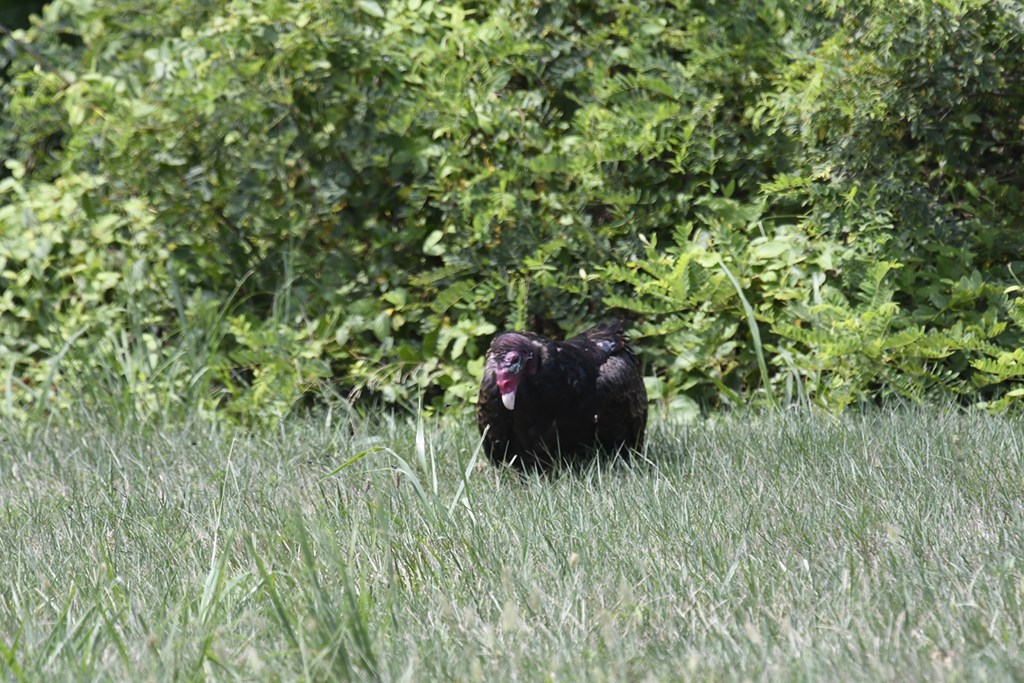

For some reason, the following image looks to have back-focused. When I support the camera/lens, I try to hold it at the tripod foot or on the hood without touching the focus ring. This back-focusing is new for some reason. Simply used the jpeg SOOC and resized for the forum. No additional editing was done. No cropping.

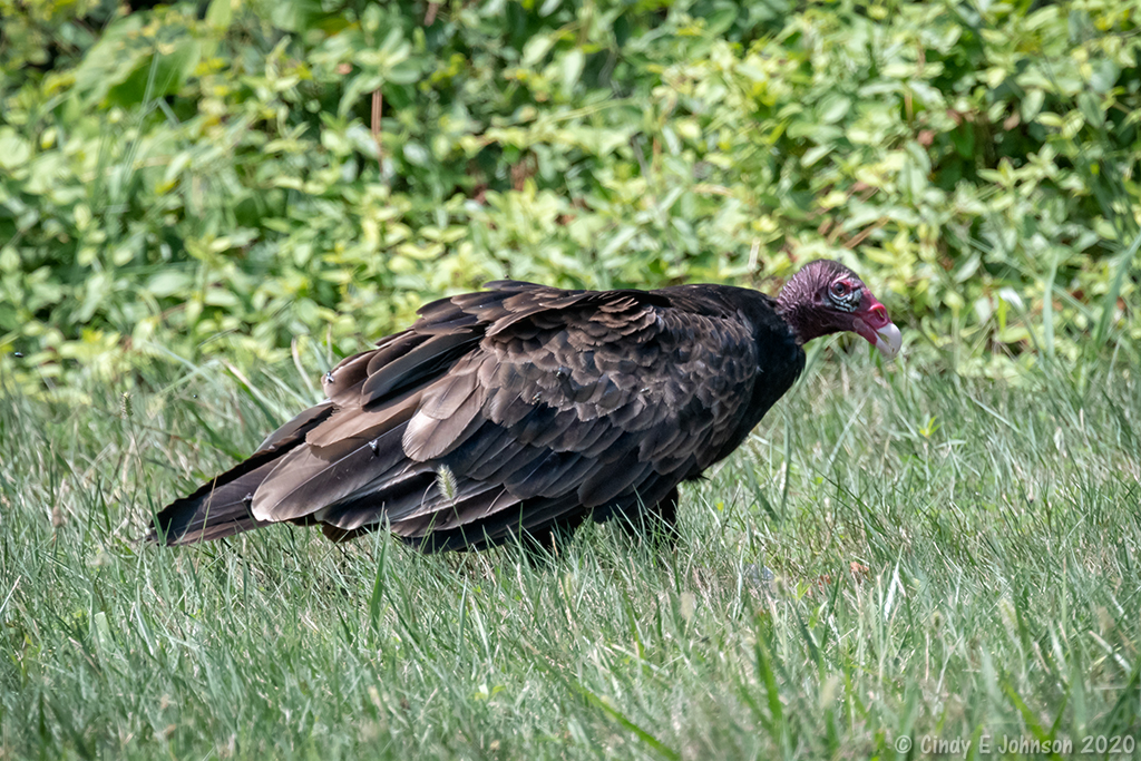

Quite often when it misses focus, it seems to front-focus like in this image. Simply used the jpeg SOOC and resized for the forum. No additional editing was done. No cropping. Any comments and/or suggestions will be appreciated. I tried to maintain a consistent shutter speed (one that I tend to use regularly) when possible.

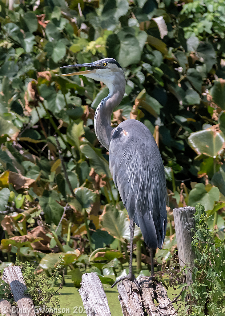

A couple days ago, someone posted on Facebook about a Great Blue Heron that was injured. Typically we don't have too many of these birds around here so I was concerned the injured bird might be the one I've photographed in the past. The injured heron was picked up by a volunteer and taken to a Wildlife Sanctuary - haven't heard whether or not the heron lived as someone thought it might have been hit by a vehicle. :(
I went out in search of the heron I've photographed in the past knowing the odds of seeing it would be slim. Usually I only see it on weekends when there are fewer people and less traffic. Thankfully I saw it and was able to take some photos. This is a decent sized crop from the original as I wasn't that close.

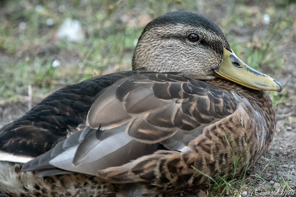

Here is one from yesterday's outing with the 300mm f/4 PF coupled with the Nikon 1.7x TC. No cropping was applied. I was less than 15 feet away so my depth of field is less than 1" - which is why the feathers on the far side are blurred. Was aiming to keep the feathers in the foreground in focus. Since my ISO is capped at 4000 and this was shot in complete shade from trees, it was a juggling act to keep a high enough shutter speed without underexposing the image too much. The exposure was raised a little during post. The only sharpening applied was in Camera RAW at 40.
I am happy with this because I can always apply additional post processing if desired. But this is SO much sharper than what I got the last time I was out with this combo. Obviously something with the lens works intermittently.

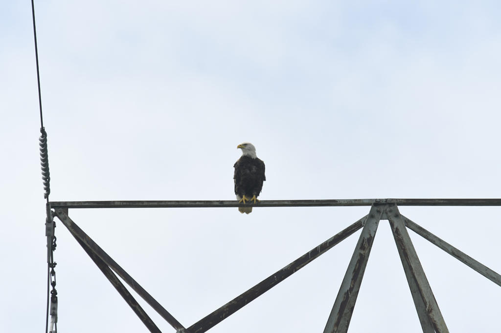

*sigh* I'm beginning to think @BackdoorArts was right. This combo of the 300mm f/4 PF and the 1.7x TC just doesn't quite cut it. :(
Almost everything I shot yesterday was terrific. However, today I used the combo for an eagle on a utility pole that was in the distance, and absolutely everything is very soft with front focusing. The other day I coupled the TC with my 300mm f/4 non-VR lens for an eagle on the same pole. The results were a tad better but nothing impressive.
It seems the pairing works better when the subject is closer. But when the subject is further away, somehow it adversely affects the AF system - at least for f/4 lenses.
I need to go back to pairing my Nikon 1.4x TC with this 300mm f/4 PF to identify if any AF issues are present. When I used that combo in the past, the results were stellar. It's possible the lens might not be the issue after all. Putting a 1.7x TC on an f/4 lens means it becomes f/6.7. And that might be the problem. I can't believe after all this time of not seeing any eagles then suddenly seeing one twice within a couple days left me with nothing to show for it. :beguiled:

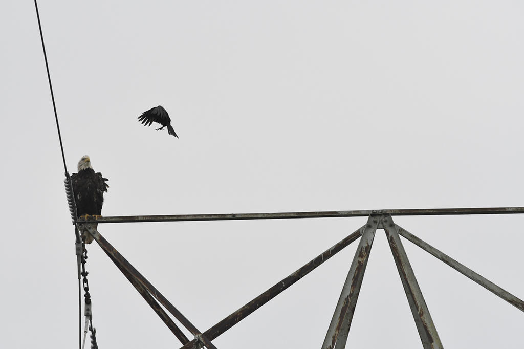

Here are two photos - both are jpegs sooc only resized for the forum. No additional post processing was done. The first was taken with the 300mm f/4 non-VR lens. The second with the 300m PF. While I was shooting the second batch of pics (different day), the sky changed from being overcast to having a little bit of brightness. But the ones that were taken with overcast skies suffered even more with softer focus. For some reason, when the distance to the subject is further away, the lens front focuses. But that isn't the case with most photos taken at a closer distance.
In this first image, the eagle let out a pitiful screech. The crow appeared from out of nowhere and initially sat on the beam several feet away from the eagle. Eventually the crow antagonized the eagle, but the eagle didn't do anything. After a while, the crow left.
In this second photo shot with the PF a couple days later (which has VR that seemed to engage properly), the focus is much softer on all the images. Yet if you scroll up and look at the duck photo from the other day, the focus was accurate.
