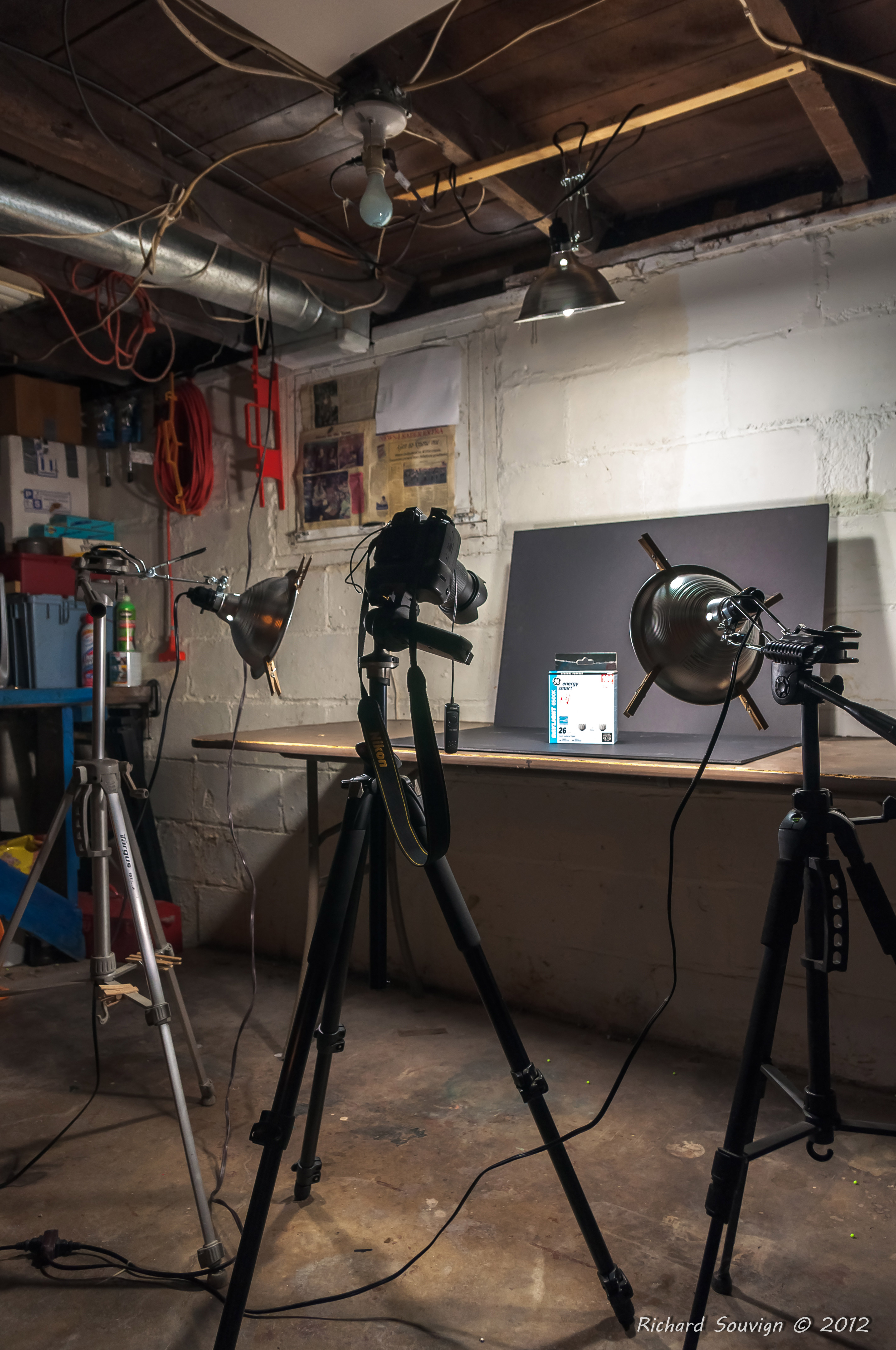

Aw come on now Jack. It's an old basement with an old table and lights. It's really nothing. Don't get anyone's hopes up. Now I'm going to have to clean it :mad: LOL
I'll make a 365 out of it tonight, got nothing in mind for today anyhow and I'm working late today so it will fit right in for me.
I don't mind sharing. A lot of what I have learned is from other members here. Then what I'll do is go out on the Web and try to find out more information. Gather up all things in common and try to make things work with common items I can easily acquire.
Really nothing to it, Yeah it might not look pretty and I got to watch myself how I move around because of all the wiring I got for all three lights and three tripods, but it works.

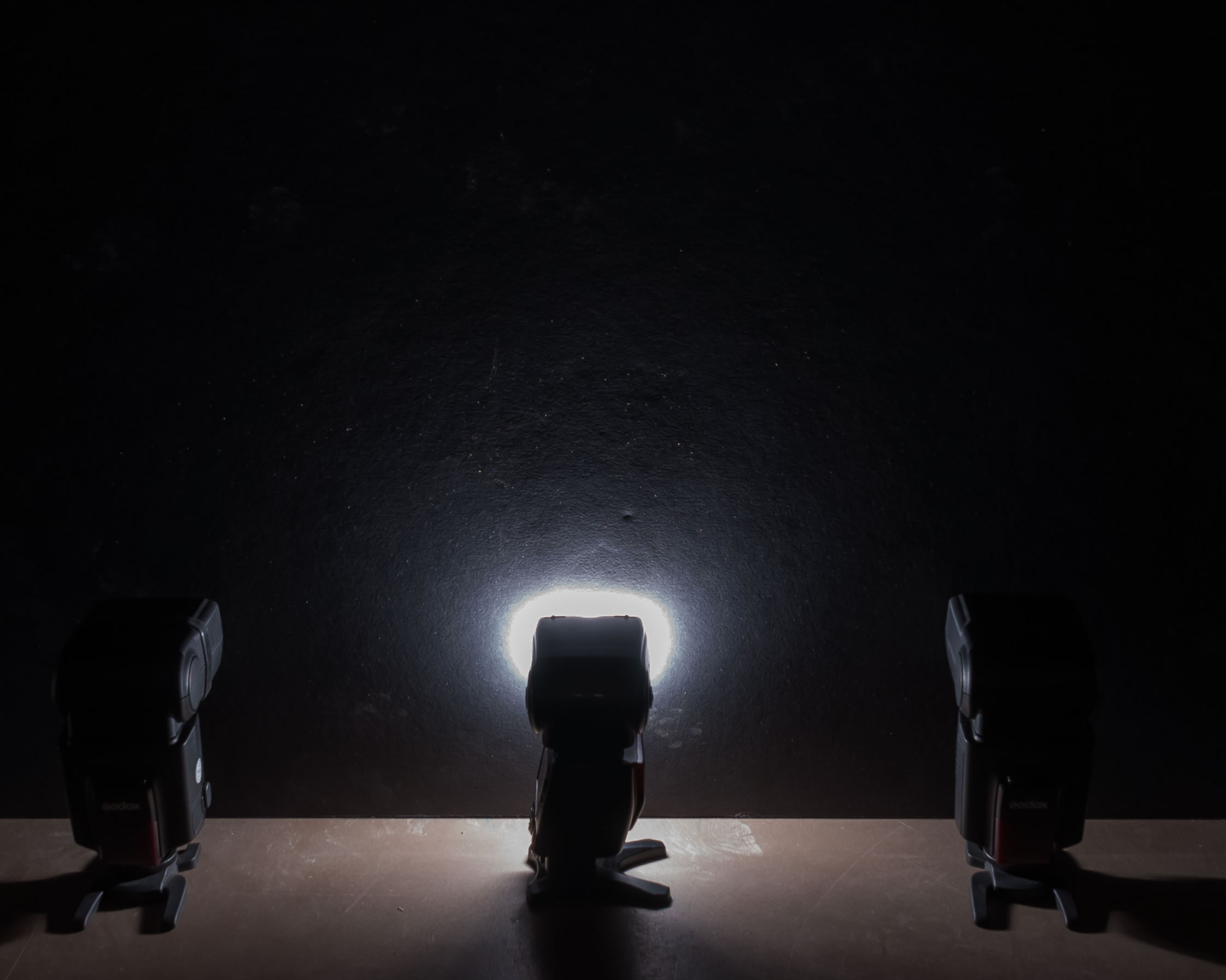

Not firing on all cylinders
Trying to use (2) Godox TT560 and (1) SB700 in Commander mode. I can see all three Speedlights firing, but the TT560's are going off just before the SB700, and the shutter is capturing the SB700 flash only. Was able to get the shutter to capture the TT560's but not the SB700. I've tried every combination of flash mode, shutter speed, apertures, and moving the speedlights in different positions and still no luck. Can't get the shutter to capture all three flashes at once. Been at this all day and I have had enough camera's and flashes, so that will explain today photo.
Next step is to get some radio triggers and give up on the fact the Commander mode is not going to work.:mad:

Rick, do you have all 3 flashes on the same channel? And what about the A B C settings? Also, your built in camera flash has to be up to set off the flashes, too. Just wondering.
AxeMan - Rick S.
I would have to set it up again and see. I been all over the place with settings so looking right now I don't know if the settings I left on the camera and flashes were the one that worked.
I know for sure that I was in this setting, not sure on the groups, but I can tell you changing groups in camera had no effect on the out come because it was all tried, I think.
D90
f/8
1/60th second
Commander mode:
Built in flash = -- (This should fire off the flashes, ok at least the SB700 for sure)
Group A (? Don't know)
Group B (? Don't know)
Channel 1
SB700
Remote Mode
Group A
Channel 1
Both TT560's

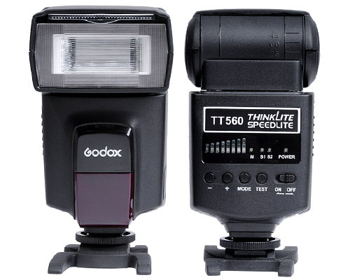

S1 (I would guess this stand for Slave one, my other choice is "S2" and "M")
To save time I lifted this photo off the web of the TT560's
not much of a choice here to chose from as you can see.
I did come across a configuration that all three flashes do fire, (ok, they are all working together) but I can almost see by eye the TT560's firing off just before the SB700 and the photo proves it.
I also tried turning and moving all the speedlights so the sensors were facing the camera. No matter how close or far away or apart, I get the same results, the camera is only capturing the SB700's flash no matter where or how the speedlights are placed.
I wish Curt was still active, he has the same flash and I thought he got them to sync up together, but I'm not sure if he did it buy CLS or radio triggers.
I guess in the long run radio triggers will be better, I was just hoping to take advantage of the commander mode for now.
