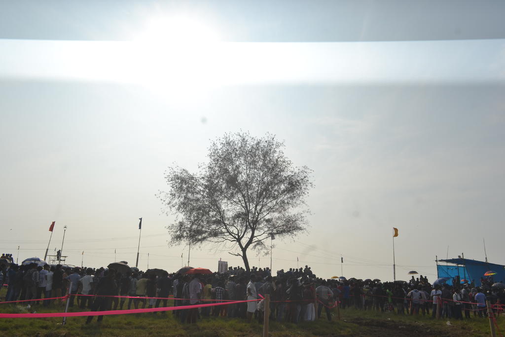

PROBLEM WITH PHOTOS TAKEN IN DAYLIGHT IN D3100- please help

I dont know too much in detail. When im taking photos with low sunlight , im not getting those white lines over there , but i can feel and hear the shutter or mirror is moving slowily when i took photos in live view rather than using the view finder

I dont know in detail. But i, having no problem when ever im not taking photos in daylight. But when i took a picture of a cfl lamp in high shutter speed, i can see the white shade and i can hear the shutter or mirror down going sound in slower when im taking photos in live view. Still i can take pictures. But the mirror sliding sound is little lagging when its in live view mode

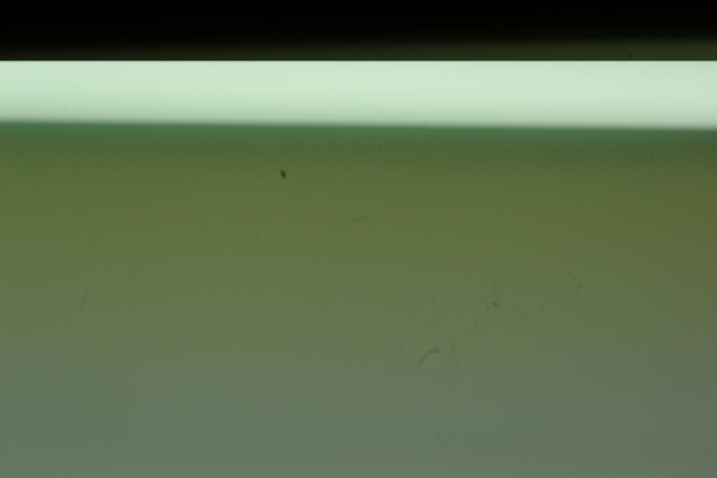

THis is the photo that i took in M . would someone please help me with it

Hi friends, i consulted a nikon service center here and they said it is of shutter mirror mechanism problem and will cost 60$ for repairing it. And they said that the problem only exist when taking at higher shutter speeds only. And i have decided to take it to them rather than trying to repair it my self. Thanks for everyone who helped me in this topic. Even it was a coin-incidence to join this forum since my camera was down, Now i m thinking my self why i didnt join this forum alot early? Ive taking photos since 3 years starting from my nikon d40 and now at d3100 now. I will be a active member here from now on. Thanks
