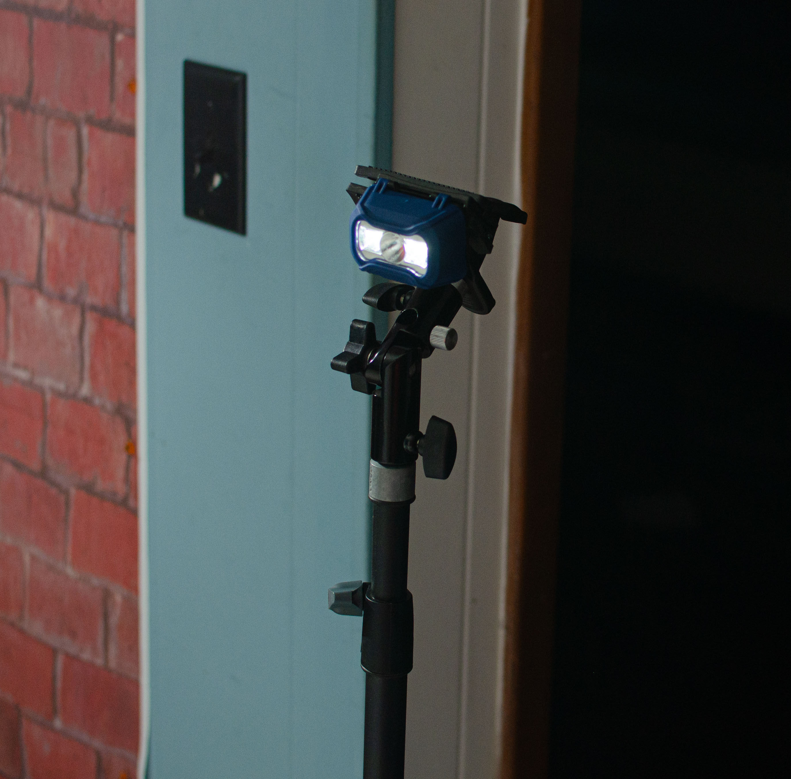

I don't want to go down the AF assist route. In experimenting with my D7000 and all the focus mode combos I found AF-A/3D got the best results. I do newbie models often and most of them can't stand still but rather act like they had too much caffeine. So the solution is to being list. I just got back from Walmart and got a small wearable 100LM light which I will attach to a stand that has a clip for holding reflectors. I will turn off the lights at my studio and see about placing the light for the camera to normally focus and then see about what settings I need to make sure the flash covers the light that will be used for focusing.

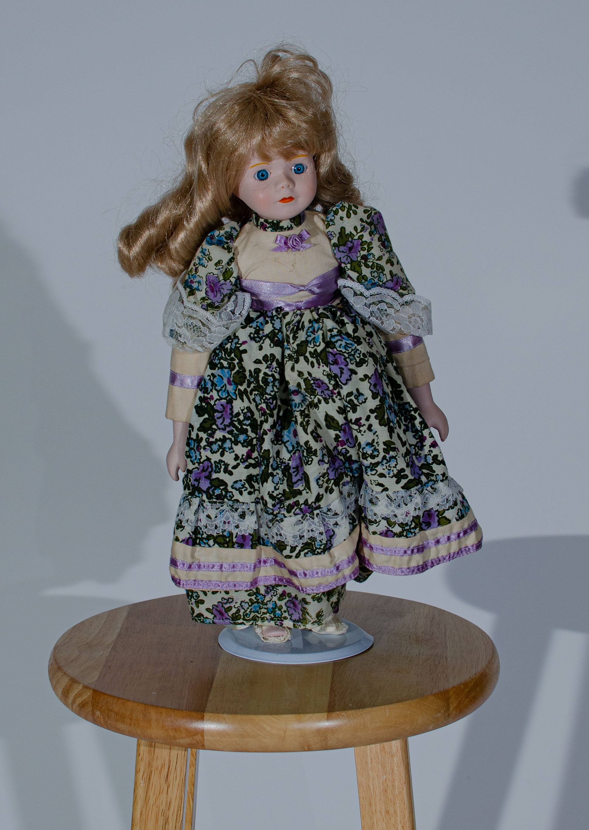

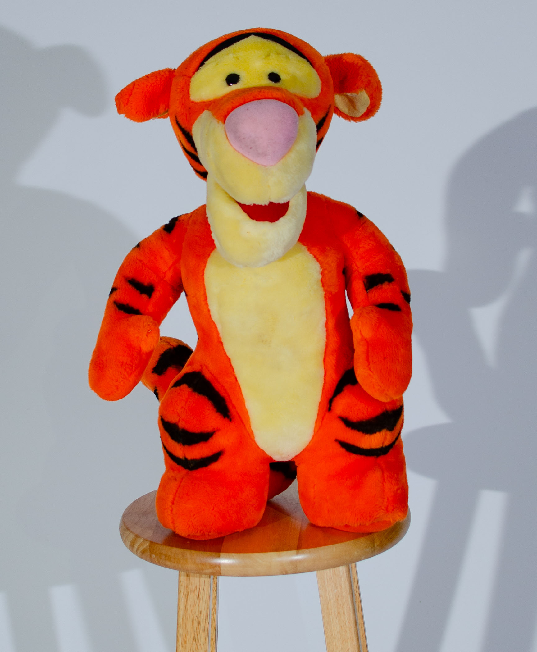

I tried it out just now and it worked well but one thing. The focus was fine in the dark with the 100LM light but I am seeing shadows. I have my two strobes at 4&8 o'clock and did not get shadows on white. On these test images I am seeing the shadows of the bar stool that the two dolls are sitting on. Both flashes are on 1/32 power. What do I need to adjust to get rid of the shadows?
Fred Kingston_RIP
First, move the stool further away from the wall... giving you some depth behind the subject... you'll understand why in a moment... There's this rule about light and how if falls off exponentially... you want to turn your light's power down to their lowest, FASTEST setting... so the light falls off... Same with your lights, move the lights further back... You should be able to find the sweet spot between lowering power and moving everything back away from the background...

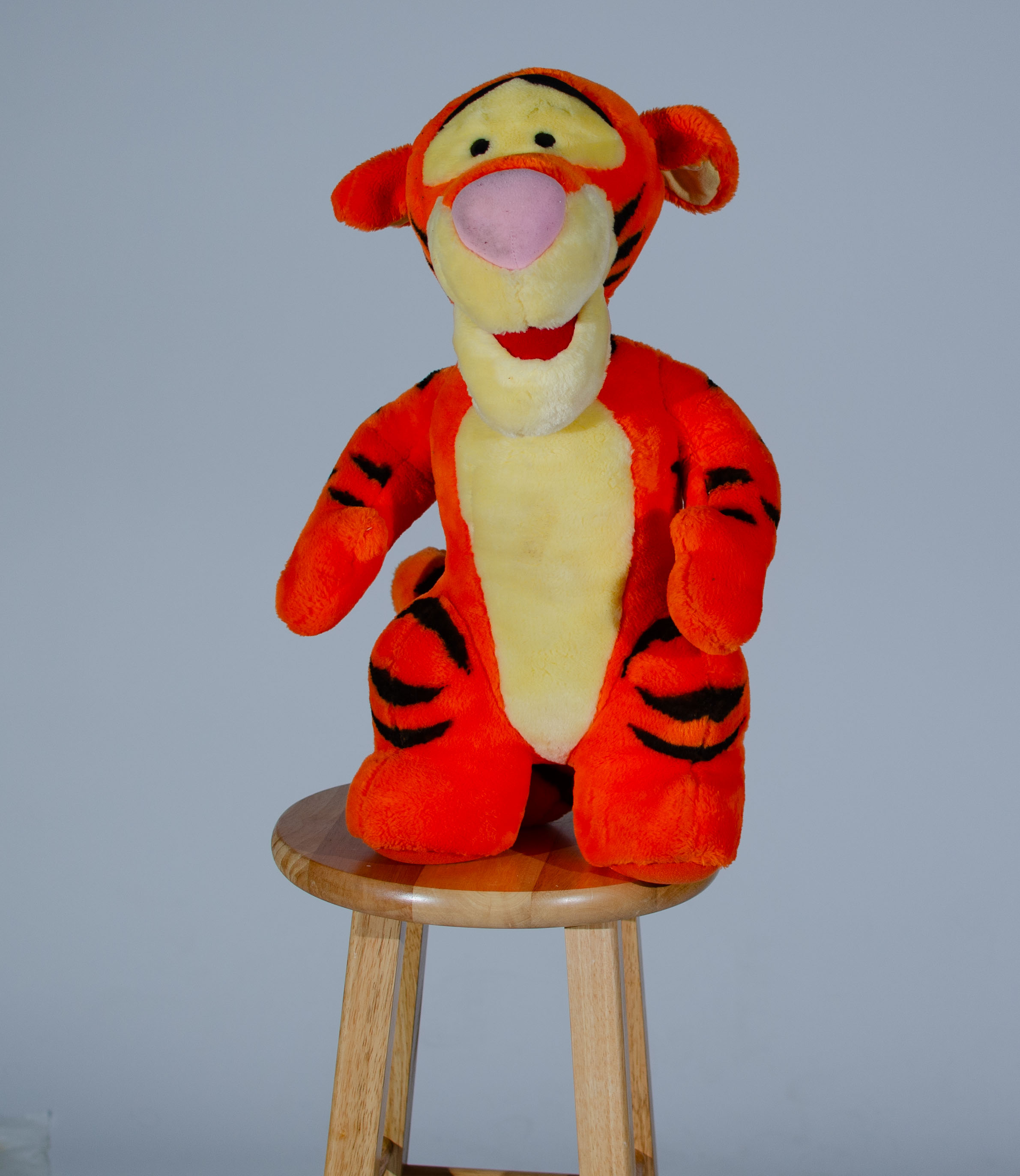

Yes, that got it, thanks. I was compensating for using a shorter 'model'. I moved everything to where it would be if shooting a real person with my strobes. Attached is 'Tiger' who came from a Salvation Army store and is still waiting to be washed. I also took a shot of the headband light I got for $5 at Walmart in a clip I use for holding reflectors.
