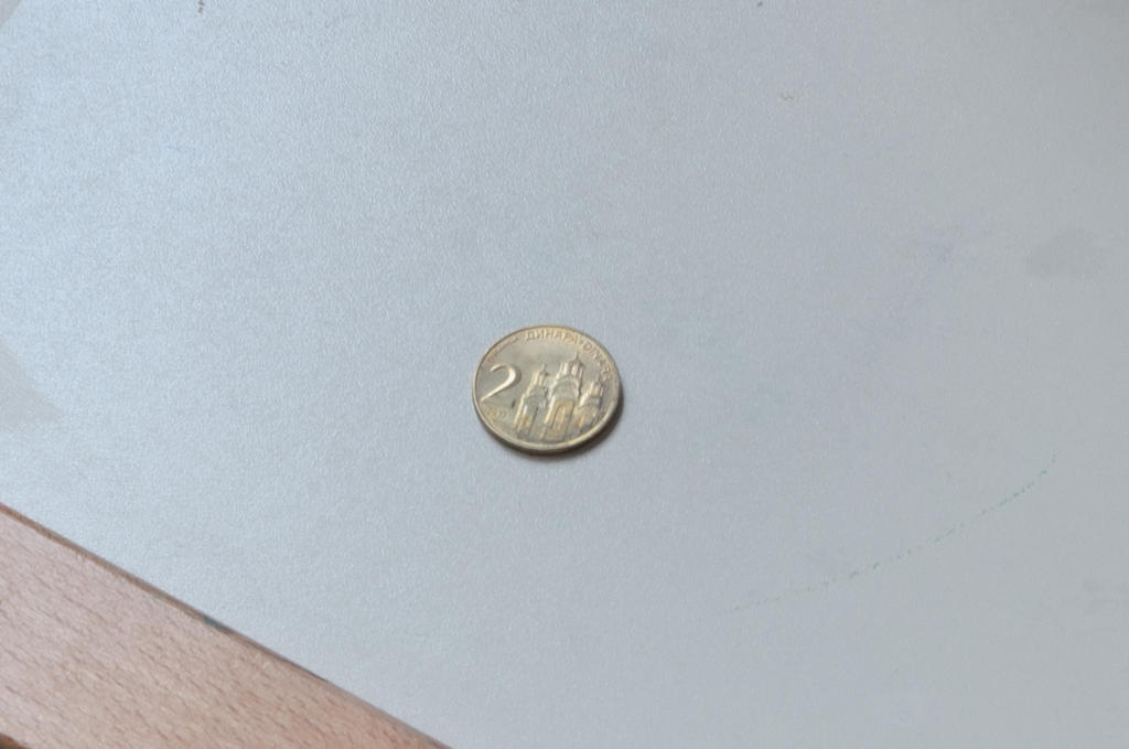

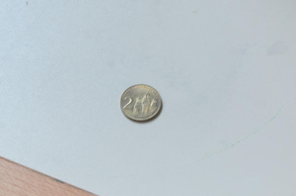

OK, here is the ZIP file with 3 folders:
18-105 Bad
18-105 Good
35mm
https://drive.google.com/file/d/0Bz565Iyy7PBXcDNkT2d1X2l6Sk0/edit?usp=sharing
This "Bad" folder contains 4 photos, two photos with, and two without polarizer, at 18mm and 50mm, all with f8. I named it "Bad" because I did not screwed the filter to the end, so it was loose. The folder named "Good" contains the same, but this time I screwed the filter to the end hard, so it was on it's place. The third folder is named "35mm", and it is made with 35mm f1.8 G with some cheap Baner polarizer, just two files "with", and "Without" filter.
I would like to hear your opinions, how much my cheap filters are affecting IQ.
What I notice in looking at the shots in both "Good" and "Bad" folders is that shots taken with your 35mm appear sharp, both with and without the filter attached. The rest of your images have what look like focus issues issues to me. Below are two shots, both taken at 18mm, and both appear out of focus to me. I don't mean "soft", I mean out of focus. I don't think this is a filter issue, I have to think this is a technique issue.

I see that 35mm looks sharper, but I also see that both lenses looks sharper with filter attached. They look sharper to my eyes, or maybe there is less light reflection, I do not know.
As for those two shots, each one is made with a tripod, f8 aperture, so the only thing that can cause this is maybe because I forgot to turn off VR.
I will make another two shots without VR.

I don't know what the issue could be but there's a very significant lack of sharpness there. Are you using Auto-focus or are you focusing manually? I would definitely make sure VR is turned off and maybe use a wireless release, or the self-timer to delay the shot a few seconds, in case you're vibrating things by pressing the shutter button. I say this because what I saw just doesn't look like a DOF issue to me; it looks more like front/back focus to my eye.

All photos are made with a tripod, camera set to self timer, auto-focus, f8 aperture, so there is no vibration, and I think there can not be so much back/front focus while using f8, or I am missing something.

Well looking at these I tend to agree with Horoscope Fish here.
The polariser shots look sharper because they have cut out the reflections, thus making them appear sharper, you'll need to get the last link in the chain checked out here which is your D7000 if you didn't already when you got your lenses calibrated, with the 18mm F8 shot, if nothing is in focus you could be looking at a misaligned sensor/mirror, it only takes a fraction to throw these things out, as you say at 18mm and F8 something should be sharp!
You used Auto focus, single point? Hopefully not group on the coin shots, basic I know but I have to ask to get a clear indication of what was going on, I don't think it's the filters but something else, if it's not the AF it's likely the mirror needs calibrated but it's a cart and horse thing, ones no good without the other, so to speak.
You need to eliminate the D7000 as the faulty element, can you borrow a body and try your lenses on that?
Pretend to be buying and shoot a card full on your lenses in a shop to compare maybe?
If your lenses are within spec and it seems they are, it has to be the body, leaving VR on rarely causes any severe problems on a tripod in my experience. I forget all the time and sell Landscapes two feet wide taken that way...

The body was checked few months a go, at the same time my lenses are calibrated. D7000 works perfectly with my 35mm f1.8 G now.
I made some more tests, and everything is OK, the problem with my beach photos can be camera shake as well. Polarizer lowered my shutter speed down so at 1/200 it is possible to shake the camera a little bit.
As for Polarizing filter, it is possible that I did not screwed it well, which turned out to be the problem while testing. After I screwed the filter very hard, and had trouble to take it off few months a go, I just turn one or two circles, so I can take it off easily.
Of course, VR can cause the same problems with exposures longer than one second, so it must be turned off to eliminate softness in ling exposures. That happened to my coin photos in "Bad" folder.
