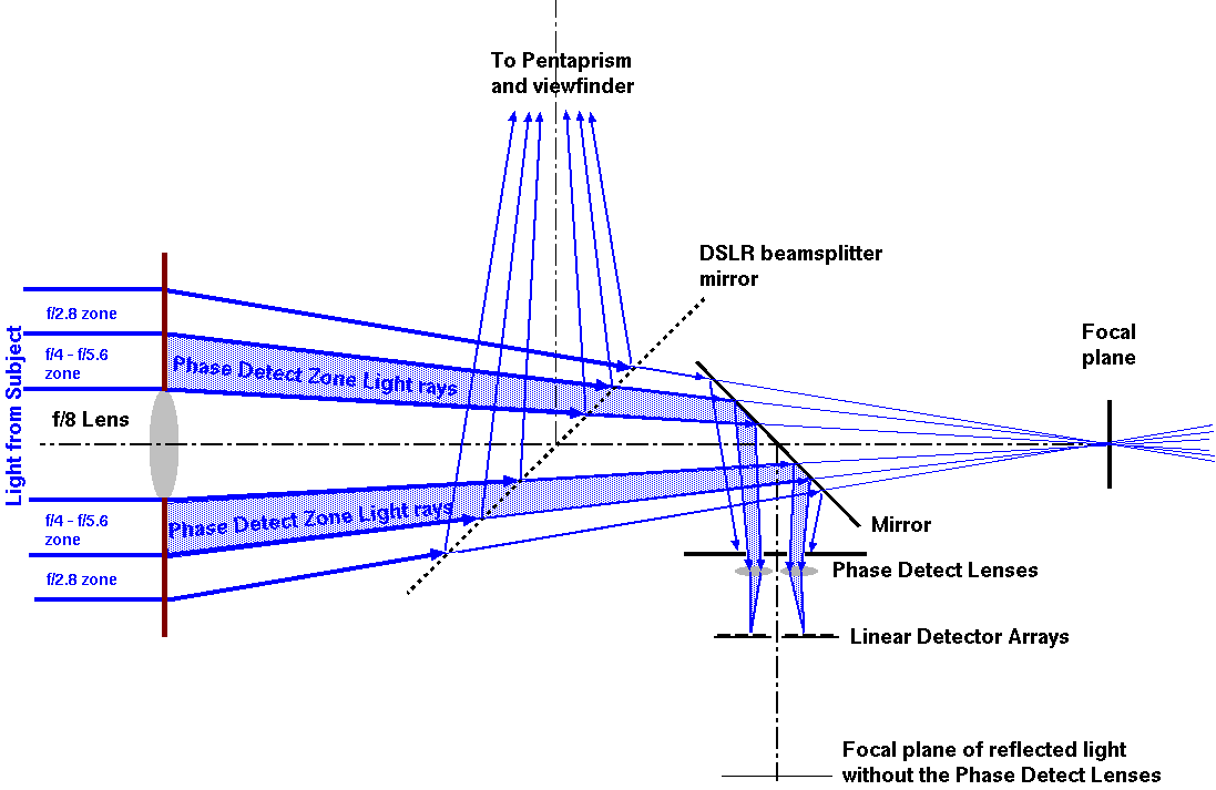

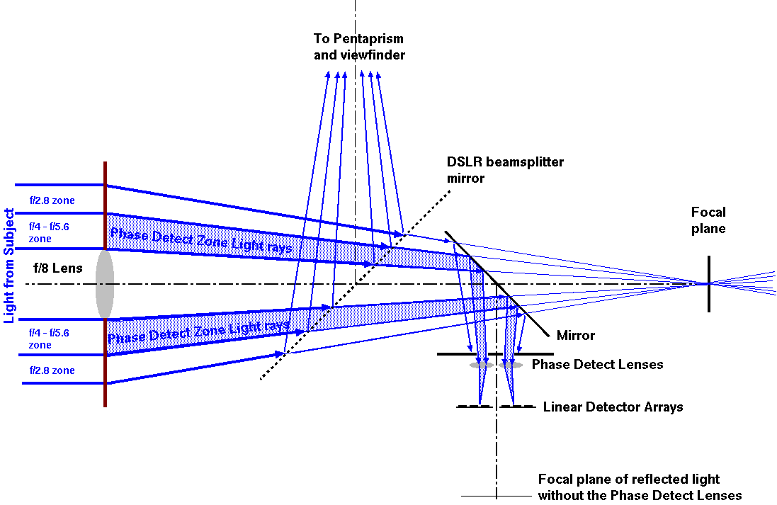

The cam always does AF the lens at the widest aperture but by putting a TC between, you extend the lens and in that affect the shape of the light hitting the sensor(AF). That results into something similar as shooting at a different effective aperture, all negative effects included. Most cams automatically adjust the minimum aperture when connecting the TC. Mine directly switches to f/8 for the TC2.0.
The speed of your AF depends on how wide the angle of light is. Which is why all fast lenses have massive front elements.
Here's an image representing what an f/8 lens does and how it affects focus. The same happens by extending the lens when using TCs.
Here's the rest of the article on AF:
Understanding Autofocus, Clarkvision.com

I believe that the key part of the article explaining the speed of AF has to do with the reduction of incoming light resulting from the use of the TC:
"One way to compensate is to integrate the signal longer on the AF sensor so that there will be enough signal-to-noise ratio for a decent signal to determine focus, thus slowing the system down."

It's the amount of light too but the angle seems to be most important when it comes to speed. Up to f/2.8 because anything faster than that does not translate in faster focus. Don't ask me why.

Try this: The angles are synonymous with a more divergent light beam, resulting in less light, and consequently longer AF integration time required.
Like that yeah. Thinking about it; the reason why faster than f/2.8 doesn't result in faster focus might have to do with the AF module being a certain size and the moment the diameter of the cone of light exceeds that certain size, it falls outside the module no longer playing any role in focus.

I agree, it appears form the article that the PDAF described is simply not designed to benefit from light angles beyond that of f/2.8.
It is also suggested that the speed of the PDAF does suffer when the light level is compromised requiring a longer time for light integration to secure a signal with low enough noise.
Similarly, a lens which can not produce f/2.8 light angles will reduce the light available to a PDAF system designed for f/2.8, possibly explaining the reduced PDAF speed and performance when using TCs.
I also conclude, however, that a lens with a TC and a certain effective aperture should produce an AF performance similar to any other lens with the same effective aperture, and possibly totally loosing the ability to autofocus a lens, or a lens+TC, with an effective aperture beyond f/8.
