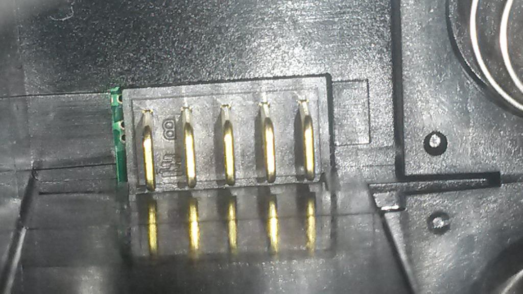

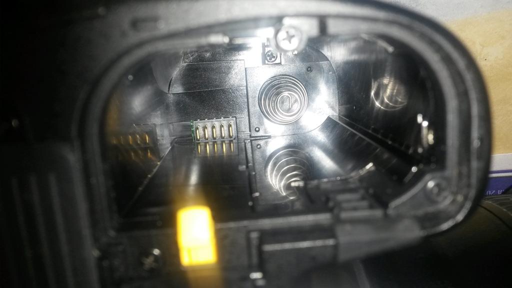

Here are the photos of battery container.
J-see, you remind me that I had a little "situation" which might affected on my problem:
During photosession on tripod, battery came to end so I tried to remove and put spare one. Head of the tripod didn't allow me to take the battery although I tried just a little harder. When I realized that it won't work like that I separated camera from tripod and finished battery replacement.
As you can see from the pictures, contacts are solid and they are not damaged but still there is little suspicion that contacts inside electric circuit board are damaged although I didn't use big force :)

J-see
If the problem started after that tripod issue, it might be more than a coincidence. It's all just speculation but usually nothing breaks without a cause. The contacts look fine although the first looks slightly different but it could be the angle of the shot or simply a biased idea because I know there's a problem but when I enlarge it in PS, it doesn't seem to be aligned identical.
I don't know how the other side looks but they usually try to stuff as much as they can in as little room as possible; one millimeter might make the one touch the other but again, it's just speculation. If there is a short-circuit it isn't at this side but the fact it heats up seems way more problematic than the battery draining.
